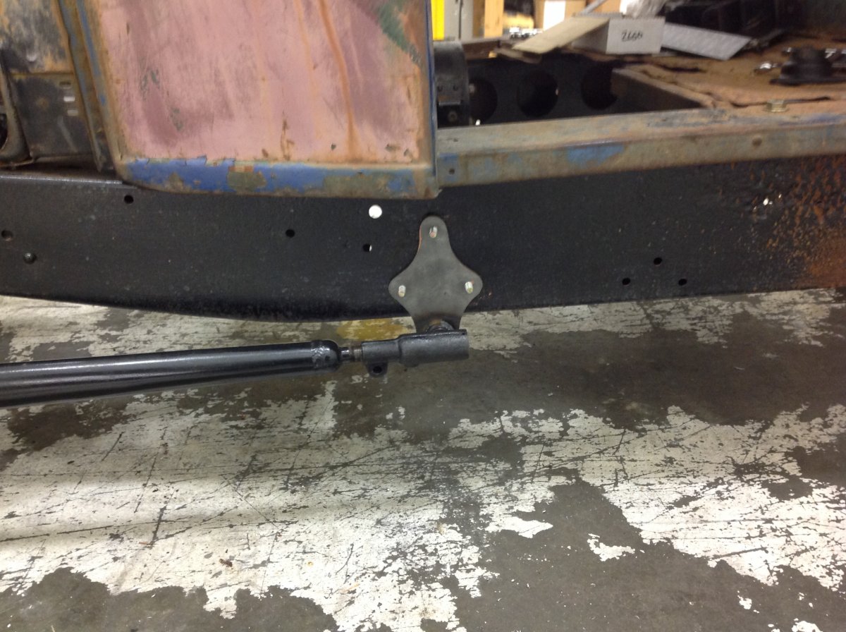

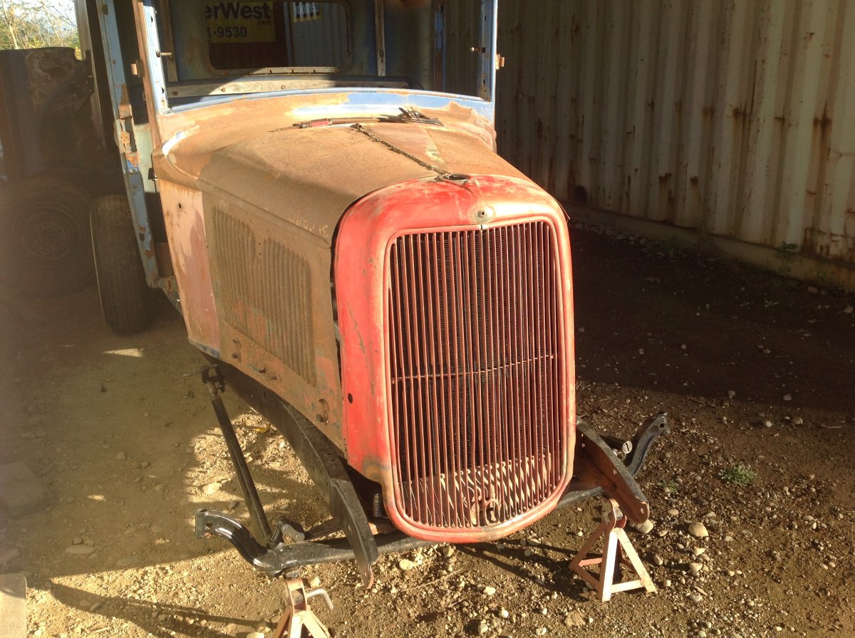

    E brake bracket fabbed
    brEad and tb33anda3rd like this.

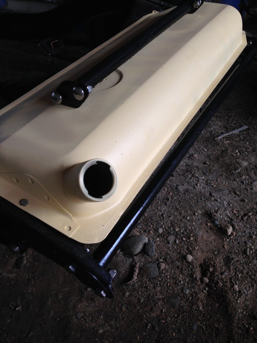

    Wish bone brackets finished and bolted on. They will be welded along the bottom edge of the frame and a small weld around the top, to avoid welding across the rails. I wanted them to sort of a bridge girder shape to break up the big slab sides of the 34 frame. The exposed bolt threads will be topped off with stainless acorn nuts, functioning as jam nuts. The brackets are threaded and bolted through from the back. image.jpeg

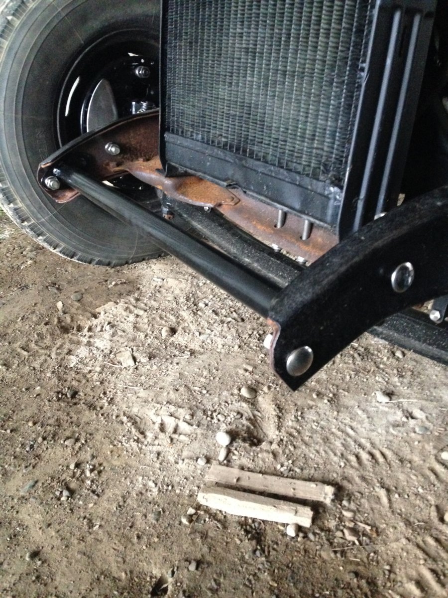

    image.jpeg Spreader bars done today. Trimmed and polished hex head bolts for the rear and stainless capped swap meet bumper bolts for the front. Just need to make nerd bar brackets and bolt them on.

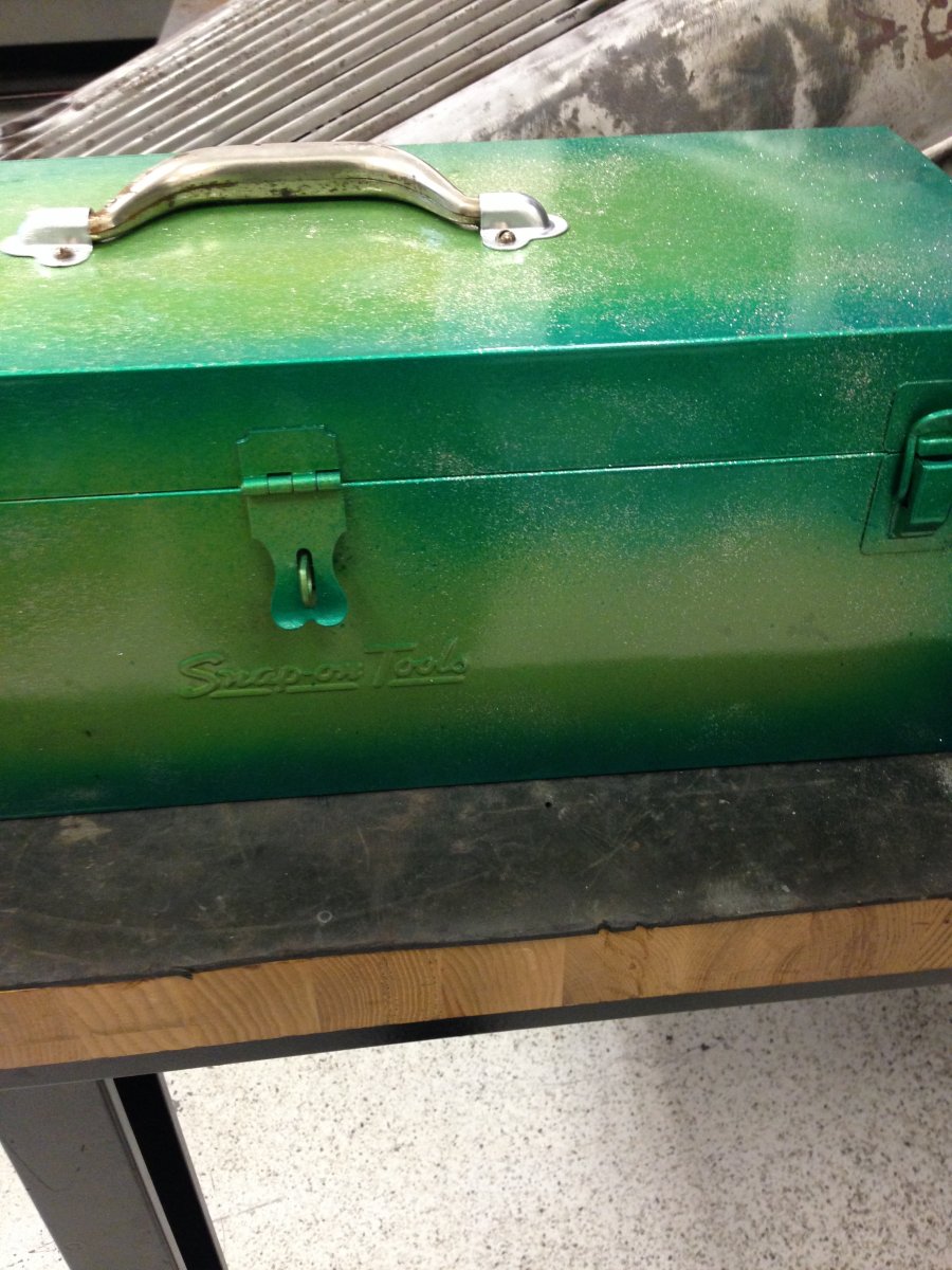

    And finished off another goofy project. Frozen spray bombs dollar store glitter and "****!" **** flake glitter snap on tool box. Pictures don't do it's truly horribleness justice.
    But for twenty dollars at a garage sale who cares? It was full of tools too!

    In Cold weather, I Heat up the paint, take object outdoors, shoot on paint, bring object indoors to dry....all Snap On inside the box?
  27. dumprat
    Joined: Dec 27, 2006
    Posts: 3,573
    dumprat
    from b.c.
    Not all snap in the box, but a bunch of sockets were.
    The spray cans were frozen from sitting in my shed. I forgot to get them until it was almost too late. But they dried out ok so it will stick.
