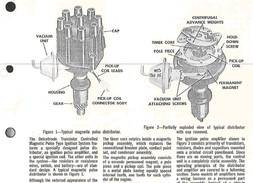

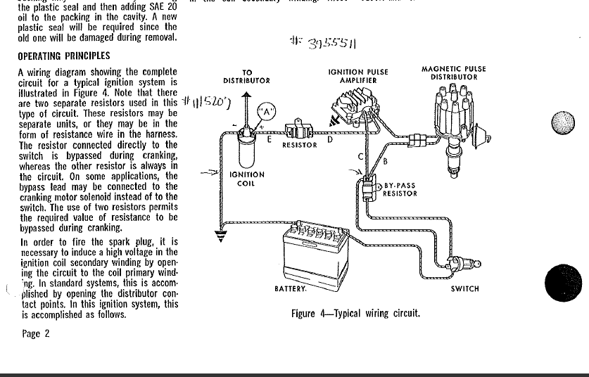

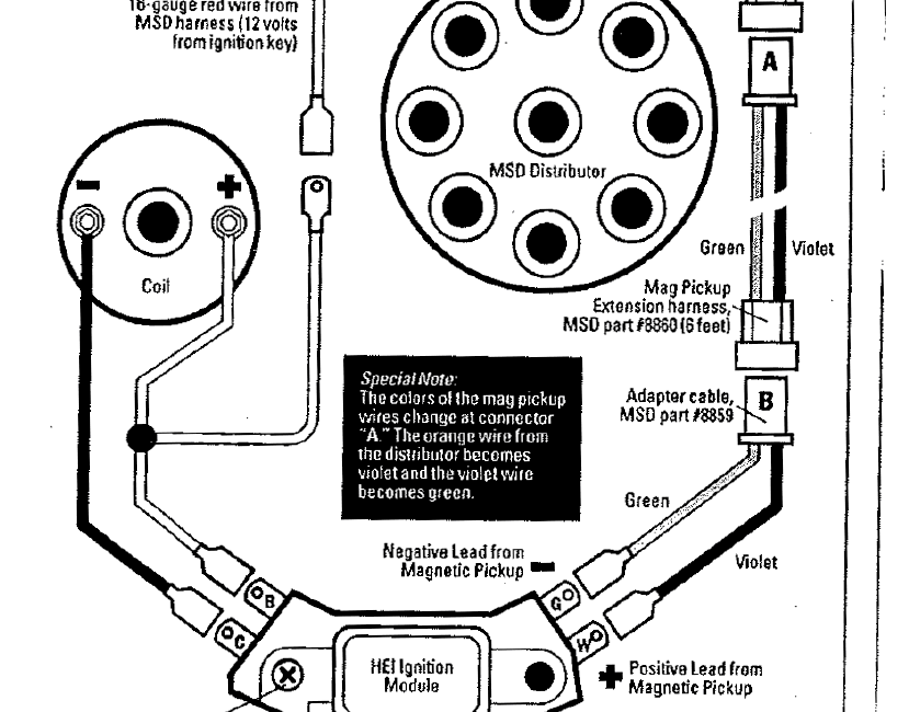

  11. the first generation hei distributors ( in corvettes)
    had the magnetic pick-ups....
    see pics:
