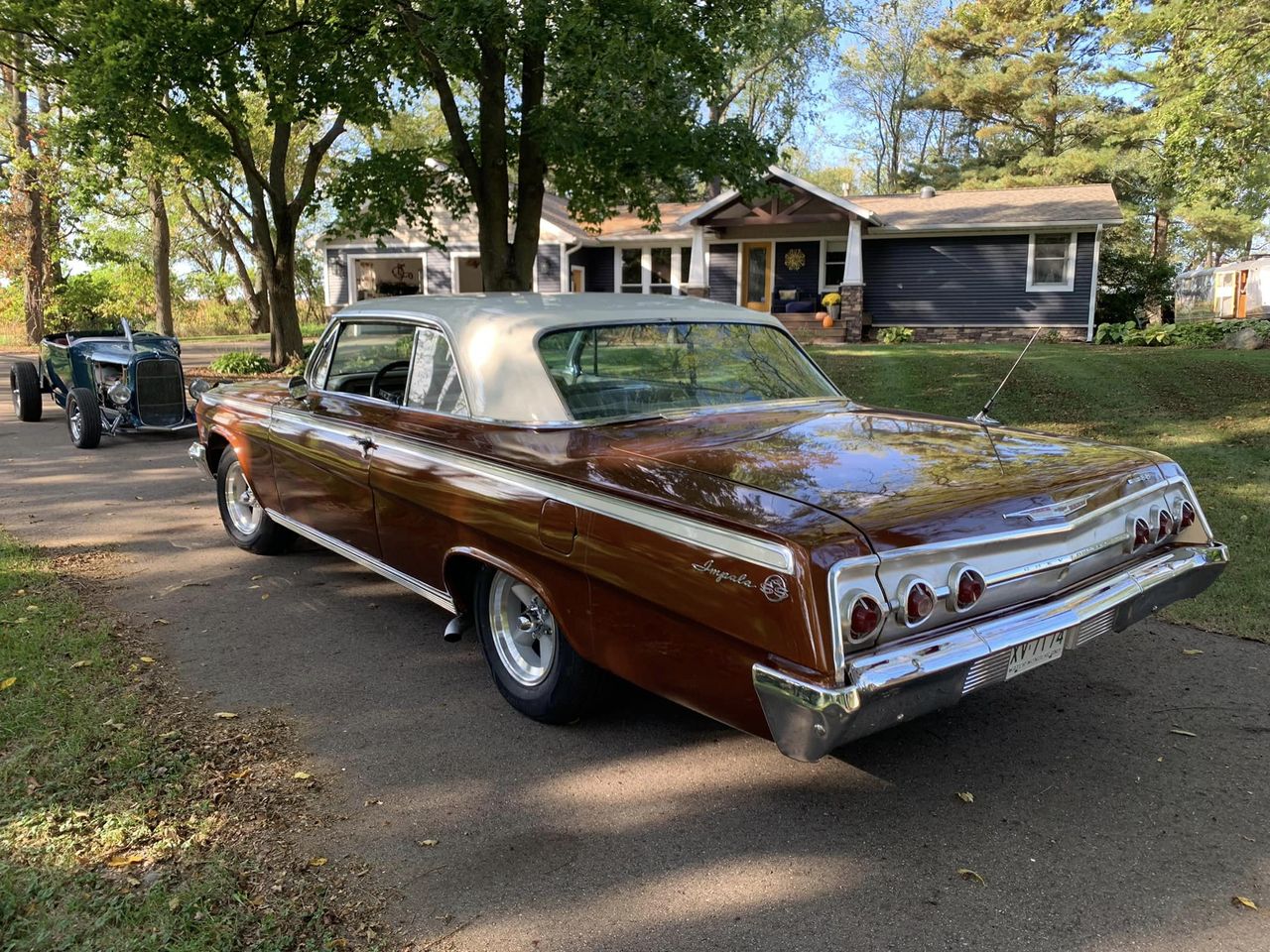

    I don't understand not wanting it to look as good as you can make it. If the goal is to have not look "nice", then leave it as-is. A ****py tractor enamel or Rust-O-Leum paint job is going to look worse than not doing anything, and will make any effort later on to make it look "good" very difficult indeed. Mitchell Rish's Anglia (above) is great example of the kind of results you can get with inexpensive "Kirker" paints and some effort. My '62 is a driver quality car, I spent about $500 for all the materials to paint it with acrylic urethane single stage. I'd have used Kirker, much less expensive but I wanted to keep it the ginger brown color it was.
    Try to do the best you can, if it's not perfect that's OK, just don't try to do a poor job. B5CB6554-F71A-44A6-8E58-6D360CD46C7C.jpeg
