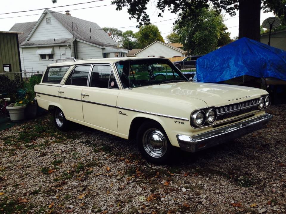

    Rolled-on Rustoleum about twenty years ago..... I would argue better than not doing anything at all

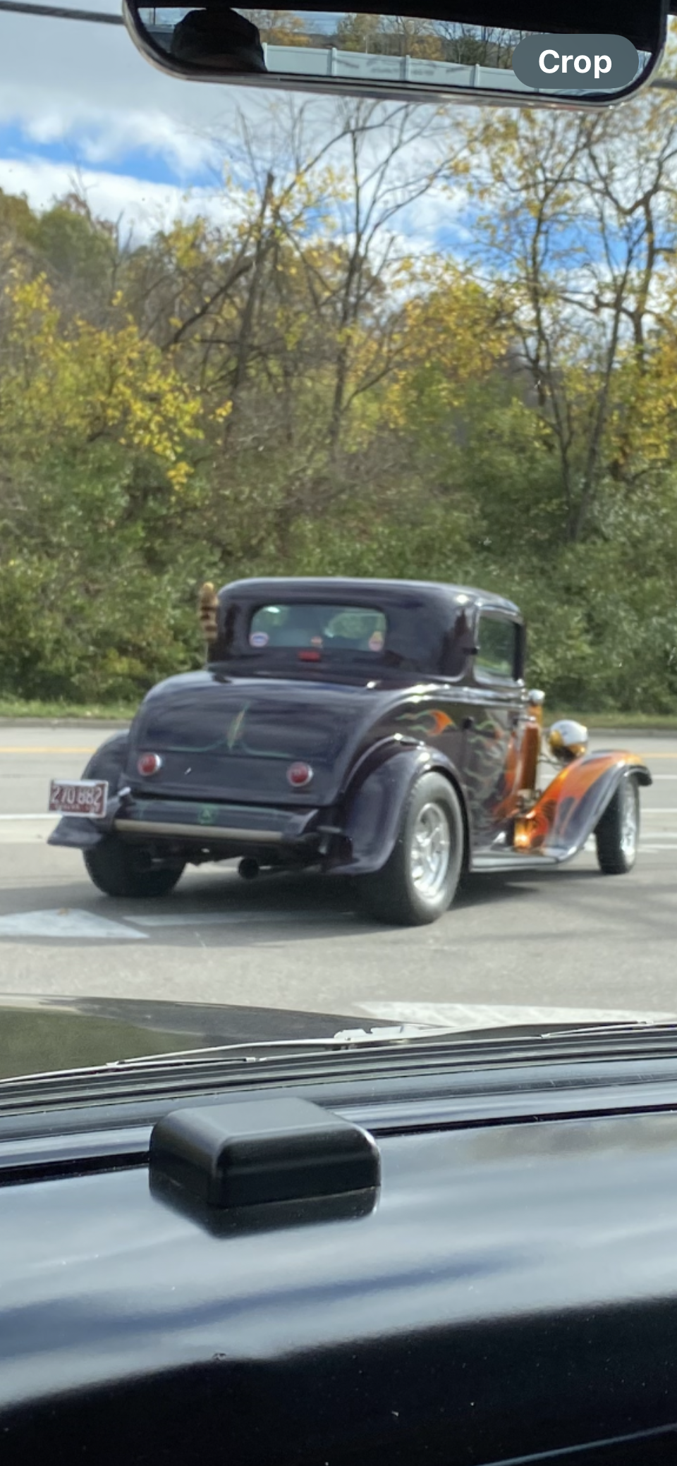

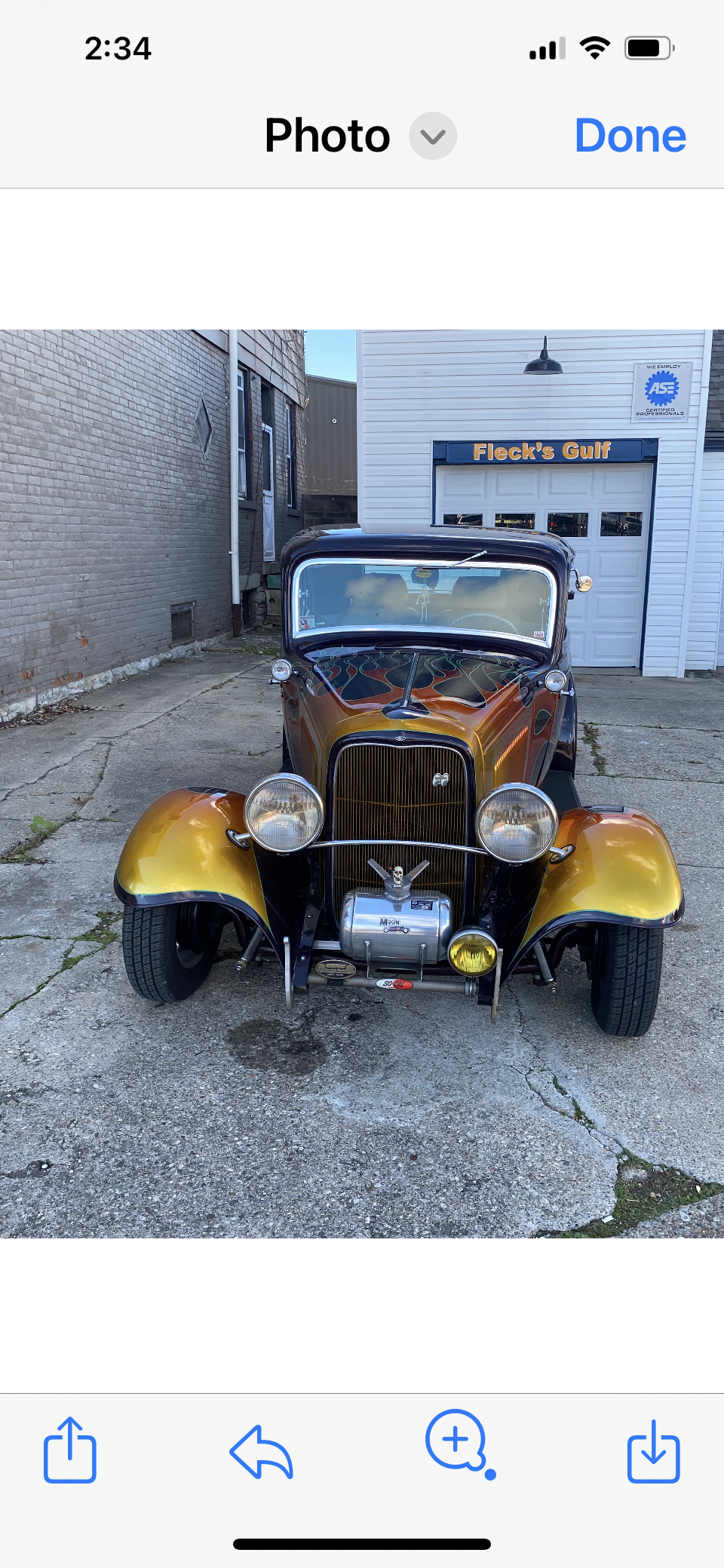

    IMG_1845.png B IMG_1844.png outside in the driveway paint , good or bad I did it myself
