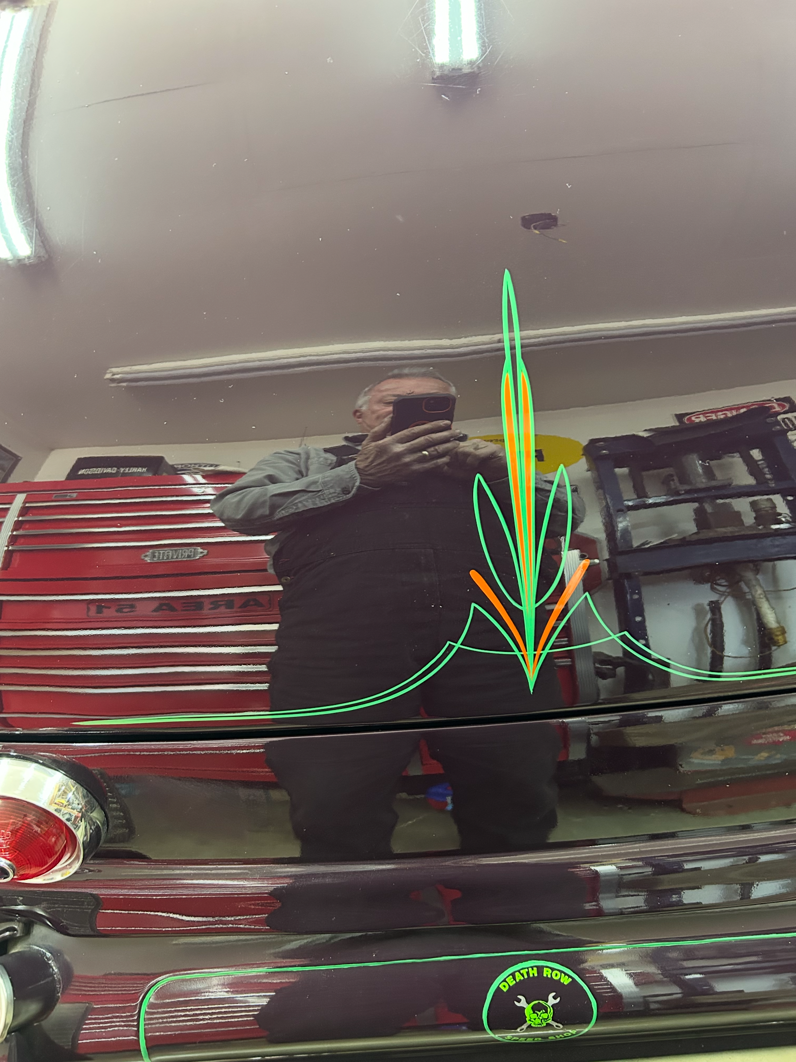

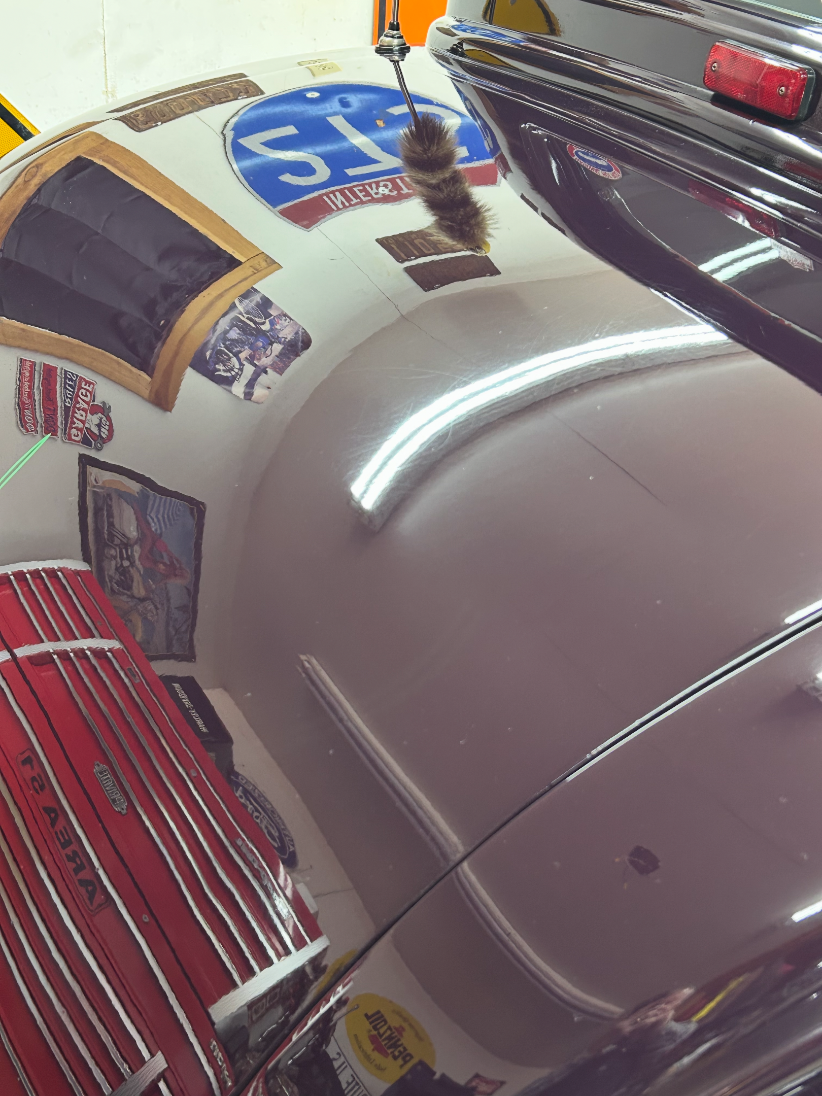

    Couple of views of 31 year old in the driveway paint job . IMG_0921.png IMG_0922.png

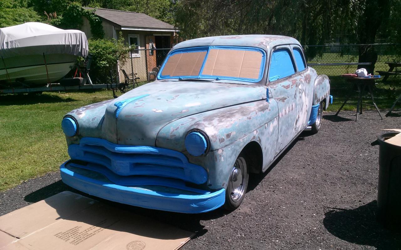

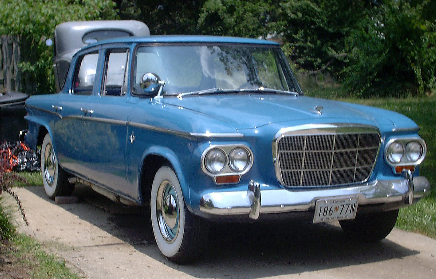

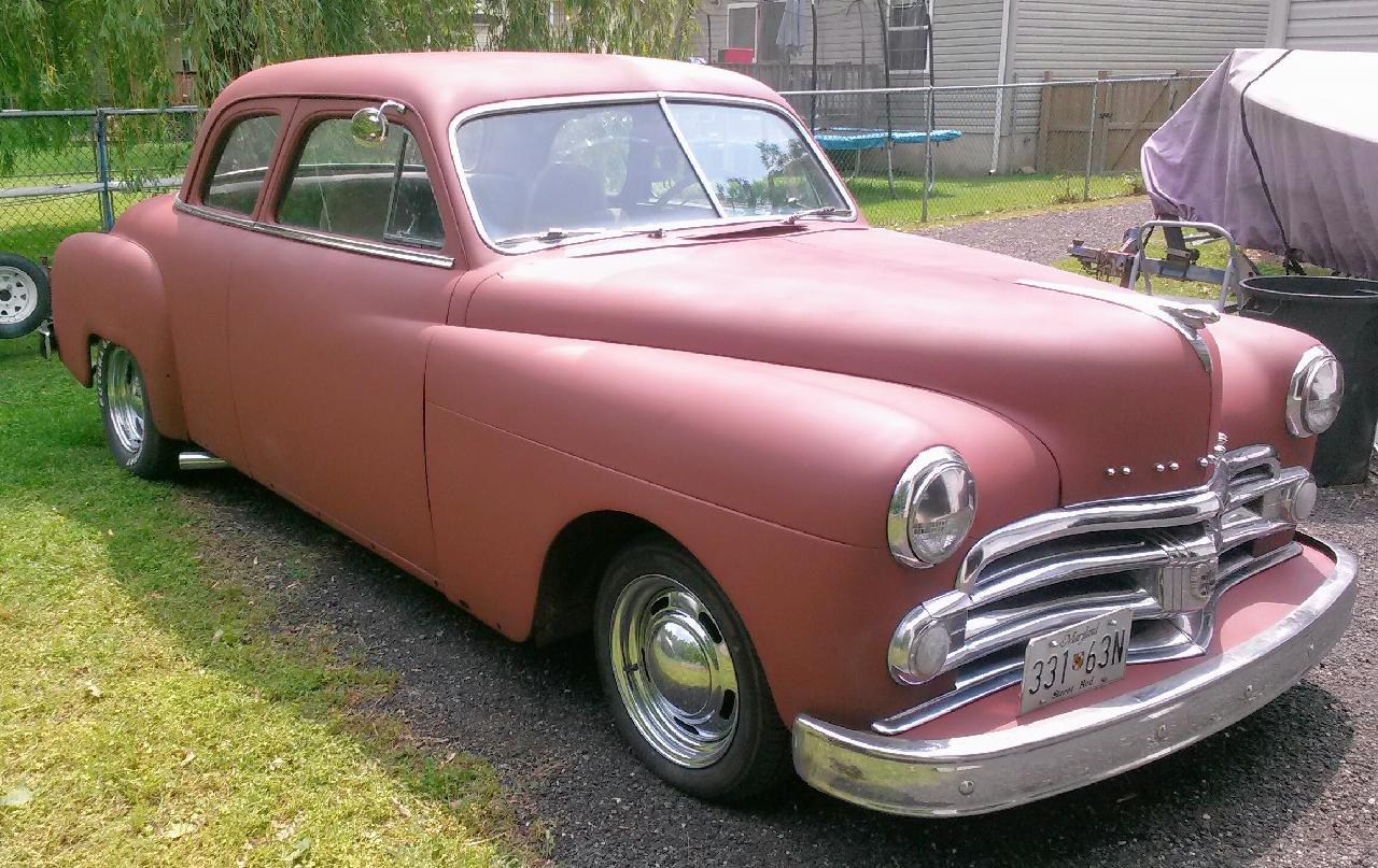

    I’ve painted a few in my driveway with prep, then Rustoleum gloss. They weren’t “show cars”, but looked pretty good for drivers… D9B0FE98-E13A-40BE-A821-0233B5B59959.jpeg 2B20D257-6067-4C53-AE73-7B027D97A08B.jpeg 22DC5117-1876-4A9B-B937-B038B4C03A41.jpeg

    F-ONE
    from Alabama
    That’s Amazing!
    I never knew ruddy red primer makes a 4 dr Lark look like a ‘50 Dodge Tudor.
    You got skills.

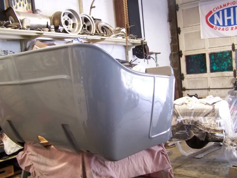

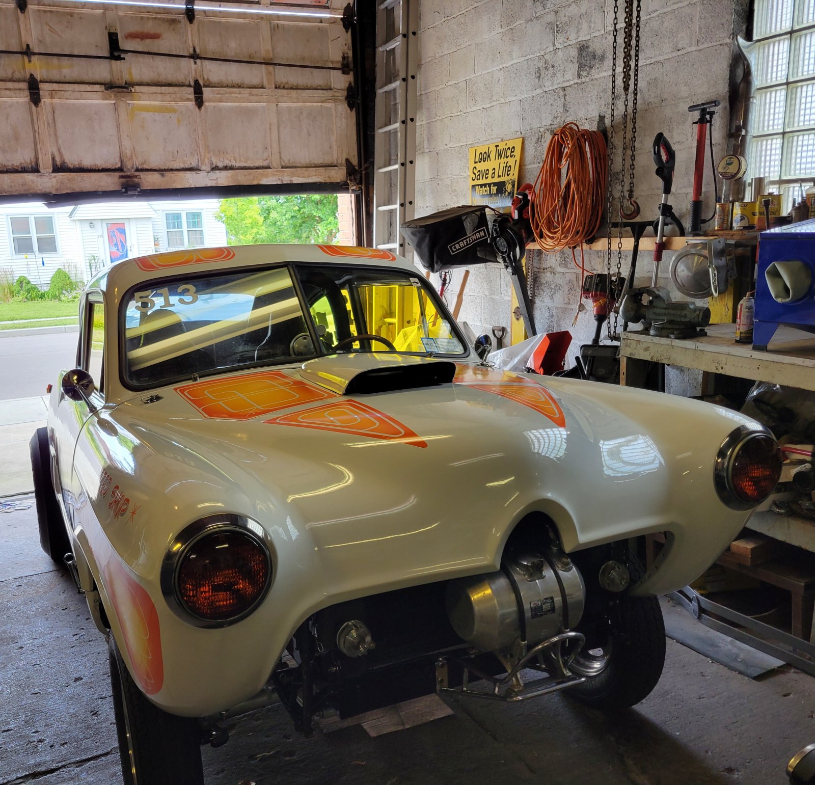

    I think everyone knows I did these two with Rustoleum and a roller, they're not going to win any best paint awards but for how I use my cars they look fine to me. Probably $50 bucks total on the t-bucket and $240 on the Henry J, most of that was in tape and sandpaper.

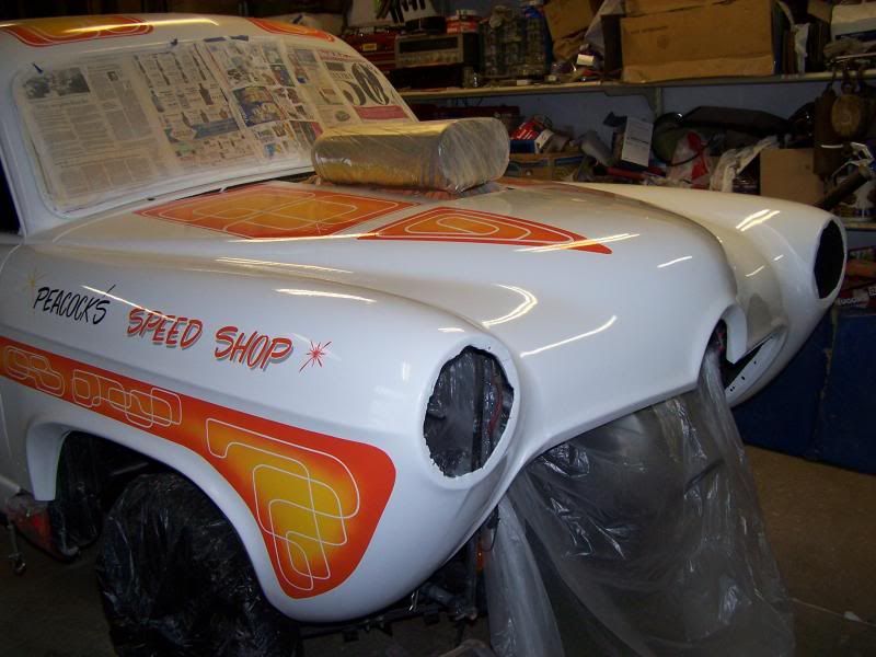

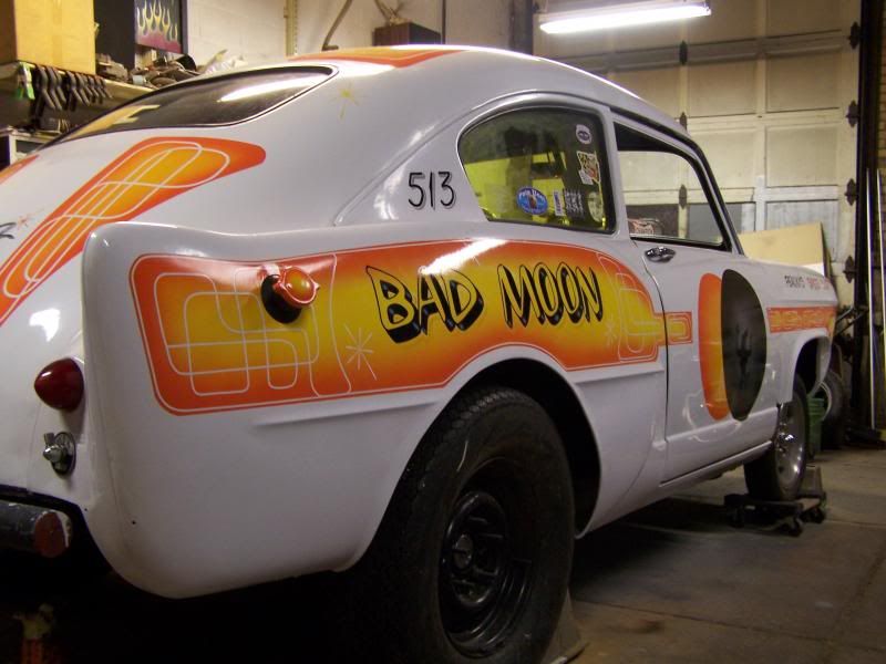

    I did use rattle cans on the orange/yellow

    Care to share your roller and brush technique?
    Looks good! (Both)

    I just followed the original Moparts forum thread that got the whole $50 dollar paint job thing started. I did the t-bucket 19 years ago and that thread was only a few months old at the time I believe.
    https://board.moparts.org/ubbthreads/ubbthreads.php/topics/21490.html
    I did just roll a couple coats on this fender but I'm not going crazy on the bodywork or sanding on this project, more concerned with stopping rust at this point. This was right after I set the roller down, it does flow out during the drying, so not as orange peely as that photo shows.

    you must have had gene teaching you the rattle can--killer!

    This single stage Urethane sanded and buffed 31 years ago . It has many years of rubbing / polishing on it . It was done outside in my driveway in a subdivision . The lines were Mr . Montana’s work . Follow the directions , and kids can apply single stage , with very good results . It is the same as most all other supplies today , EXPENSIVE x 10 . Last summer I repainted one of the tractors in single stage urethane red , it cost me near $400.00 in product only . I used no where near what it takes to paint a car or pickup body .
