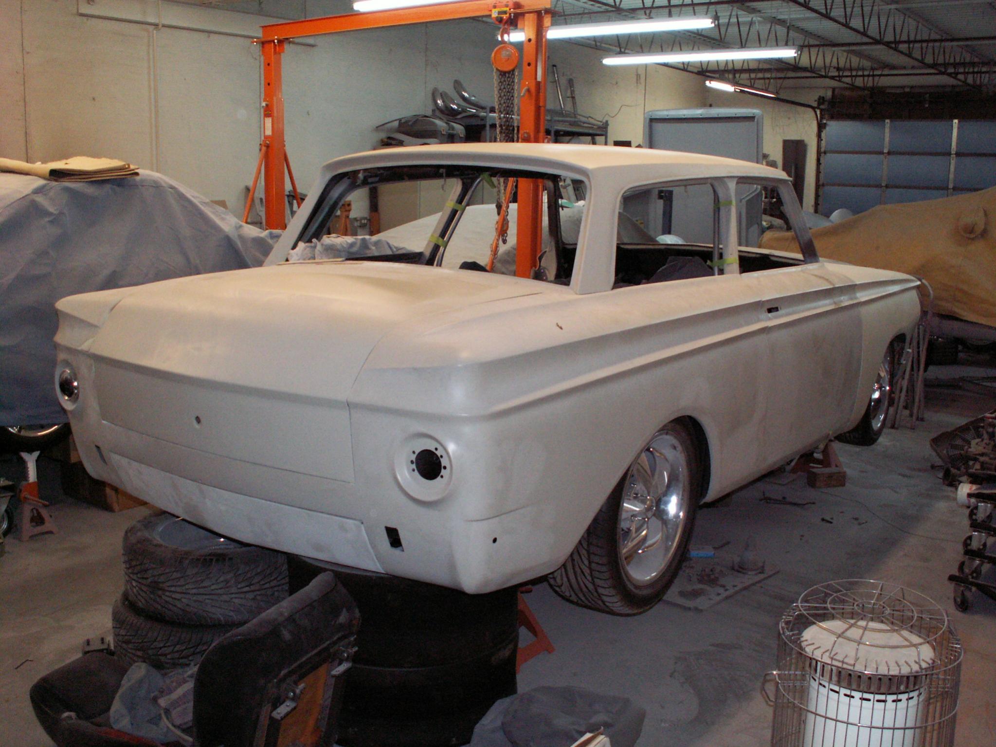

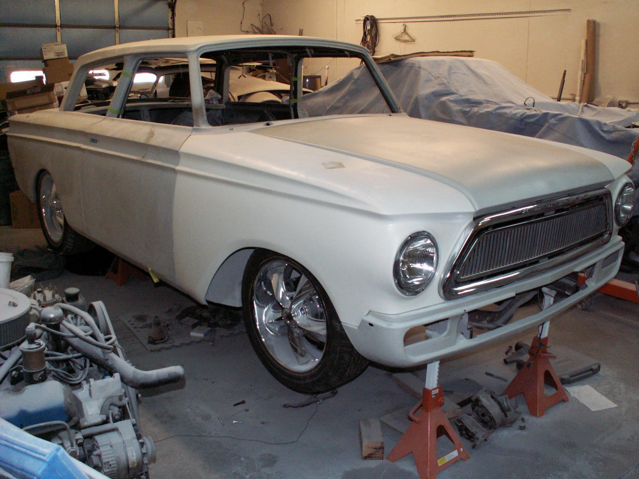

    I've got two of these the second will be a g***er, it was supposed to be a parts car, but can't bare to crush it. The only problem with going g***er that I've seen is front spring mounts and engine bay size, causing the calculator to speed up. Pictures are of the first one.

    Laun, if you're going g***er you'll be using leaf springs, not the original mounts. What I'd do in that case is cut the original suspension mounts off in the bottom flush with the "frame" rails. The rails will support leaf springs well enough. You could leave the upper sheet metal (inner fenders), but as you noted, it gets in the way of a big engine. I think I posted some pics of a SBC in one of these earlier in this thread, maybe it was another. If you can't find it I'll post again, or send me a PM and I'll e-mail you a PDF of the article on the car. The inner fenders and front suspension were left alone, but a big section above the rail between the firewall and spring towers was cut out to allow Chevy II "over the rail" headers to be installed. A little extra bracing was added in the engine compartment, and there was a full roll cage inside; car was also back halved for a narrowed Ford 9". You could cut the inner fenders away with leaf springs, or just the spring towers. I'd cut the fenders away, leaving about a 3/4" flange on the top of the rail. Then brace it up with tubing tied into a roll cage. To complete the g***er look either make a tilt or lift off front end.

    We were thinking straight axle with a 4 bar and coil overs, so it might have some sort of a decent ride. I can only guaranty one thing, we will get stupid with the dollars.
