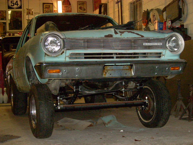

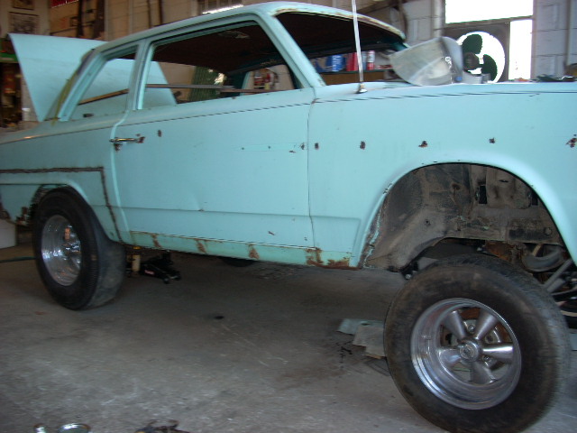

    A buddy of mine is building a 64' American for me. I've done a lot of the work but now the hard part has come and I work about 75 hours a week so he has took over the hard part.
    I will post some pictures as soon as I figure out how to do it ?
    Not the same model as your's....but still a Bad lookin' Rambler.

  7. Tricky Hickey
    Joined: Nov 20, 2009
    Posts: 113
    Tricky Hickey
    Cheap...(not any-more) :eek:

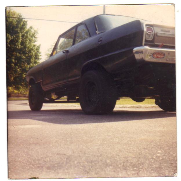

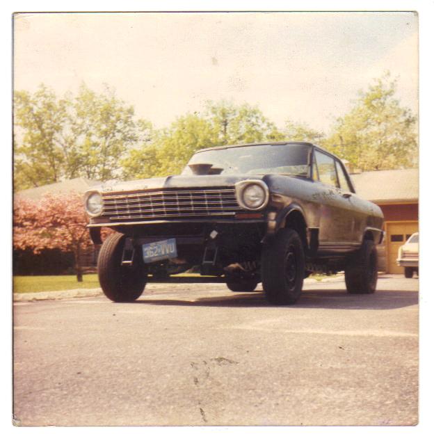

    This was a cheap g***er in 1978 when i put a axel under it.

  20. treeserv
    Joined: Nov 2, 2009
    Posts: 242
    treeserv
    from n.j.
    This is what my car looked like in 1978.cheap!

  22. Tricky Hickey
    Posts: 113
    Tricky Hickey
    Well...It started out cheap.
