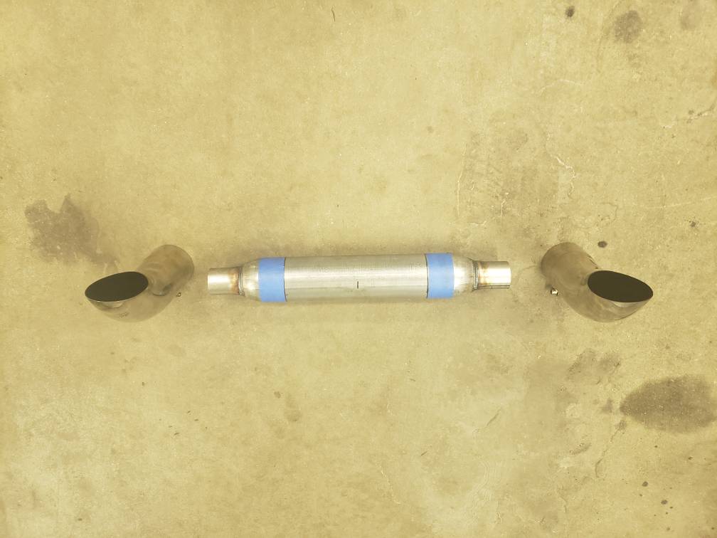

    This is what I did, but I flipped the ends. I also used larger baffle insterts and double wrapped gl*** so it was jammed up between ths baffle and the header wall. I secured the gl*** using steel bands evey 1". They sound nice and deep. And, the gl*** is holding up.
    A summit glaspack cut in half
    Invert the end and weld
    double wrap the gl*** and steel band
    Insert
    Bolts are facing in when mounted... not visable unless you are reall looking for them
    Mounted i flush with the opening with a good seal
    Mounted on my 1930 Durant

    Using the larger diameter baffle allows you to bottom out in the cone. This, the banding, and the flared end keeps the gl*** from blowing out.

    I built my lake headers with 3" end and have an adapter plate for my turnout. I welded on the inside of the turnout a 2" tube 7" long with a solid cap on the end and about 15 holes in the sides. When I bolt the turnout on the end the 7" tube gos up inside the pipe. If I want the baffles removed, I just remove the turnouts.
    Just another Idea...

    I liked this idea so much I have made 3 sets for my father,son and myself. The new set I made today. 20200209_140745.jpeg 20200209_141034.jpeg 20200209_145952.jpeg
