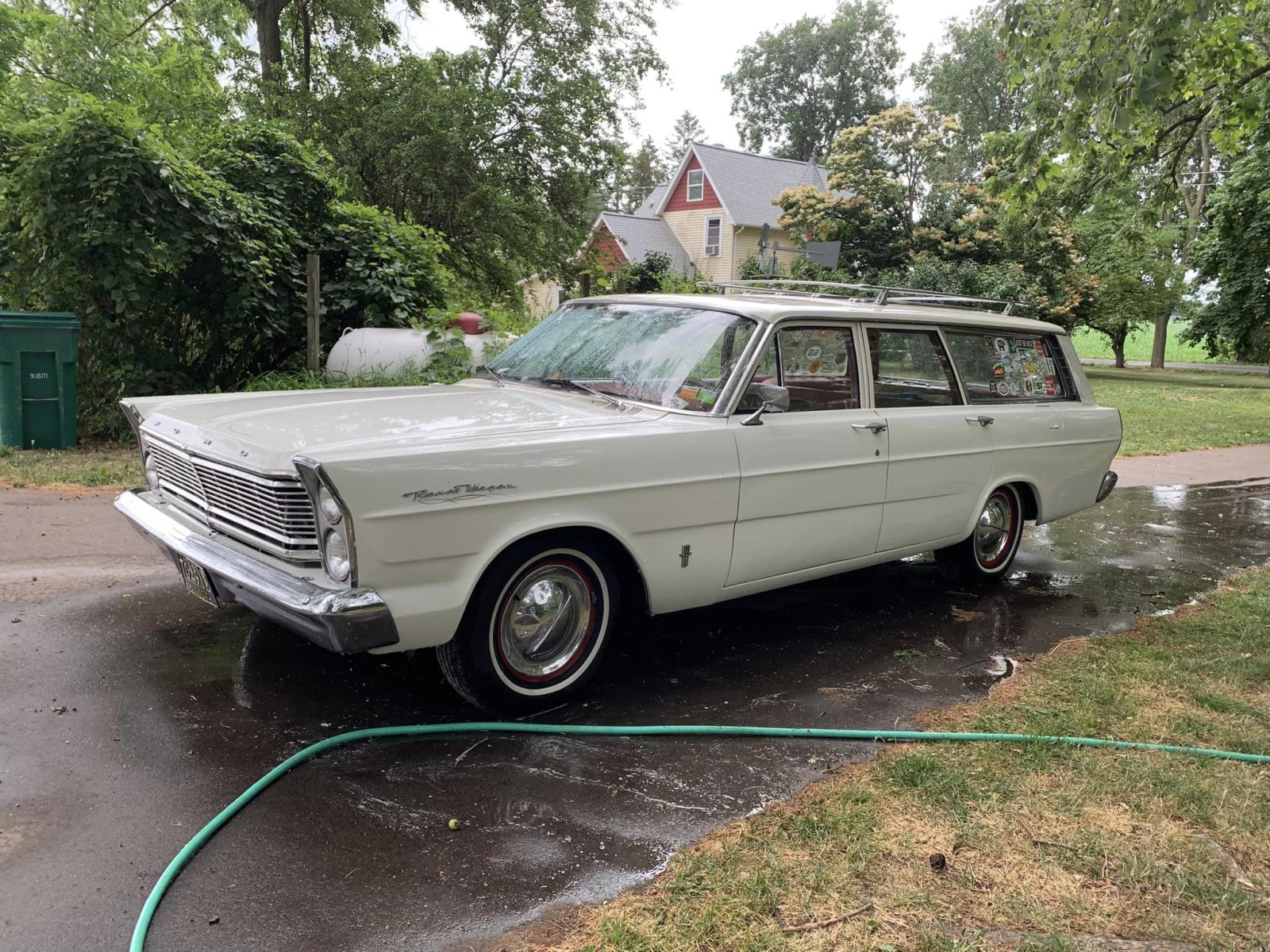

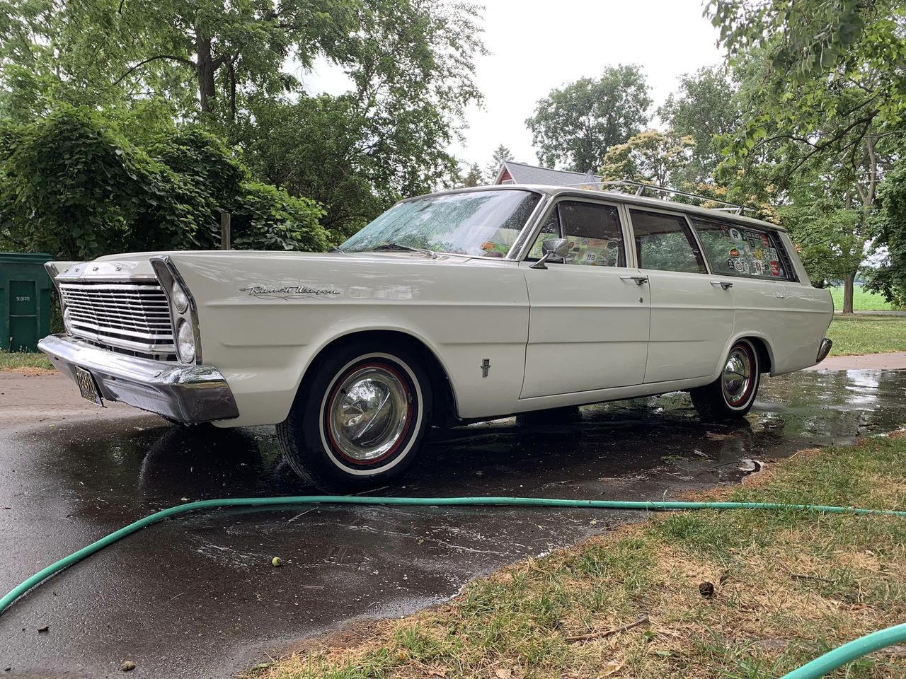

    I know this has maybe been beaten to death here, but lots of people can't spend $2K on materials or $10K for a complete paint job. I just finished up, on an off topic vehicle (so I won't post any photos) a VERY inexpensive paint job that turned out remarkably well. I have finished up a pretty extensive repair to our son's '65 Ford Ranch Wagon, and used Kirker paints. This stuff is, in the color I used, "Wimbledon White", less than $80 for a gallon of sprayable material in single stage urethane. It's only sold in three quart, unreduced, form, so I had roughly half a gallon of unreduced paint left over.
    I used about a quart of that, a little bit of "Arctic Blast Pearl" from Kirker left over from our DeSoto wagon, and a quart of "Magic" implement paint from Tractor supply in M***ey Fergeson Red for the other color. (It's two tone, red and pearl white) To the tractor supply enamel I used the corresponding catalyst and their reducer.
    The results were, even to me, astonishing. I like Kirker paints, and have used them on several projects, so I was expecting that to be acceptable, but the Tractor Supply stuff, with the catalyst, laid down like gl***, and gives a finish that for this project, is certainly worth the $50 I spent for the material.
    I use a $100 HF gun, and whileI have a decent 5 HP compressor, a good water separator and regulator, I think a yard sale small compressor and cheap regulator could get a person set up do a pretty good result for less than $500 worth of equipment.
    I like to paint, it's a skill I think all "car guys" should have. It certainly can be done at home, even in the driveway under a temporary shelter, with satisfying results.
    I will share a photo of the wagon, which I repaired some minor collision damage, painted the left side from the character line down, blending the paint over the front wheel, with the Kirker paint. Including the gallon of 2K primer, reducers, color (with 2/3 left over) materials for the job was less than $300.
    (Edit: Whoops! Forgot the photos of the wagon)
    (Edit) I'm talking here about a professional looking job, one that you can be proud of, not just mopping on whatever free stuff you can find in the returned house paint section at Lowes...
