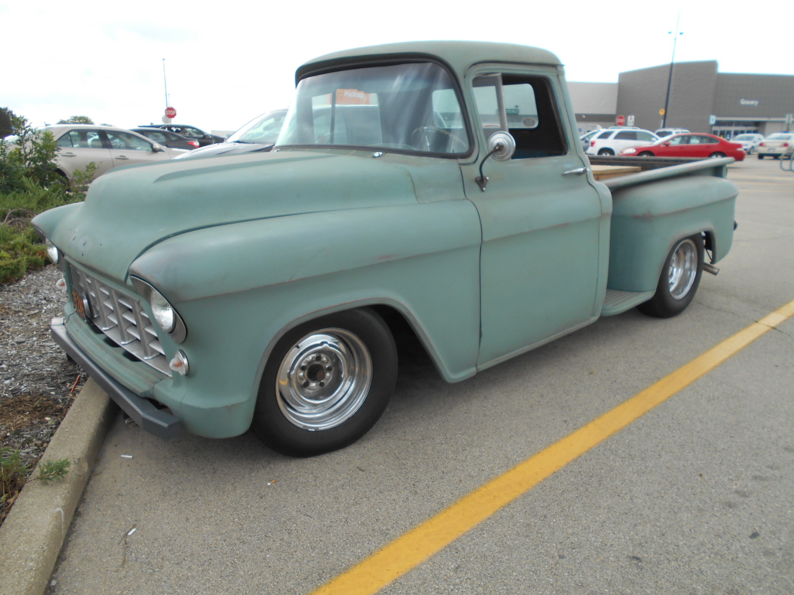

    ...my 55 was several colors, did not look good;,...I brush painted it in a couple days , had $11.00 total in materials,
    including a $3.00 brush,...looks good to me.

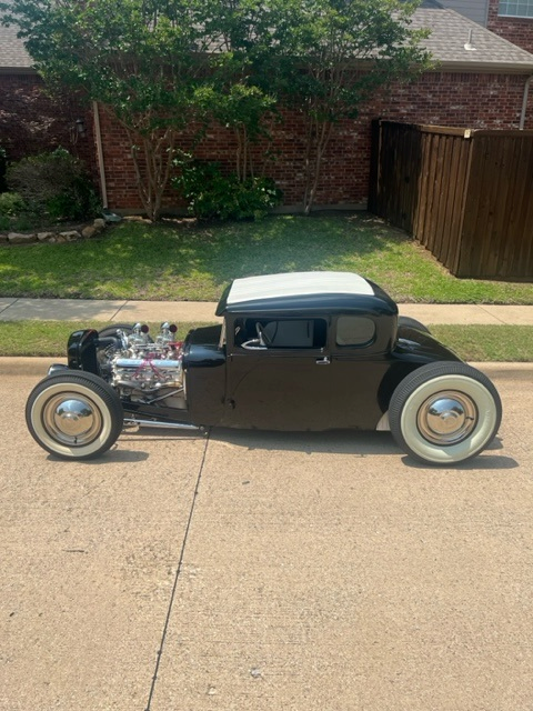

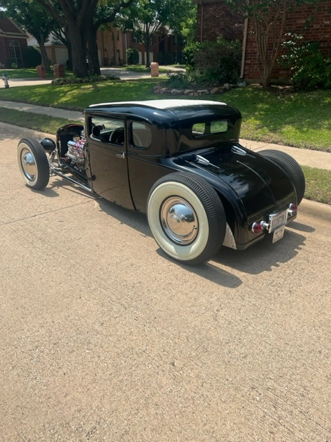

    I don't have a picture of my coupe when it was 1st painted with the Farm & fleet Anti-rust enamel (alkyd), but I do have a couple pictures of it when the paint was about 4 years old. The white paint held up pretty good, but it may have been painted more recently then the blue was. The blue was brush painted on about spring of 2013. Both pictures were taken late in 2017. The car got some work, and was painted red and white in the spring of 2018 and was sprayed with Acrylic Enamel. I have pictures of it before the wheels or number was added. An then I have a picture of it taken a couple month ago.
    The car does not live a pampered life. Pic 1 shows is winter storage location.
    Pic 2 & 3 are the blue and white in 2017.
    Pic 4 is just after the red & white, notice it still has the blue wheels.
    Pic 5 was taken a couple months ago. The red has a couple spots that are starting to show their age a bit, but this paint is nearly 2x older then the blue and white was. The blue and white was around $50 total paint materials (included the cheap brush). The red and white total paint material cost was around $250. 100_0508.JPG P1010121.JPG P1010118.JPG P1010193.JPG 100_0862.JPG
