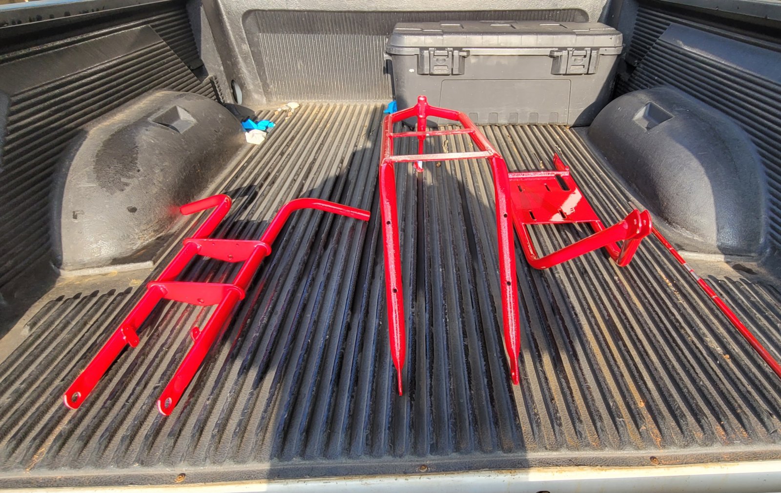

    How cheap are you looking for? $8?
    We dispose of at least a gallon of mixed paint a day. Should I save the s****s and paint my car with free paint?
    I painted a 50 year old mini bike with said ""free" paint last week so my boss could mock it up. It will return to the paint shop next week to repair the scars from this mock up.

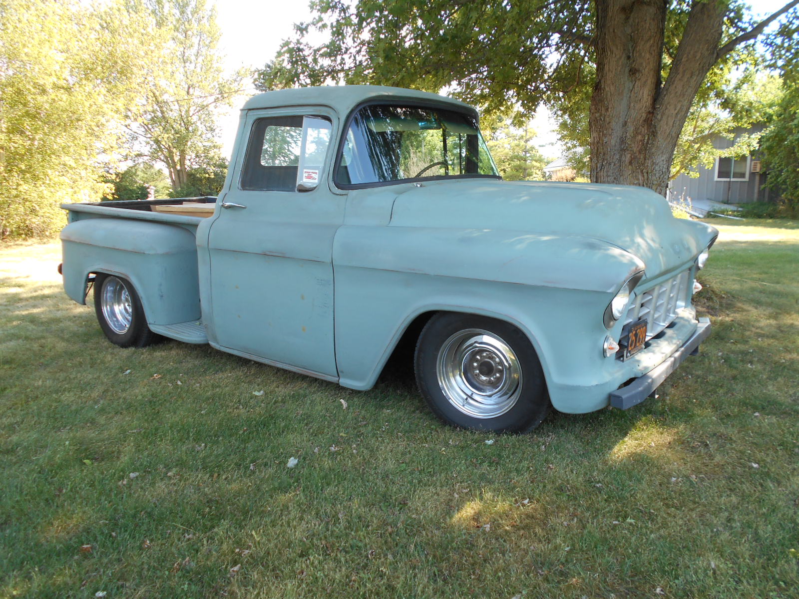

    it looks the same today, but it never sits outside, always garaged,...I scuffed the paint some for a used look. I think it looks better than the 4 colors it was, before I painted it.

    I love that truck man
  5. Lloyd's paint & glass
    Joined: Nov 16, 2019
    Posts: 10,902
    I wanna see more of that truck rusty

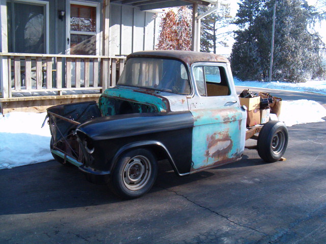

    ...here's a shot during the build, it's got a clip, Nova rear, 292 inline Chevy six, 350 trans, etc.

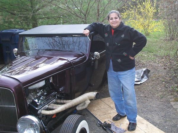

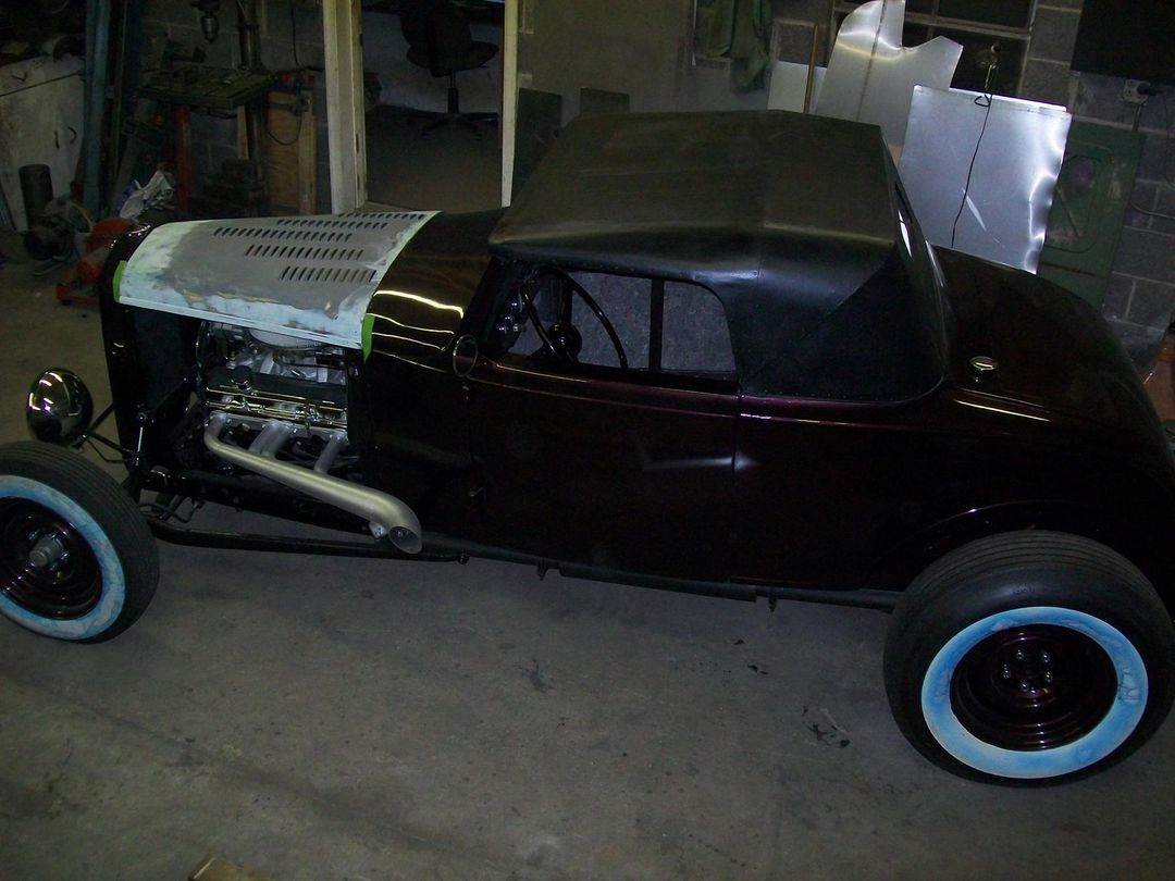

    I'm surprised nobody has mentioned the Eastwood line of paints. I used to shoot in my shop, just some d****d plastic around them, with great results and excellent finish using a rather good DeVilbiss gun and some nice prep work. Many of these paint jobs are 20 years old now and still look decent.
    I am no longer allowed to shoot here due to the lack of a legal booth and zoning regulations so I don't have any recent work to show. This car is perhaps 15 years old in Eastwood, just shot, no block and rub,
