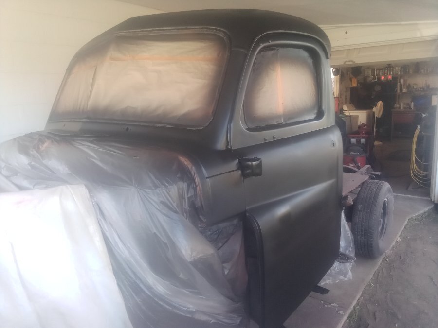

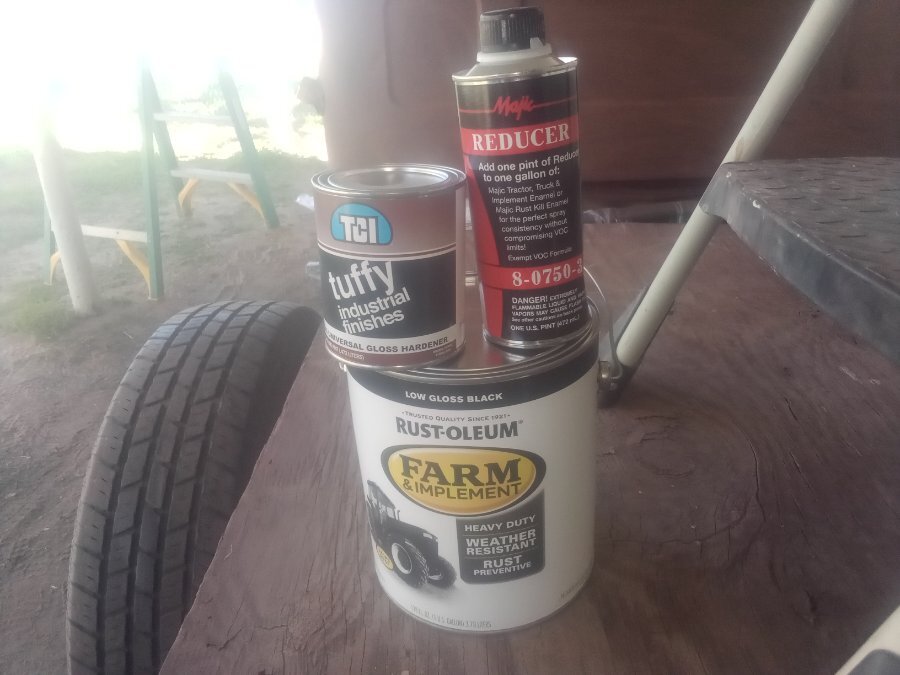

    I finally got mine ready to paint and did it last week.
    I know we do not need hardener with Rustoleum ..... I was told it will help keep the pint from fading like all cheap enamels do. .... Time will tell.
    About $100 in this setup here. .... I plan to do more bodywork to it in the future and want something that is presentable, and easy to color match & spot repairs.
    For a old beater with a heater it looks fine to me. ..... still wet here. IMG_20231020_171614.jpg.55a6c8560427444c4f3503cb4d29a413.jpg

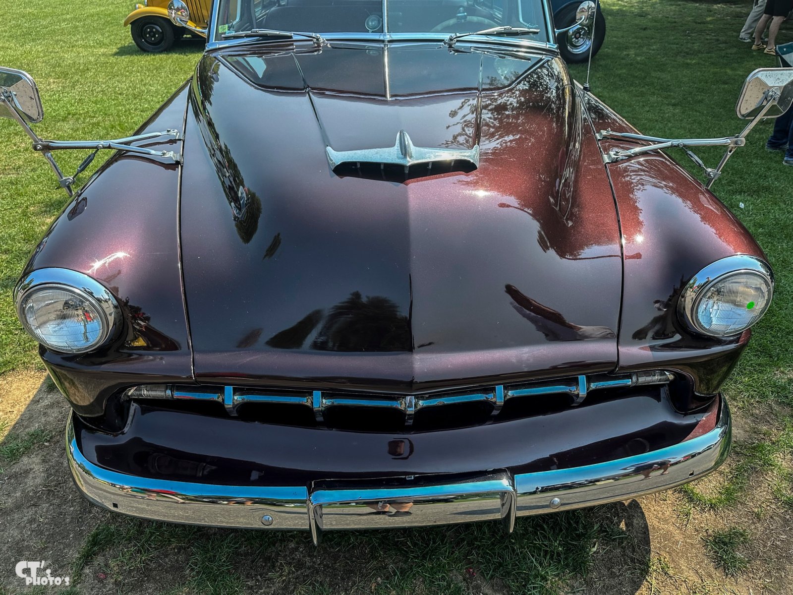

    That's not the type of job I strive for C91D1E74-60F4-4EAF-954E-18A53FE5C291.jpeg . The difference in money isn't that great, and the effort is the same. If you're happy with that, that's OK. I look for this though...

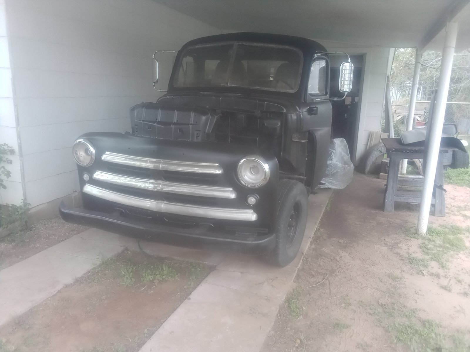

    Not sure if "happy with it" is my exact feelings .... although it is true I am.
    I painted everything frame up with gloss black paint ..... was going to do the same with the body, in fact a few of the pieces such as tailgate and bed parts were already painted gloss black.
    Then when I was getting serious and I painted the nose, I was amazed at how every little ding just popped out and shouted LOOK AT ME!
    Keep in mind this is my first attempt at paint & bodywork. I welded in patch panels, new floor pan, took out a few big ugly dents .... I left the little dings for character. She has lots of character.
    My plans for the truck is hauling lumber for my household projects .... going to the ranch to pick up cow manure for my garden, grocery store ... post office.
    I had to do some soul searching and sleep on it ..... I went to town the next morning and picked up the low gloss paint. Or my other choice would be to put off driving it for another year while I meticulously removed every little ding out of a old construction truck I want to use for a daily driver.
    I also have a fear of getting burned out on the project and never getting anywhere. End up selling it as a basket case with parts ****tered all over the yard. We all hear the stories and look for the deals.
    Soon it will be a running driving project and will have the rest of my life to get the paint I really wanted.

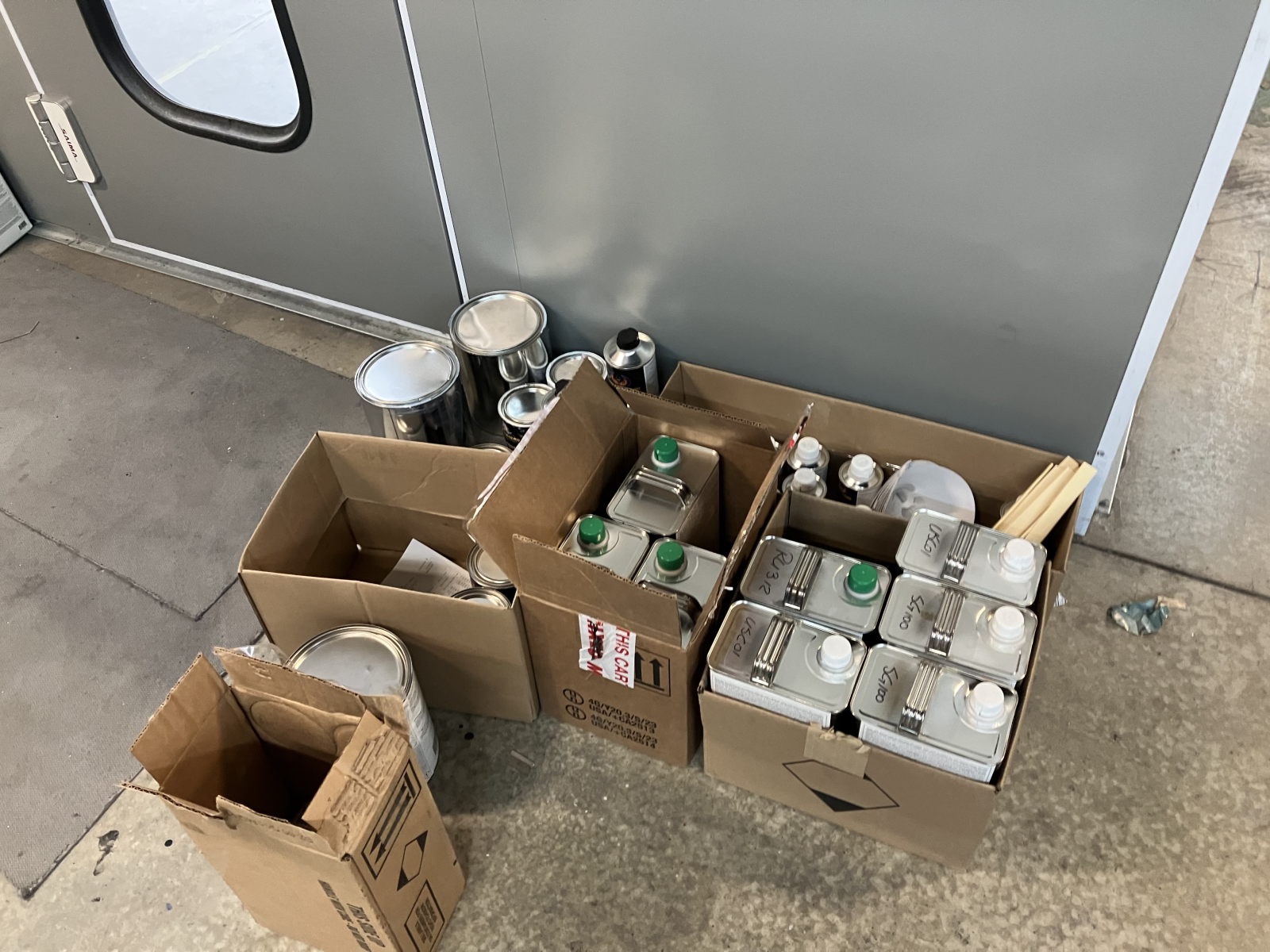

    My 61 Olds just got painted a couple weeks ago, and I supplied all of the paint materials. I used House of Kolor, and both the main color and secondary color are 3 stages each. Pictured here are 2 gallons of base, 2 gallons of intercoat, 5 gallons of reducer, several quarts of the second color, effects packs, 2 gallons of clear and catalysts and so on. This here came to just under $6000 in materials alone, and I have virtually nothing left.

    In the not very distant past you could buy nearly everything pictured above for under $2,000 :eek:

    Absolutely correct. When we painted my 57 Ford back in 2010, similar materials from HOK were $1400.
