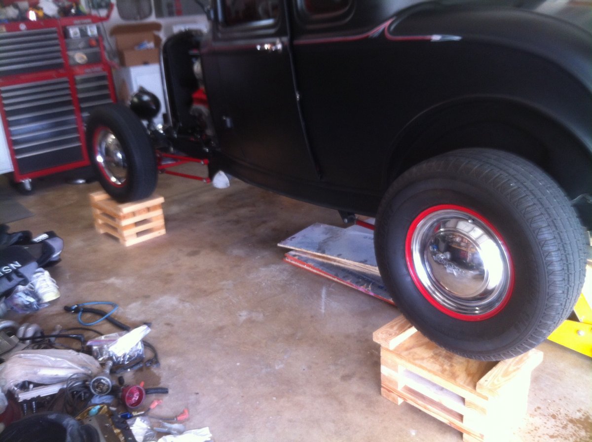

    Here is an idea for some simple and cheap stands for lifting or prolonged storage during the build process.
    4x4 CCA stock cut into 12" lengths. Criss cross and screw together with coated deck screws. Top is 3/4" plywood. Stack to whatever height you need. In this day of outrageous concrete costs, many shop buildings are being left in gravel with a platform of plywood for the car. In this case, these stands can be screwed to the floor, they will never tip or move.
    For lifting, I really like house screw jacks. They are adjustable by minute amounts, and will lift the heaviest car, truck, or tractor. More importantly, they come down under load smoothly as opposed to an oopsie of turning a hydraulic jack a wee bit to far. In the photo, you can see the house jack on the platform with a 2x6 used for the beam under the frame. I drilled a shallow 7/8" paddle bit relief for the spring bolts to eliminate any possibility of the beam moving. Another little trick is to put thin bubble wrap under the springs, the pop, pop, pop, will tell you when you have pressure on the beam.
    There you go; cheap, easy, safe ! :)

  7. image.jpg They make some cars a good working height also. Easier on old guys backs image.jpg

    I've built a set similar to 325W; they sure come in handy! I've also built a few sets of the wooden jack stands, only I pyramided mine (starting with a wide base and gradually narrowing toward the top)...one set was specifically for the Bug, where the top block had a radius cut to saddle the rear torsion housing, making for a secure and stable jack stand when pulling the motor.

    Here is another photo of a taller set under a heavy touring car. Note screwed to the floor as mentioned above. Also a pack of composite shims are your friend. They will take up any slack, and won't crush like wood.
    These were originally built to help a friend restore a 50's Mercedes Adenauer sedan. It sat on those stands for three years and never budged. I never looked up the actual weight of that rascal, but it certainly was as heavy as it was beautiful !
