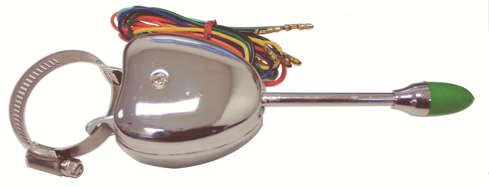

    I had the '26 out this morning. Got to the first corner and my turn signals aren't working. Great! No turn signal. no hazards. Fuse is good. But when I turn on the hazards and hit the brake, all the turn lights flash. Okay, so the turn signal switch has fallen apart inside. AGAIN. I have 30K miles on this car now, and I have replaced that switch twice now. The switch is the one from Speedway. Chrome plastic, looks cheap and apparently is! I have been searching, but that is the only switch I can find. Seems all the vendors are selling the same piece of ****. Can anyone point me towards a good quality turn signal switch?

    If your in a rural area there are probably a bunch of those add on turn signal switches in old trucks just waiting to be put back to work :)
    Most likely will need a bit of cleaning on the contracts, but guaranteed to be built a whole lot better than the **** being sold now!

    Maybe try a vintage TSS from eBay or similar.

  5. It's obvious that you've lost the turn power from the flasher. The business of all turn lights coming on when you hit the brakes with the hazard switch turned on is normal. So before you throw another switch at it, I'd dis***emble the one you have and see if repair is possible. It's probably a design flaw, you may be able to address it.
  6. Goodspeed USA sells a decent cheap one. Actually made of metal

    You have to be careful with old heavy truck turn signal switches. Most were setup for lamps and won't allow the brake switch to override the turn signal on one side.

    ^^ I have used this one with good results

    There was a 3 ****on switch made for over the road trucks we used, came 4 or 7 wire. Push L. ****on or R. for turns, middle canceled, push L & R for 4 ways. Box was like 3''x3'' & mounted up under lip of dash panel if you wanted to hide it. Probably Signal-stat or Yankee.

    I used a United Pacific model on my dune buggy, metal case, light on the end lights up when blinking. No issues. Summit sells them

    Was it the standard Cheapo turn signal switch ?
    https://www.speedwaymotors.com/Speedway-Standard-Turn-Signal-Switch,7012.html
    or the "Heavy Duty" cheapo turn signal switch, that is less money than the standard version ?
    https://www.speedwaymotors.com/Speedway-Heavy-Duty-Turn-Signal-Switch,30566.html
    Both appear to be held together by screws, open it up and see what is inside.
    If you are lucky, with the other broken ones, you have enough pieces to fix it.

    Because many of the truck switches are setup for seperate lamps for turn signals and brakes. There is no provision inside the switch to deal with brake lights like there is on a p***enger car turn signal switch. On a car the brake and turn signal share one filament of an 1157 bulb.

  28. yes the switch you want has 9 wires, the 7 wire switch does not turn the brake light off on the side you want flashing.
    The best switches are the old Signal Stat switches. I have one in my International for 45 years and still going strong. the switch in my Model A is a 40's switch from a Chevy, been working for 11 years in that car.
