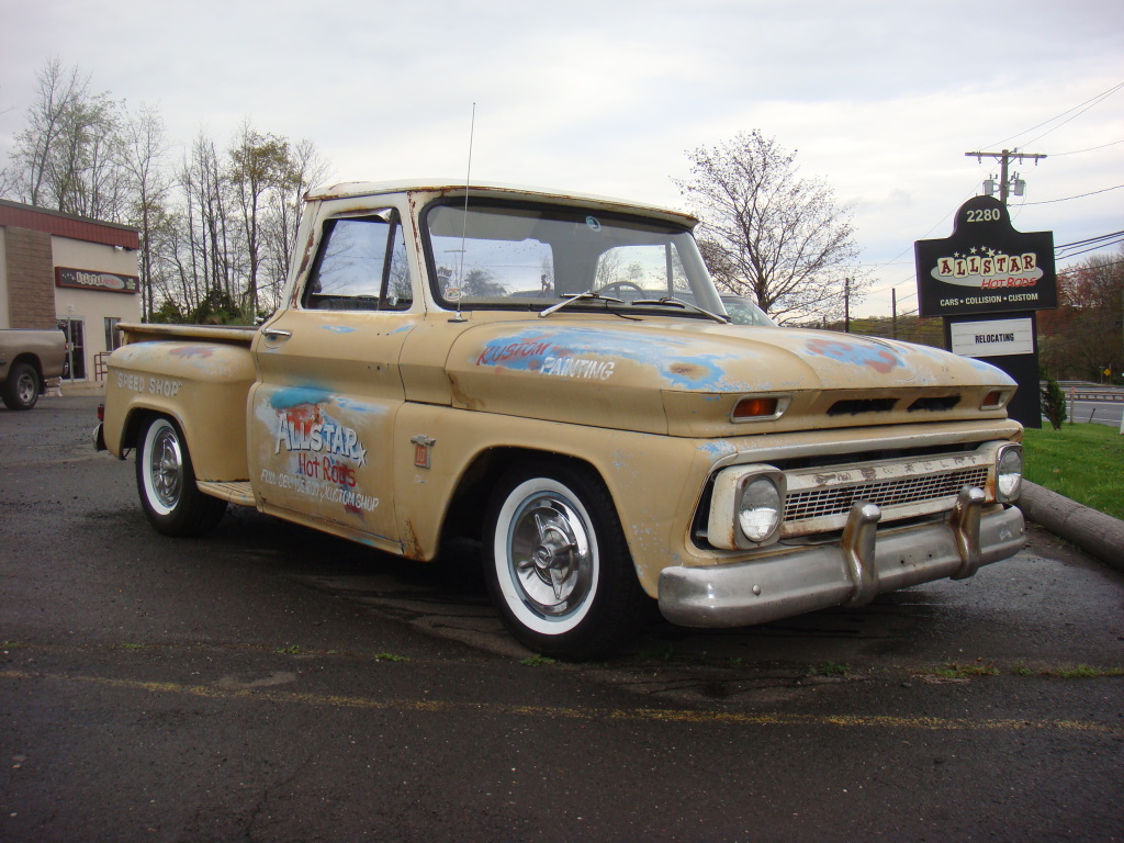

    A week or so ago I was at AllstarDerrick's shop and I brought up my desire to get a set of whitewalls for my F100. He suggested portawalls and in fact he has them on his shop truck. I was always under the impression that portawalls weren't meant fro radials but with a little further investigation plus Derrick's insight I've shelled out the minimial amount of money and purchased a set.
    The manufactur suggests running smaller diameter portawall on a minimum of a 75R radial. I have yet to mount them but I know Derrick has been happy with the set on his C10.

  8. His truck looks great, but here are a few examples, beyond my personal experience, of why I don't spend money on port-a-walls anymore...
    http://www.jalopyjournal.com/forum/showthread.php?t=446153
