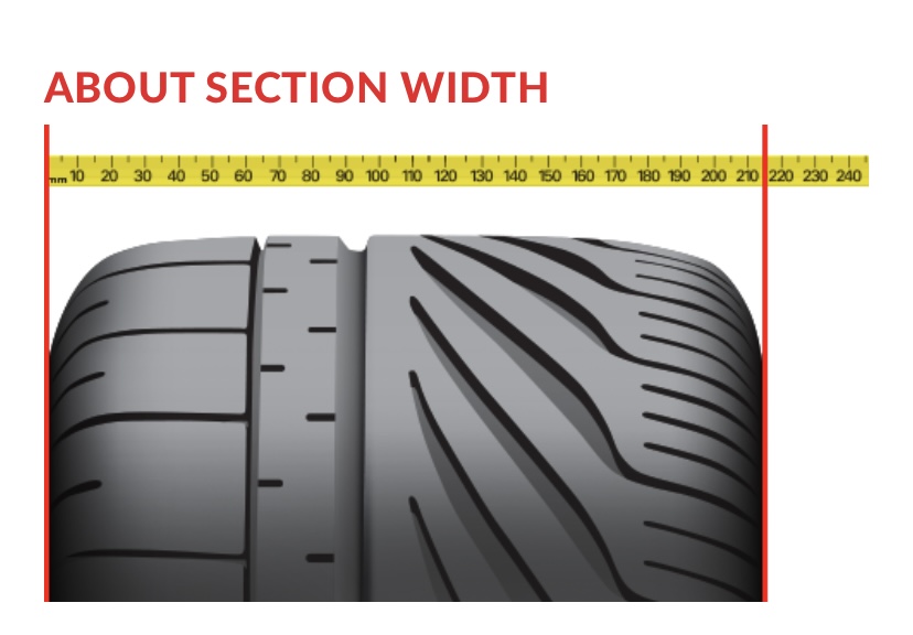

    Hello,
    I'm going to be ordering some 28.5 or 29.5 x 10 cheater slicks for my 10" wide wheels.
    Anybody have a section width measurement for some Towel City or Radir cheater slicks on your 10" wheels? I'm narrowing my housing tomorrow and have calculated for the daily street tires but I also want to have a set of cheater slicks for it.
    Thanks

    I already reached out to the nice folks at Towel City and he gave me a range. I'm working with some fairly tight clearance so I was hoping somebody may be able to take a measurement off of their tire.

    Thanks. I'm just asking if somebody with 10" wheels and 10" Towel City cheater slicks can measure their tires at the widest point.

    I had 10" on 8.5" wheels and sidewalls were the same 10" width as the tread width. I'd expect with another 1.5" wider rim the sidewalls would bulge 3/4" per side. Hope this helps?
