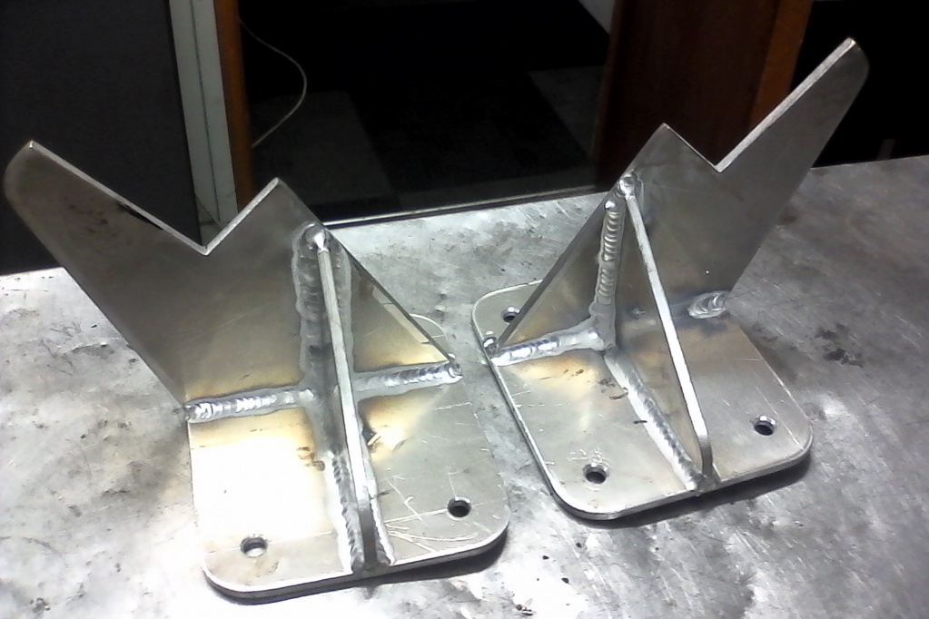

    Solid front mounts for the engine that must not be mentioned......
    Started out with a few odd shapes cut from 1/4" aluminium plate:
    And after welding:
    Imagine these the other way up, bolted to the engine at 45 degrees.
    The square cuts will rest on the inside of the ch***is members, and will be bolted to 'L' shaped brackets welded to the inside of the ch***is members. I'm not going to drill any holes until I've trial-fitted the engine.

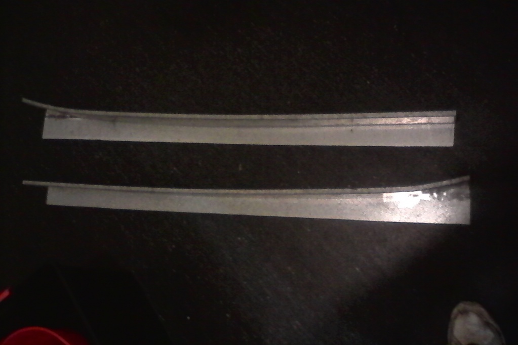

    And just as a taster of body mods, here's the (unfinished) inner sill/step panels, expertly made from old wiring conduit saved from a skip:
    The top of the panel will be level with the floor, and the lower (flat) panel will be the door sill top. They should give around a 4" channel lower than stock.

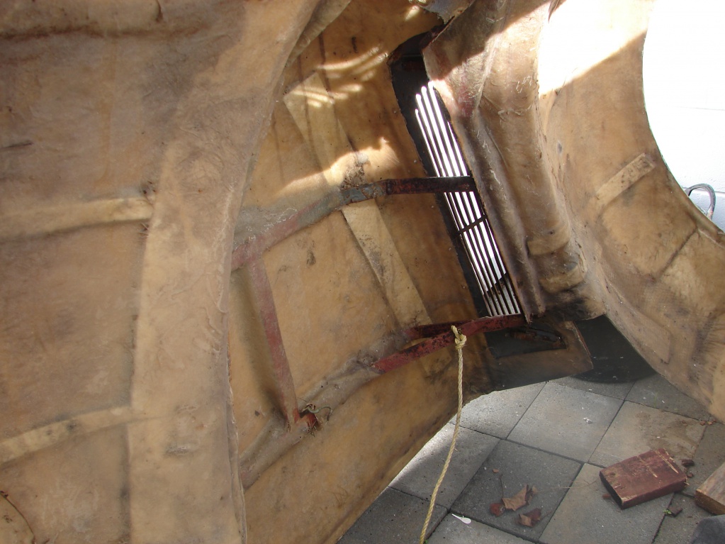

    Just collected this:
    One piece flip front. At some stage in it's past someone has bonded in an original steel grille and steel side-vents. I'll remove these and re-gl*** the holes.
    I'm aiming for the smooth front as on the Blair's car.
    I got it for a straight swap for the original tins, and both I and the swap-ee are more than happy.

    Whilst the trunklid is ongoing at work, I thought I'd attack the front end at home.
    In it's past, someone had bonded in original steel grille and side-vents. These have to go as I'm looking for the smooth look like Blair's car. Unfortunately they were cut down to fit so are pretty useless. I think they'll become wall art!
    Fortunately the rust had loosened all of the filler, and within an hour it looked like this:
    Next job will be fill the holes. I already have a plan!
