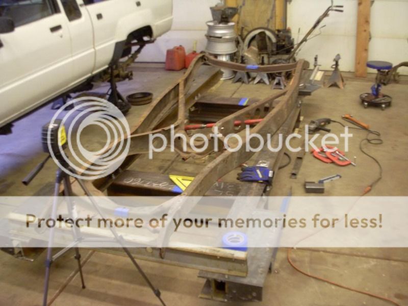

    Now its time to start working on the frame. I set up the frame table and thought I would see how bad it was.

    Well after getting it all squared up on the table found the rails to be pushed to the passenger side about 2 1/2". So started pushing and pulling it in to shape.

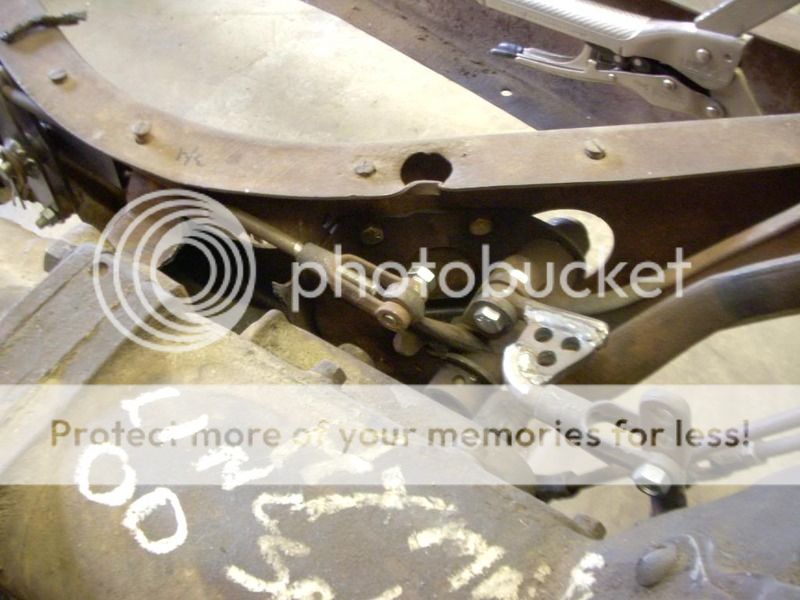

    I am one of those people that loves to look at pictures, but can't get myself to stop what I'm doing to take them. So I am missing a LOT of stuff that I did. So this picture is after I got the frame straitened and engine and trans mounted. Steering column in and working on master cylinder linkage.
    So now this is the chassis all mocked up

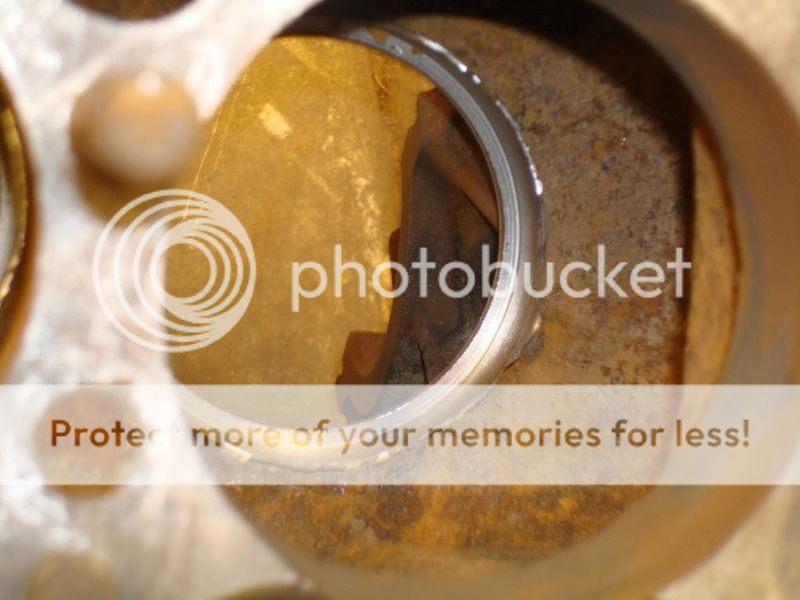

    We are going to really jump on the pictures I have. Whats not shown is I took apart the chassis and just put a quick coat of black on everything then went through the trans, brakes and what not then bolted the body on. One night over at the shop talking with my dad about what to do with the engine we got this great idea to put the rotating assembly out of a 53 merc into my 37 21 stud block. My dad is a mechanist and will let Kris and I talk him into doing some fun stuff on the mill. So he went to town on the motor for me. The motor I had gotten from one of our friends was a rebuild from back in the day and had a sleeve in every cylinder. So dad came up with a holding fixture for the block and cut the steel sleeves out. We ordered up some new cast sleeves and he found that it would interfere with the bottom row of studs. So he just moved the bore up about .020" or so to get the clearance we needed for the new sleeve. Let me tell you that my dad is a perfectionist and this project didn't happen over night.
    After getting the cylinders cut all the way out he was ready to install the new sleeves. With the block machined to a press fit he needed to shrink the sleeves to get them to go in. He tried to just put the sleeves into the freezer over night and that just got a about .001" . So tried rubbing alcohol and dry ice. This seamed to work good but just made a big slushy (rubbing alcohol is part water). So he found some pure 100% alcohol and put some dry ice in that and was able to get it down to a temp around -70 F ! that got him about .004 in about 10 min. That was the ticket.
    I think I am rambling on now, to make a long story short put the sleeves in had to cut off the end of the crankshaft, and grind the mains to fit the block. LOTS OF WORK THERE!

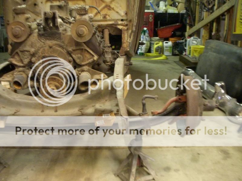

    The late model pistons have a dome so clearance was needed on the cylinder heads.
    Motor in the car.
