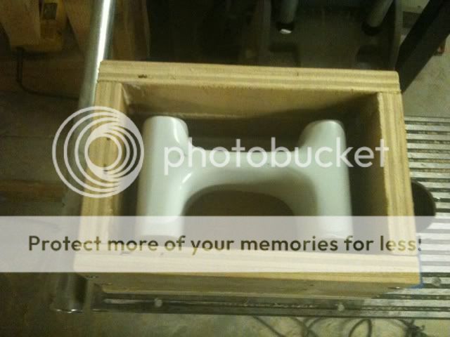

    Got my spacer almost ready to cast! Let me tell you, this has been a big project! I think I will have more hours in this dam pattern then I have In the hole dam car! Kris keeps telling me "if it was easy, everyone would do it" ha ha! So I think we will do the lower intake manifold next..........year!
    Anyway check out what I have so far.
    This is the making of the core.
    So now the pattern gets the "core prints" added.
    Core all done.
    Now I can make the core box. I will post pics of that part for sure.
    Did some clean up sanding on the pattern. Thinking it's ready for name on the side " ELMER" !

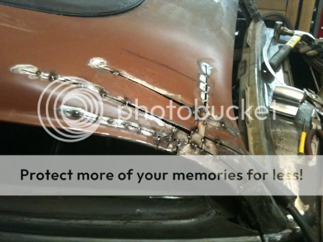

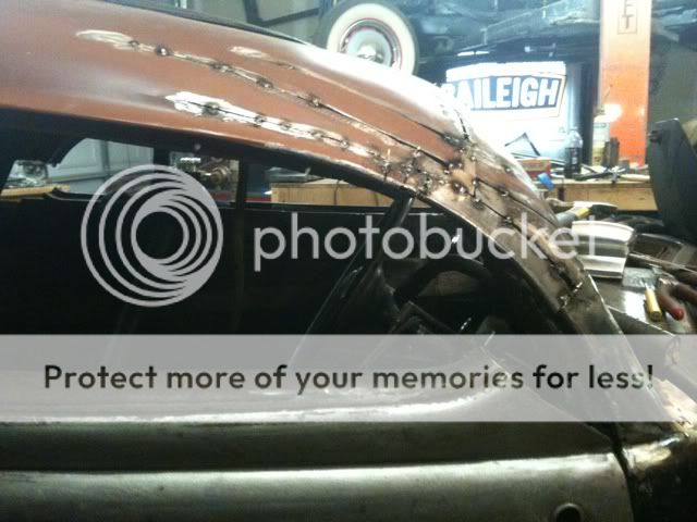

    While I was "f in" around with my spacer Kris got something done on the car!
    Driver side A pillar done (just needs to be planished and leaded).
    Right side all cut up!
    Kris' pattern so both sides match.
    The drip rail was rusted out and Kris made a new patch panel for it with that bad *** bead roller that he won from last years tech week.
    We ran out of argon gas for the tig welder (it only happens on Sunday!) so I'll be heading down to AirGas tomorrow on my lunch.
    Getting started with the rear window.
    That's all I have for tonight!

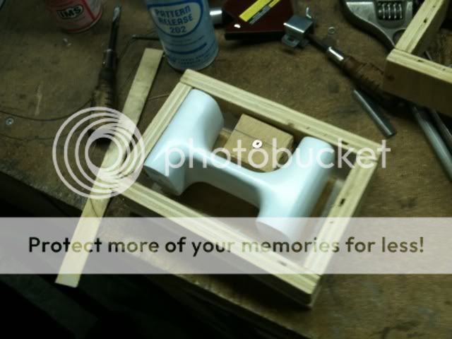

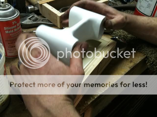

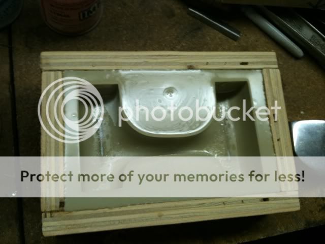

    Worked on the pattern tonight. We are getting close to casting this pos!
    Last coat of paint to get them nice and smooth.
    Putting together the core box.
    What I forgot to take a picture of is I made two small 3/8" blocks to hold the pattern off the bottom of the core box. Then we added some filler blocks so we didn't have to use as much plastic.

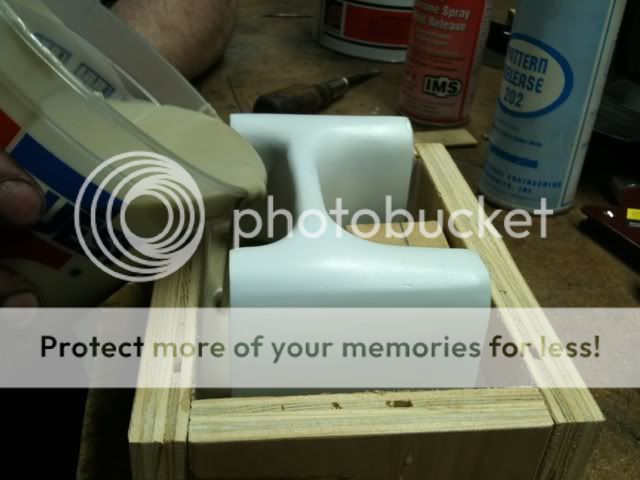

    Using a two part plastic to make the core mold mixed half and half.
    Pore it in and let it set up!
    The pattern wanted to float so we got something heavy to hold it down.
    It only took about 20 min to set up, then Kris pulled the pattern to see what our mold was going to look like.
    Now the other half, with a filler block.
    And there you have it! One heated intake riser core mold!
    This plastic sets up hard! Just a little more work to this mold tomorrow night and it will be ready to make the core that will be used to cast this bad boy!
