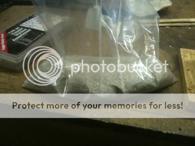

    So this is the core box ready to make a core.
    Filled the core box up with sand to see how much I was going to need.
    I think it was almost a pound? But put it in a ziplock bag and added about 3oz of "water gl***" to it. That stuff is like syrup and it hardens up when you expose it to Co.
    Now after it's all mixed up. Pack it in.
    We used some mix welding gas to " gas" the core and get it hard. Then we baked all the moisture out of it in the microwave. Don't tell Kris' wife!
    This is what the core looks like. I made 3 of them. You never get a good pore the first try! Haha

    Had a picture of the "water gl***" that we used.

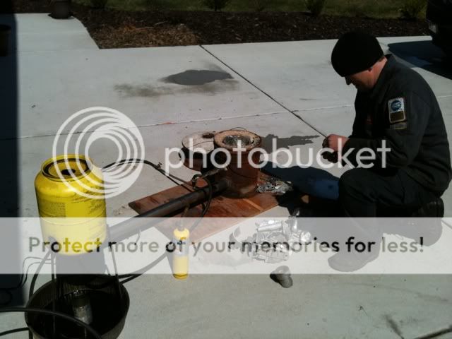

  14. Muffin
    Joined: Jan 24, 2009
    Posts: 128
    Muffin
    from Layton, UT

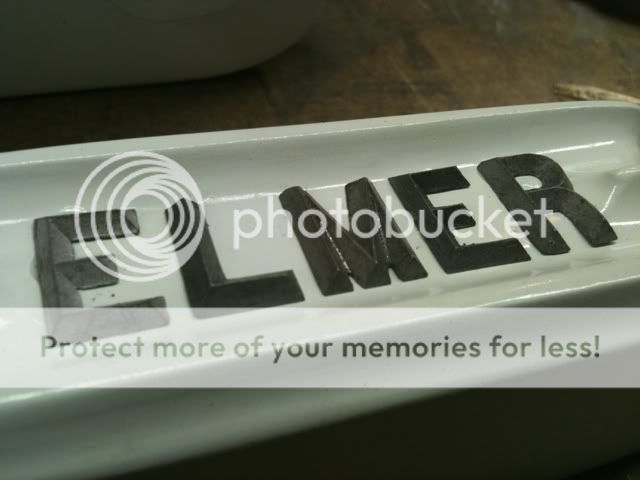

    Time to put the name on the pattern.
    Just used superglue to hold them on.
    A little baby powder on the packing board to keep it from sticking.
    Packing in the pattern.
    Now it needs parting dust so the two 1/2's will part.

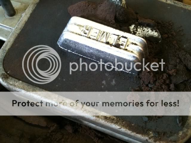

    All packed in. Time to see what we got!
    Clean it up a bit.
    And we have a sand mold.
    Clean up the core with a file.
    Test fit
    kidcampbell71 likes this.
  15. Muffin
    Posts: 128
    Muffin
    from Layton, UT

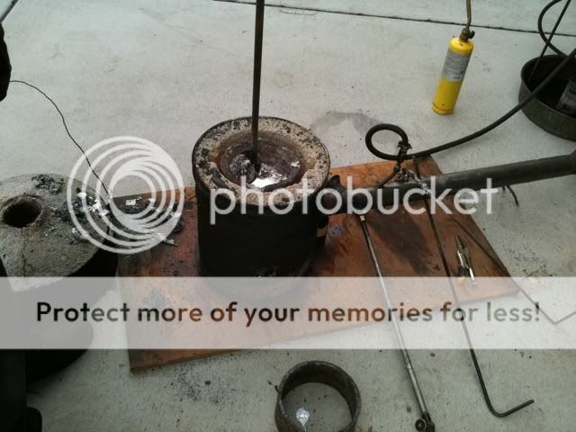

    Let's do this!
    ls1yj and kidcampbell71 like this.

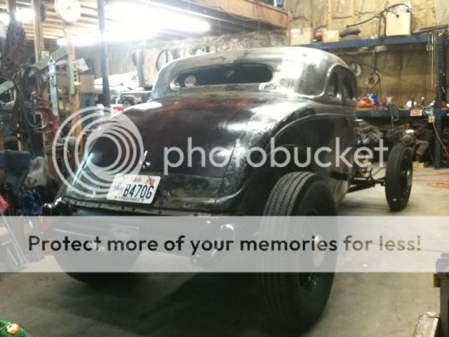

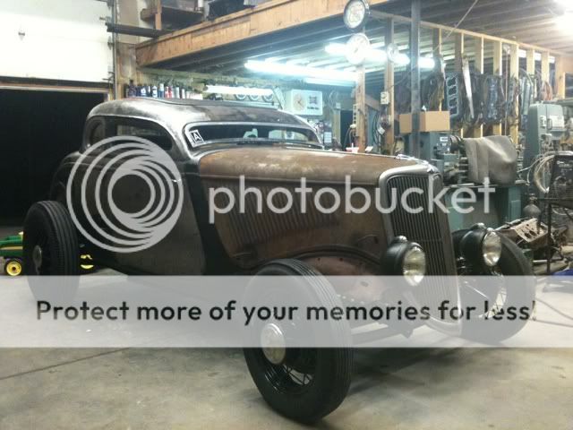

    It's one of those boring rainy nights thought I would put some pics up of what the car looks look now.
