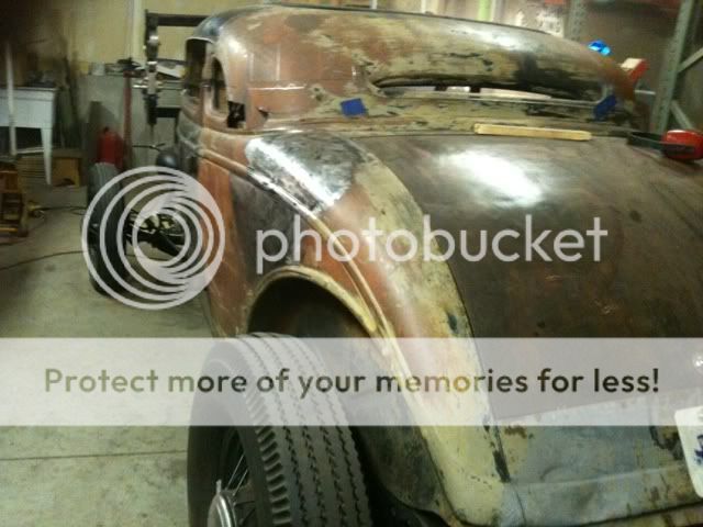

Chop it! This is what it looked like with about 6" out. I just wasn't "feeling" it. The rear window didn't look right? We wanted to lay the A pillars back so Kris took the cut off wheel to the cowl. We put the roof on the bench to work on the windshield opening. At first we went with a 5" windshield.

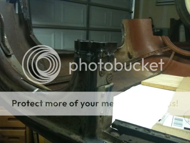

Just found out that you can only post 20 pictures at a time. Ha ha! Anyway back to it. Just wasent "feeling" it. So we played around with adding to the B pillar to get the look we were looking for. Kris and I both thought it needed one more out of the windshield. So back off with the top. One more inch. Yep! That's it!

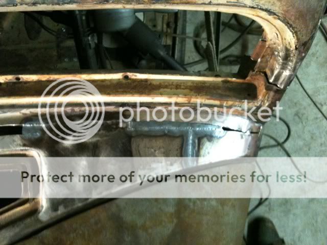

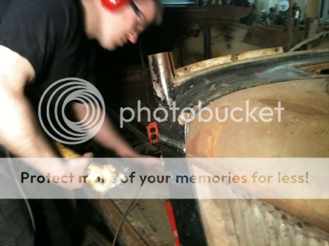

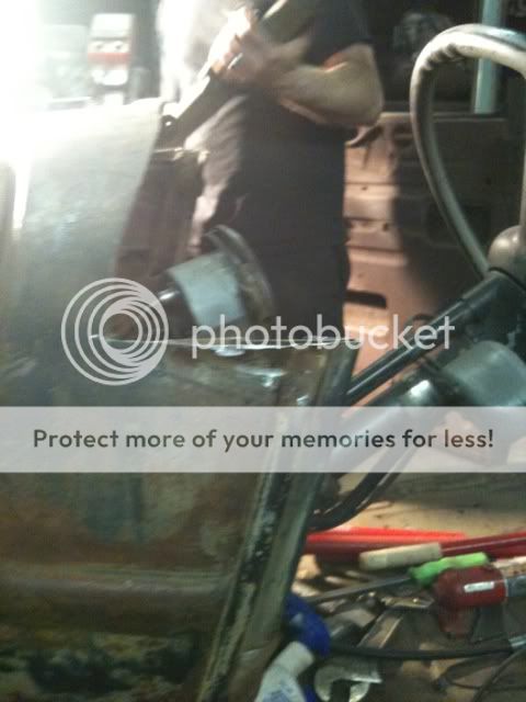

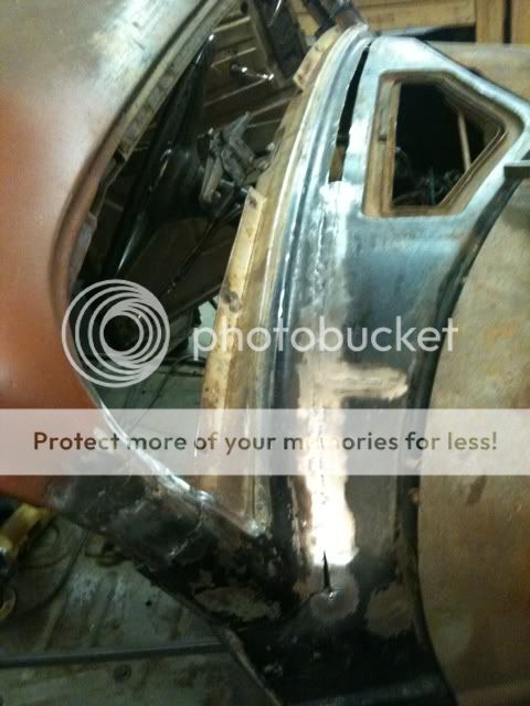

Time to start welding it back together. This is the A pillar fit. I was talking with Milkweed on the phone the other night and hetold me he had a "real" hand held planishing hammer that we could use if I wanted to drive out and get it (the frame I built wouldn't allow us to get a good bite on the cowl area. So here is the Thor Fender-Hammer he had! Welded up. Ready for Thor to smash the welds! Cowl all hammer welded up!

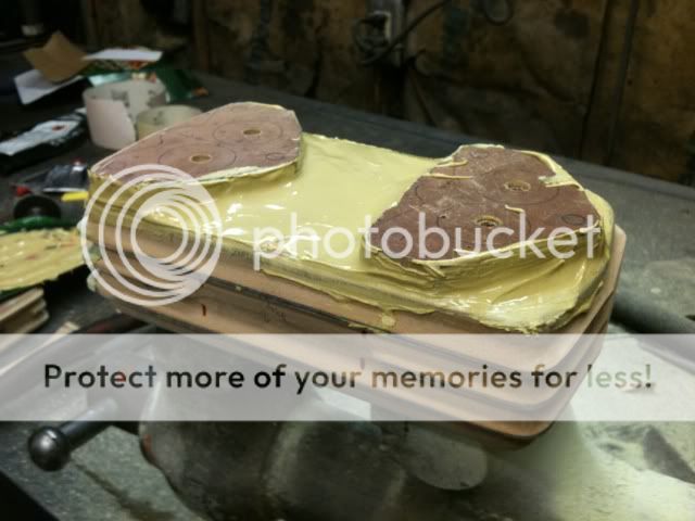

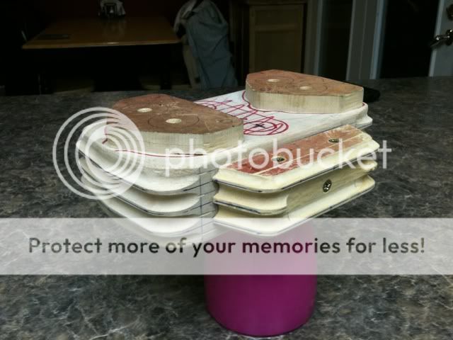

Not that we don't have enough to do before we go to Viva. I have been working on a pattern for a water heated carb spacer that Kris will cast up before we head out. I will post more on the Elmer water heated carb spacer as we go also. Well tell next time.......
WoW that carb spacer is going to be unreal I could not remember Kris' name, then it came to me "taskmaster"
