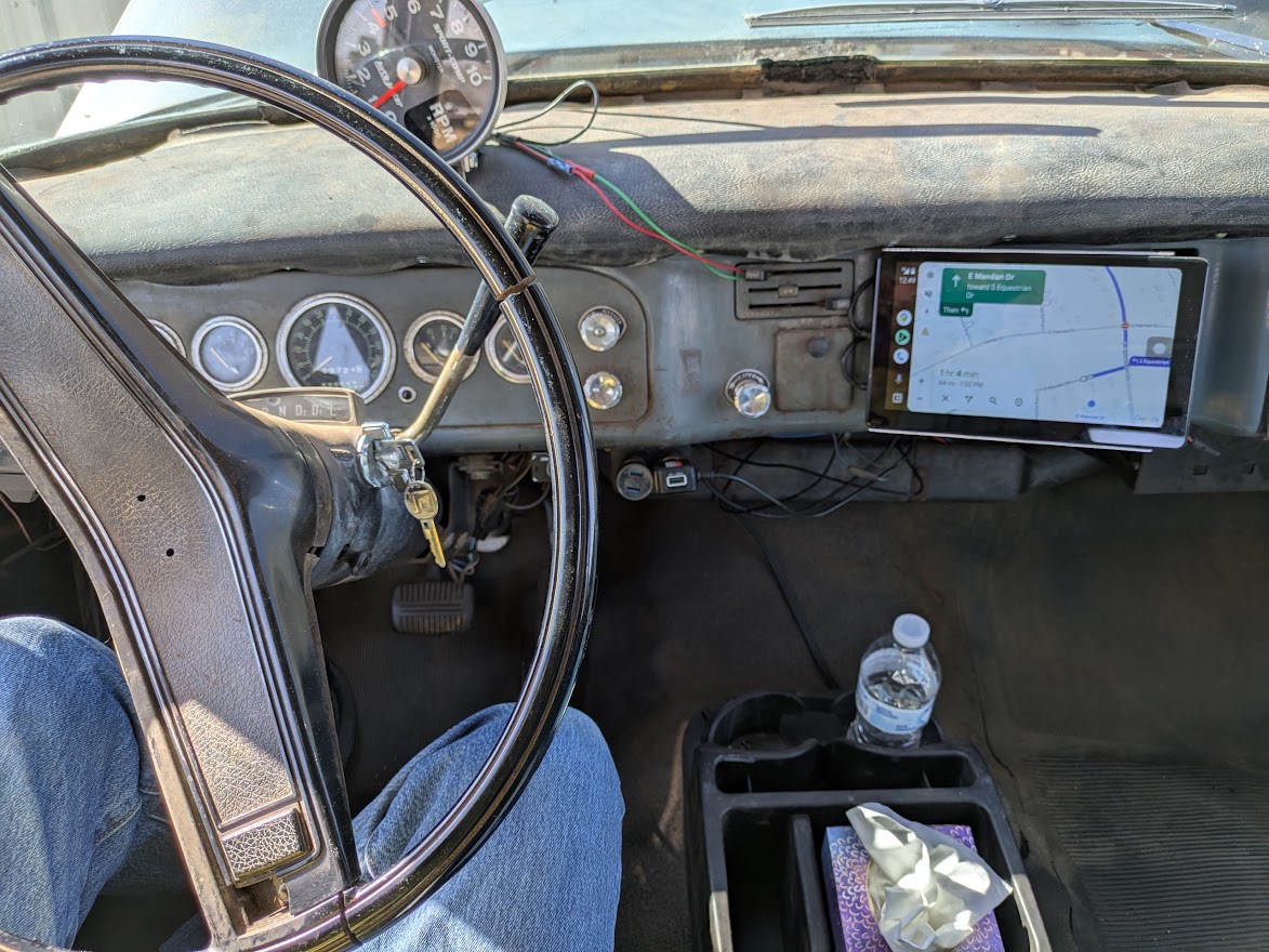

    ok, things are just getting silly now. Cup holder, and a built in screen? What is this, a new car?
    (yes, there's also a backup camera attached to the screen)

    That is quite the tachometer you have there!!!!
  17. squirrel
    Joined: Sep 23, 2004
    Posts: 60,978
    squirrel
    yeah, I had it on my 55 for a long time. Easy for me to see.

    You beat me to it. A checker cab with a tach that goes to 10k rpms, that must be a rare sight, hahahaha

    Note: the tach reference needle at 4500 rpm, it should live a long time :D

    He wired as a 4 cylinder so it looks like he is hauling.

    How many young man's dreams have been squashed when their wiser friends pointed out that the part making their 9,000rpm small block was a tachometer 4-6-8 switch?
