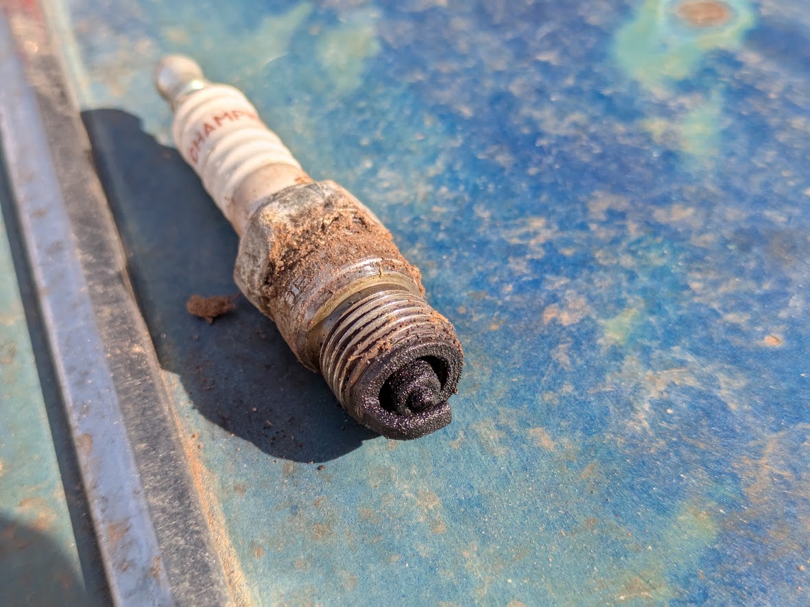

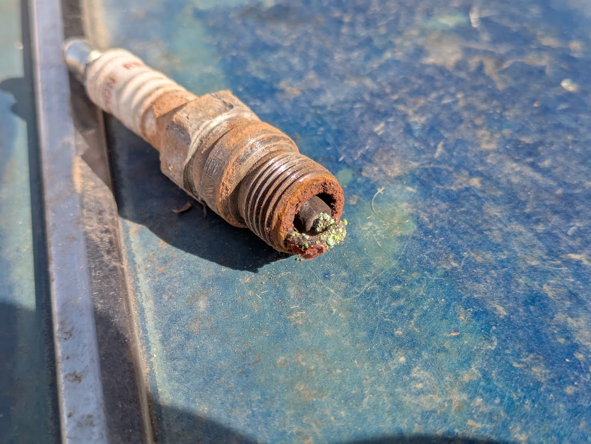

    I tried to start it, didn't want to get going, although it was trying. I pulled the plugs and cleaned them..four were OK, just dry carbon, but two were funky, one had corrosion, the other was wet fouled. Then I tried again, and eventually got it to run like it should. I was filling the carb float bowl with an oil can through the vent hole, which lets it run for about half a minute at some RPM. Had oil pressure and charging. The cooling system is holding water, I only had to add less than a gallon to the radiator....there might be old antifreeze in it, hopefully. Seller said he'd replaced the freeze plug on the back of the block, and I found the receipt for the plug in the glove box.
    Sorry, no video. I'll never make a living from youtube, apparently.

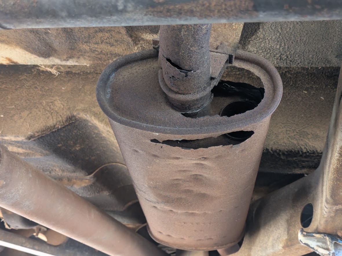

    Oh, did I mention the muffler is a bit rusty?

  7. Sharpone
    Joined: Jul 25, 2022
    Posts: 4,766
    Sharpone
    Looks like a free flowing muffler to me.
  8. squirrel
    Joined: Sep 23, 2004
    Posts: 60,978
    squirrel
    very free flowing!

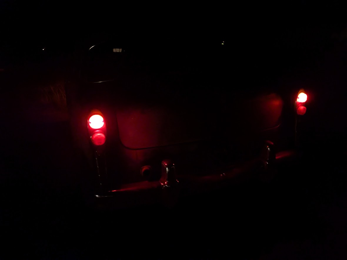

    Those tail lights can be sanded with 1000 grit and clear coated, this makes them look as good as they can possibly look…:)
    Okie Pete, porkshop and Sharpone like this.
  11. squirrel
    Posts: 60,978
    squirrel
    If I leave them alone, they'll match the rest of the car....which I think looks better, than having a freshly lipsticked lens on a pig....

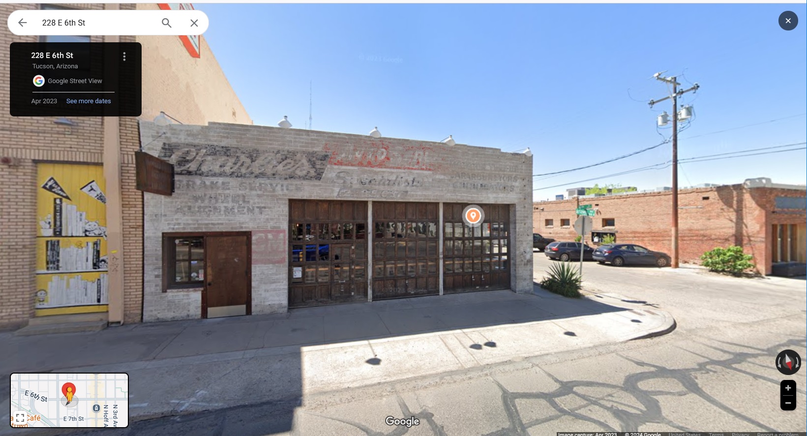

    The owner of the Checker dealership was known as "Charlie Checker". He did not sell a lot of his trade-ins. Instead, warehoused them in a medium-sized 2 story brick building. About 30 years ago, there was an ad in the Tucson newspaper about auctioning off the contents. I attended the preview.
    The building had a drive up ramp to the 2nd floor. I suspect that it might have been a 1920's auto dealership. Two stories of 1960's trade-ins, in as-traded condition (very good physical condition, would have qualified and a good used car in the day). Nothing was running, having sat for many years. Mostly family cars, nothing that I was interested in - A couple of Plymouth Barracudas - No obvious defects - I just never warmed up to the "fancy" Valiant...

  23. oldiron 440
    Joined: Dec 12, 2018
    Posts: 4,614
    oldiron 440
    J
    That sounds good until you get rear ended because somebody can’t see your tail lights. As far as lipsticked lens they wouldn’t look any different than a new lens.
