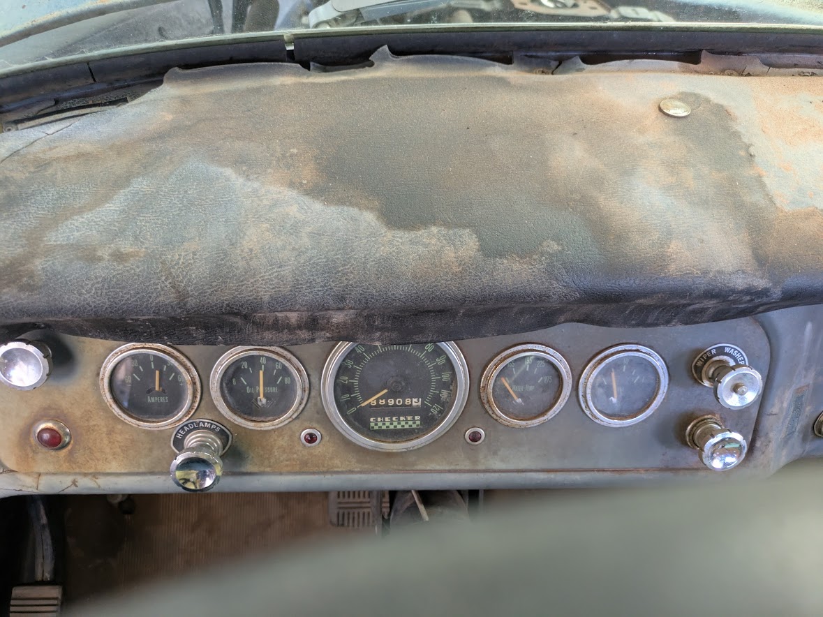

    The gauges are mostly working, too...haven't got it warm enough to see if the temp gage is working. Chasing power to the brake lights now. And there's a neat rattle from the bellhousing area? But it's running OK. I replaced the fuel pump and rubber fuel lines, and added a big filter before the pump to catch the stray **** from the tank.

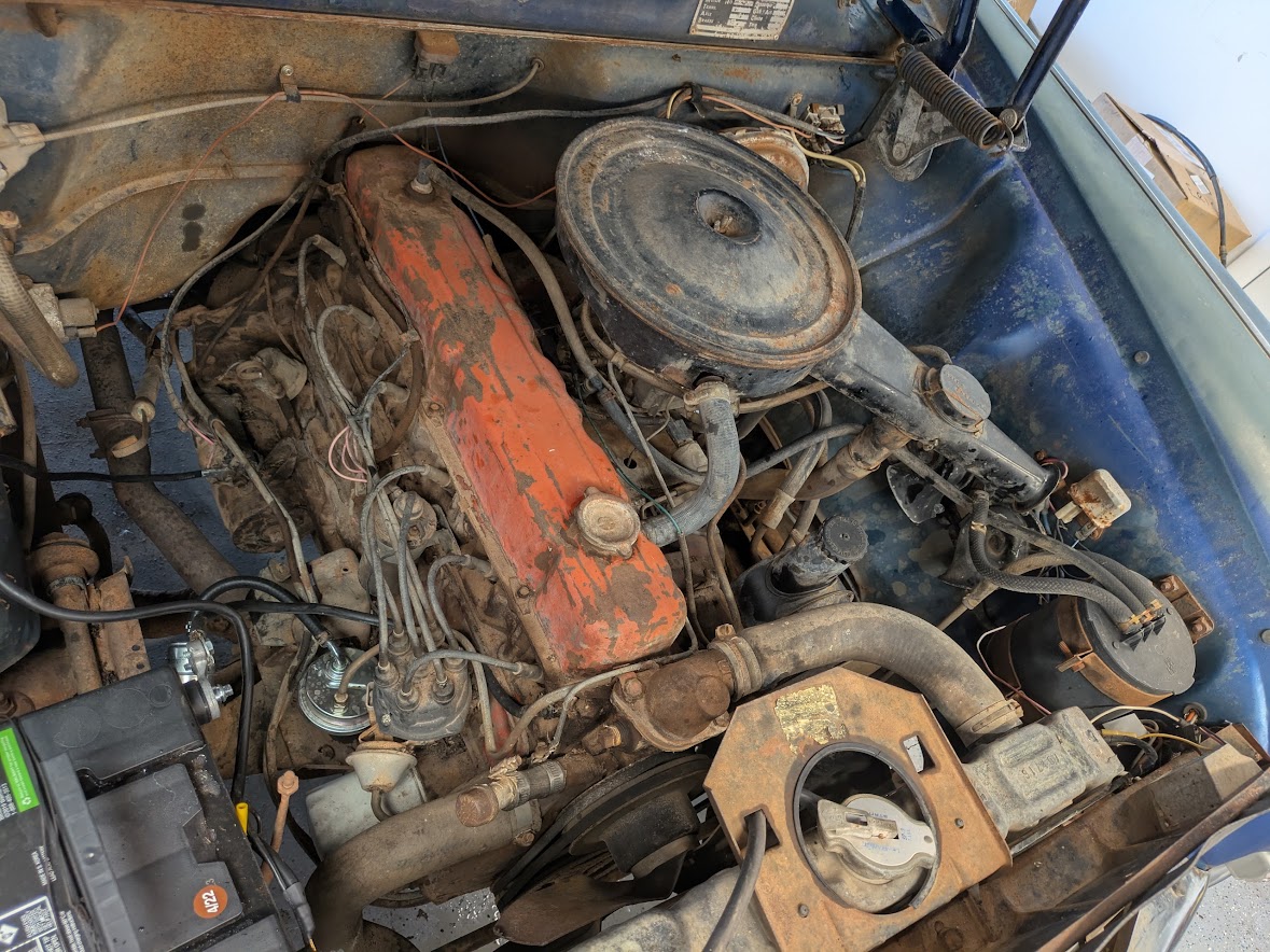

    Spent several hours cleaning stuff...like the interior...
    and went for a little drive around the block. It runs mostly OK, although it did some popping stuff, and it's kind of loud. The brakes work. The steering is effortless, and it has a very tight turning radius. It's also a big old boat, and not very peppy.
    The temp gauge doesn't work, it looks like it's the sender, since it measures "open" and putting a resistor in it's place makes the gage move like it should. I ordered a new one, it's NORS because no one makes them any more. At least I hope I ordered the right one, it's for International trucks and a few jeeps from that era. The resistances might be close enough, and it's the right size.
    I'm tempted to replace the thermostat, as it didn't open on the test drive, but then the head only got up to about 200 degrees. So maybe if I push it a little more it'll start working like it should.
    My kid was measuring big block engines and the engine bay, and seeing what it would take to put a real engine in there.

    Went for another test drive, the temp gauge started working, and the thermostat started working. Still popping. I checked the brake fluid and it was low in the rear reservoir, and I noticed a drip from the back of the master cylinder. So, time for brake work. It looks like the master is for a 70 Belair with power drum brakes, the online catalogs only show the disc brake master. I also ordered the wheel cylinders, and some hoses that might fit. So no more driving until later next week. I'll also pull an axle and see what the wheel bearings in back look like, as I can't really tell from what parts are listed for it.

    Popping - most likely cause is an intake not sealing. Either due to wear, a sticky stem or a weak valve spring. I wouldn't rule out ignition until checked either.

    I put a condenser in, but haven't had a chance to test it yet. I also pulled the spark plugs to see how they're doing, and they all look quite happy.

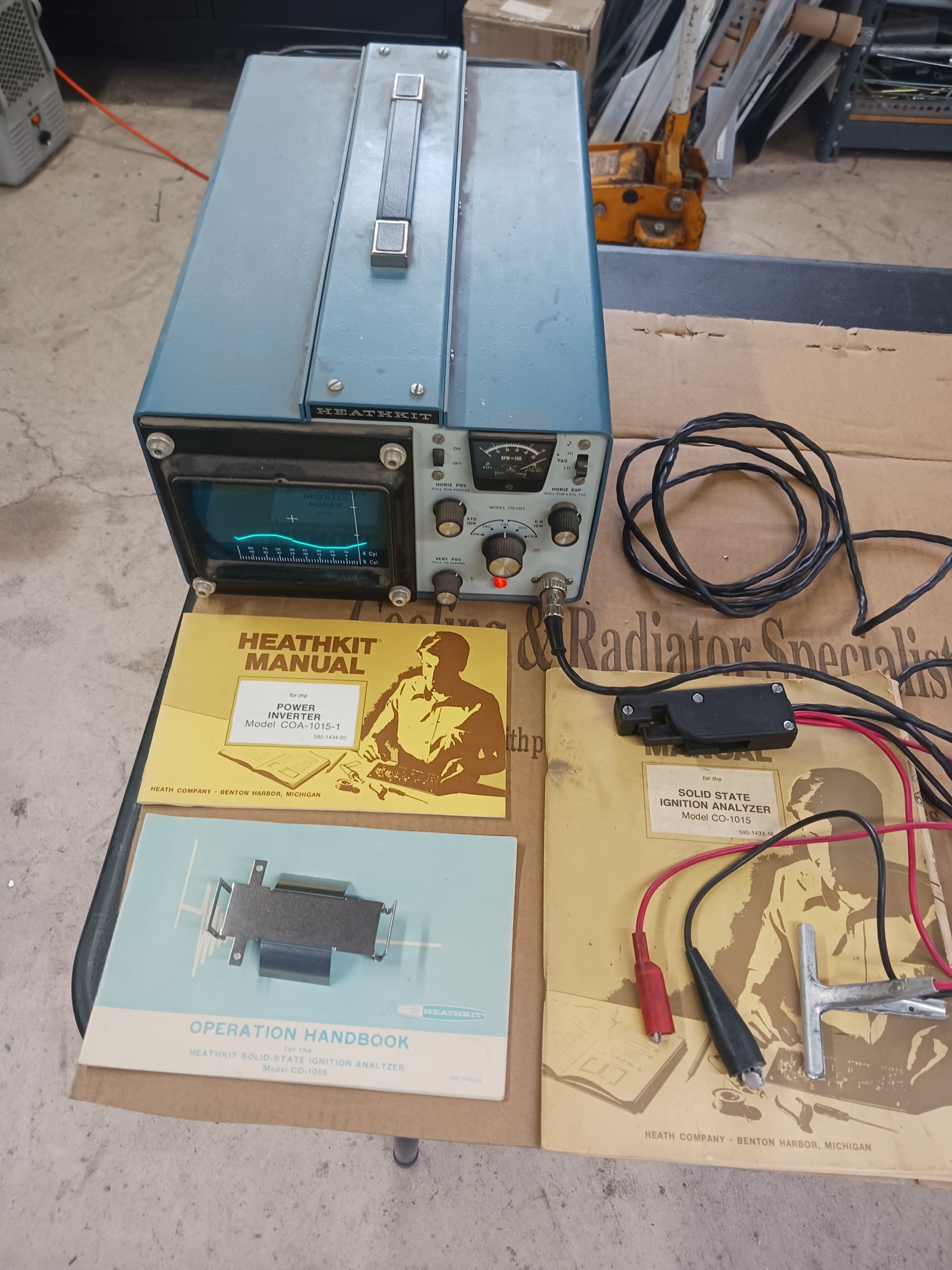

    I have a portable Heathkit ignition ****yzer, with a power supply that plugs into the cigarette lighter socket. Built it about 1980, haven't used it in years.
    Picture taken this morning, it is alive in the calibration mode.
    Comes with the manuals.
    I did not test the power inverter this morning ("Ran when parked").
    I can drop them off.
    I'll PM my phone number (Going out to the shop to crawl under one of my projects...).
    Russ

    While the brakes are apart, I decided to do a quick check of the engine using the scope that Russ brought. Here are a couple waveforms.
    I didn't spend much time on this because the fan belts were off the engine...I should have adjusted the horizontal position and expanse.

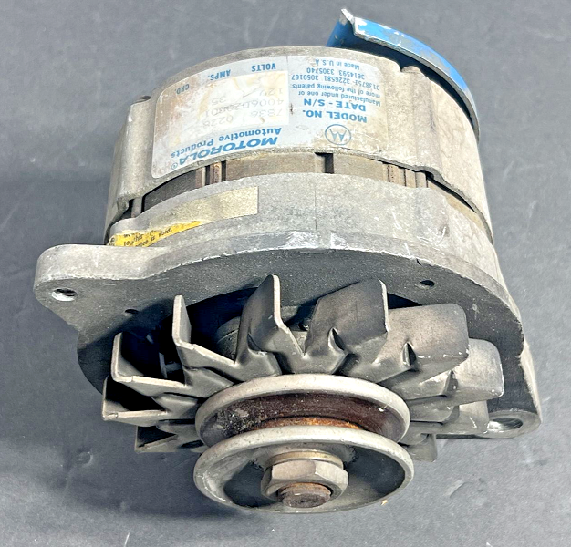

    I also looked at more of the numbers on the parts on the car. It looks like it still has lots of original parts, the carb and starter have the right date codes. The alternator and regulator are Motorola parts, so I don't know if they're original, but they could be. They do have Checker Motors stamped on the tags. No one cares about this, but I think it's interesting.

    I never knew Motorola made alternators. What did they look like?
    bobss396, Deuces and Sharpone like this.
  21. squirrel
    Joined: Sep 23, 2004
    Posts: 60,335
    squirrel
    Generic picture from the internet, but this is what mine looks like. Really hard to get a picture of mine in the car under the power steering pump, etc.

    My '66 Rambler American had a Motorola alternater and a friend of mine has a light airplane with one on it.

    They made a lot of police car items too. Real heavy duty service pieces.
    We would run across them in junk cars sometimes. The rebuilders paid a premium on the cores. Like $15-20 as opposed to $2-4 on an alternator.

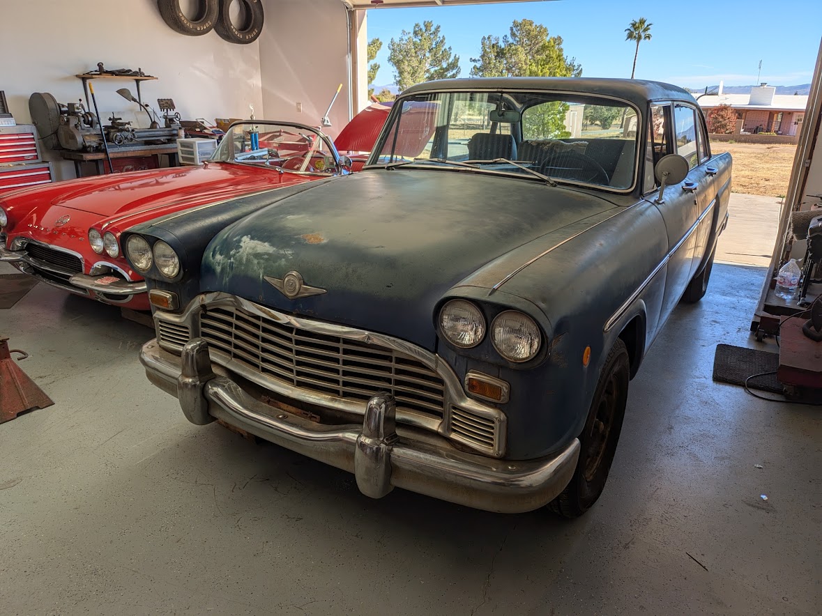

    It's all back together, and driving again. The exhaust is the next big thing it needs. I made an appt with a local shop to bend up some tubes and put a new muffler in next week, we'll see how that goes.
    The engine is running better, although it does 0-60 in "eventually, maybe". I got the idle speed adjusted down, it idles at 500 in gear. Greased the speedometer cable and oiled the fitting on the back, and it operates smoothly and accurately. Fixed the tag light. Even knocked out the big dent in the grill, although the fender is still back a bit where it's supposed to meet the hood at the corner.
