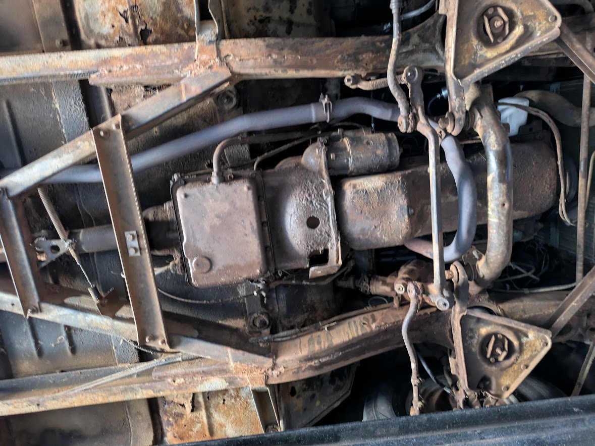

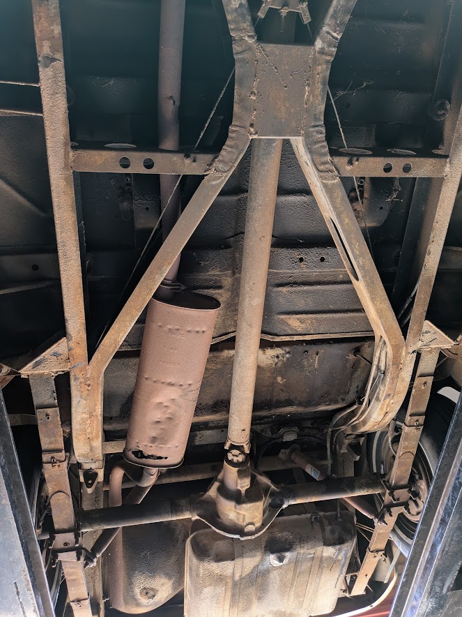

  7. squirrel
    Joined: Sep 23, 2004
    Posts: 60,337
    squirrel
    and the underside...
    brEad, dwollam, porkshop and 9 others like this.
  8. Deuces
    Joined: Nov 3, 2009
    Posts: 26,895
    Deuces
    A new muffler won't make it seem so sluggish....;)
    Or, you could patch that one up....
  9. snoc653
    Joined: Dec 25, 2023
    Posts: 1,038
    snoc653
    from Iowa
    That underside looks all kinds of stout. Stout enough to handle that blown big block. And your blower intake even has a thermostat provision. I spent today figuring out how to mount and route the remote thermostat. I think a blown taxi would be a hit and drag and drives. Go for it.
    porkshop, Sharpone, squirrel and 2 others like this.

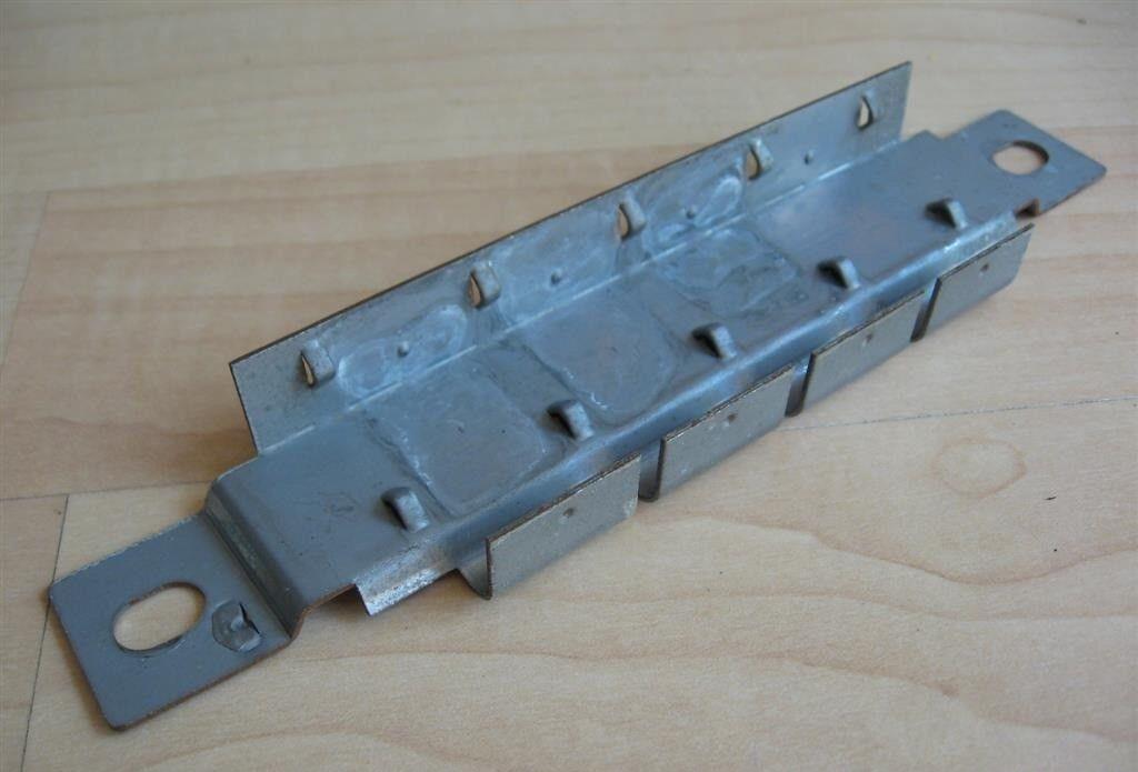

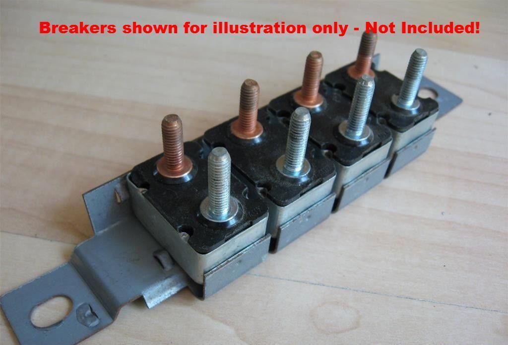

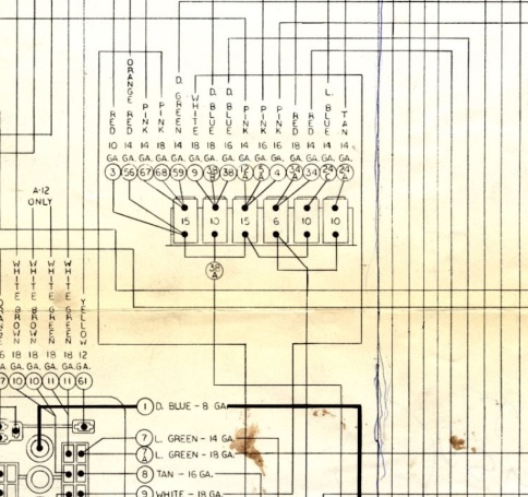

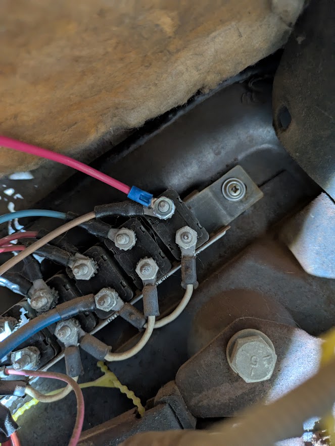

    I've been tinkering with adding accessories, now that the car is mostly working. I added a stereo under the dash, but kept the AM radio in place and working.
    The "fuse box" on these cars is interesting. It's just a series of circuit breakers. The kind that it's easy to attach stuff to. Which makes wiring things really easy. It's tucked up under the dash at the top of the left kick panel, but since it's a roomy car, it's not hard to get to.
    Also I have the schematic from the internet, which I've printed out in big size.
    brEad, porkshop, Sharpone and 10 others like this.

    bobss396
    That looks like a Deutch Block and holder, only with threaded attachment points.
    porkshop, 41 GMC K-18 and squirrel like this.

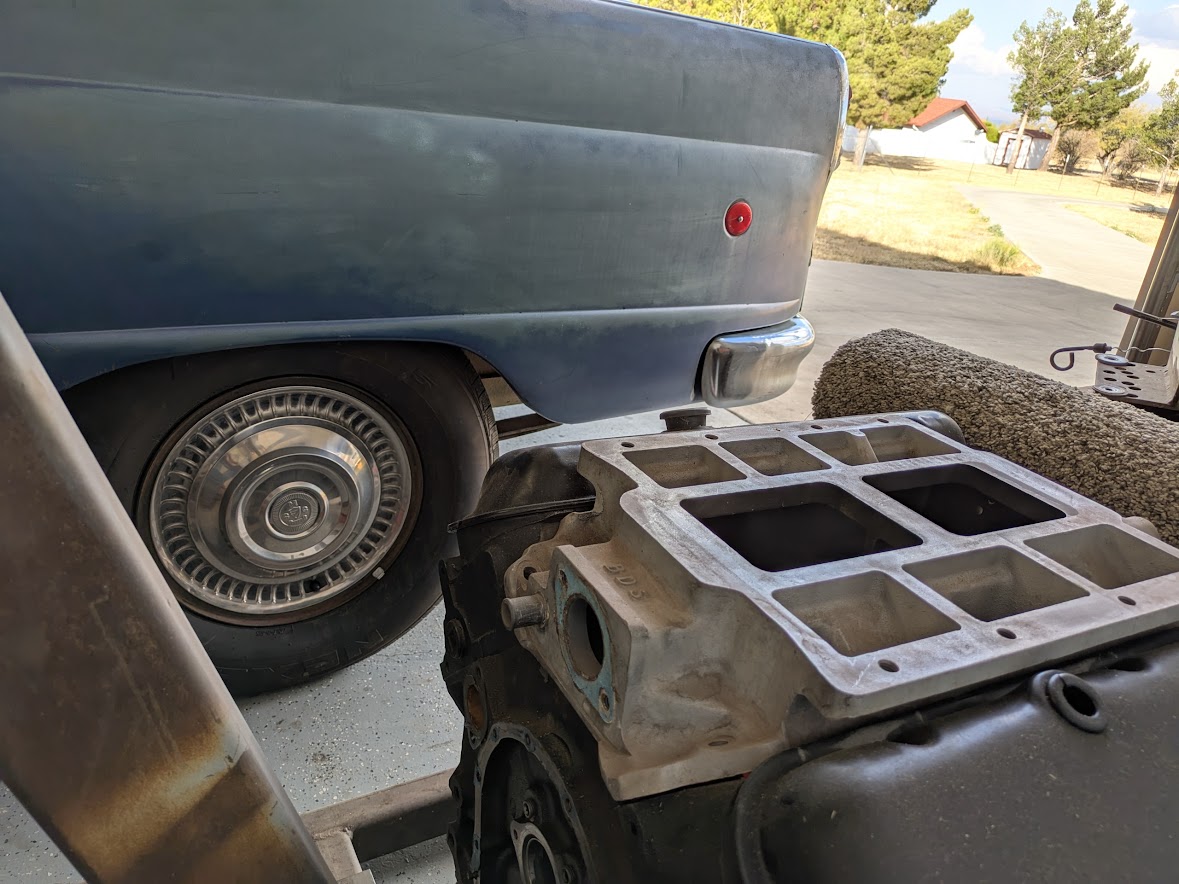

    We'll see what happens. Since I already have a big block powered old truck, and a small block powered sports car, I thought it might be interesting to see what the kids are doing with modern engines. This is a 2002 364 ci truck motor, iron block, aluminum heads. I hear they take well to turbocharging, and also make decent power without doing much at all to them. Of course the fuel system might need some work...either a 3/8" fuel line and low pressure pump if I go with a carb, or a funky pump to handle FI if I go that route.
    Okie Pete, brEad, dwollam and 6 others like this.

    Wondering if there is a 3+ behind it. Hard to tell from that angle. Another gear or more really makes a difference on long trips.
    porkshop and 41 GMC K-18 like this.

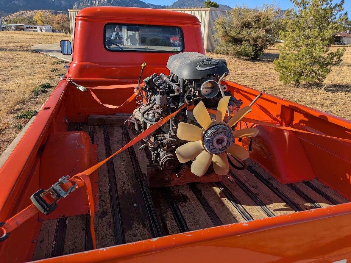

    No transmission with it, it came with a manual. I was thinking about taking the GV out of my truck, since I never seem to take it on trips any more, so I'd put that behind another 400 to go in the Checker. The 3.31 gears are ok, but for going fast with OD it might like 3.73 or 3.92. Lots available for the Dana 44, and the 30 spline axles in it are hefty enough.
    Pulled the engine most of the way apart, it looks pretty good inside, like the 147k miles it is supposed to have. A little bit of condensation rust in a couple bores, but it turns easily after cleaning that out, it's not damaged. No ridge. Pulled one piston out, the rod bearing looks real nice. I expect to just put it back together with a few new parts.
    brEad, porkshop, 41 GMC K-18 and 4 others like this.

    I have never done it, but the kid down the street says if you have the wiring, gas pedal and computer all you need to do is supply them fuel and hook up two wires and they run. The electronics is the secret to make the power. He takes the fuel saver mode out of the computer and it gets about 40 more horsepower. Cam and injector change, are next. That with a Chinese turbo and knowledge of the computer you are on the way to as much as 1000 hp. Without any crazy internal changes.
    As I said that is what he tells me.
