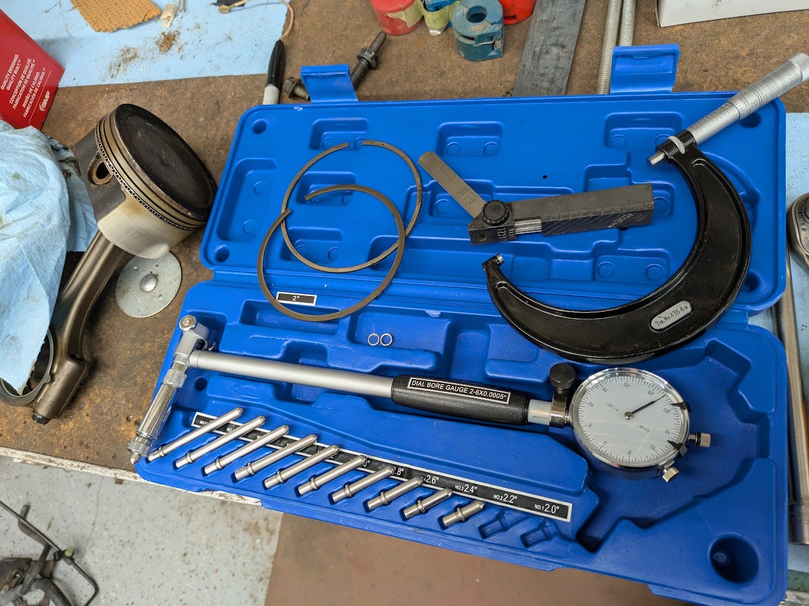

    Anyways, back to the funky engine. It's fun reading about these engines, because guys are all over the place with what works and what doesn't. I tend to go for what is the bare minimum. So....with this particular engine, and what I plan to do with it, it looks like I'll need:
    320 ball hone, to get rid of the little bit of rust residue, and get the bores smooth again. There's only half a thou wear right near the top, which is very acceptable to me. I checked end gap on rings, it has the required 0.028" gap already, so it should be good for turbo use by putting the old worn rings back in!
    New gaskets, just because I like to use new gaskets. Although guys get away with re using them, the rubber does deteriorate after 20+ years.
    A bigger cam. That seems to be the one thing that will make some noticeable power improvement, since everything else has been very well engineered to work as well as it can. The power increase comes from adding duration and lift, so it breathes better at higher rpm.
    I need to inspect the valve train parts, and might need new rockers and pushrods. Noticed that the tops of several pushrods have wear lines instead of shiny ball, as if they'd not been rotating (the lifters don't rotate in a roller lifter engine). More research required here.
    New valve springs. There is a pretty common replacement spring that works for most guys doing this.
    Here is some internal stuff.

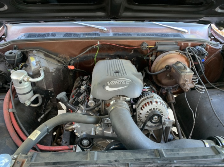

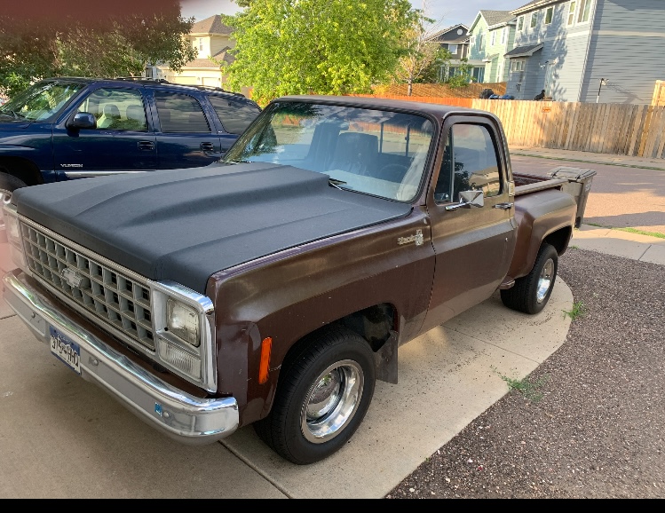

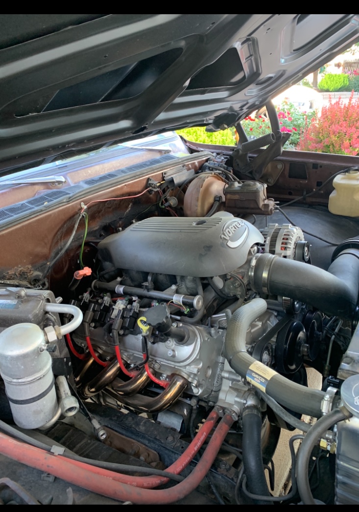

    squirrel
    Looks like a typical "race car", with little thought to practicality. Not what I'm after.
    The opened up the top of the front wheel wells, probably so it would steer after installing the wrong front suspension stuff.
    Okie Pete, porkshop, Sharpone and 2 others like this.

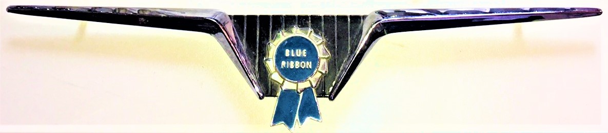

    The bottom picture of the hood badge, was from my Dad's 65 Checker.

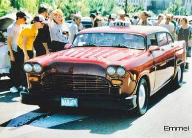

    Found on the book of faces FB_IMG_1732917667069.jpg FB_IMG_1732917674291.jpg

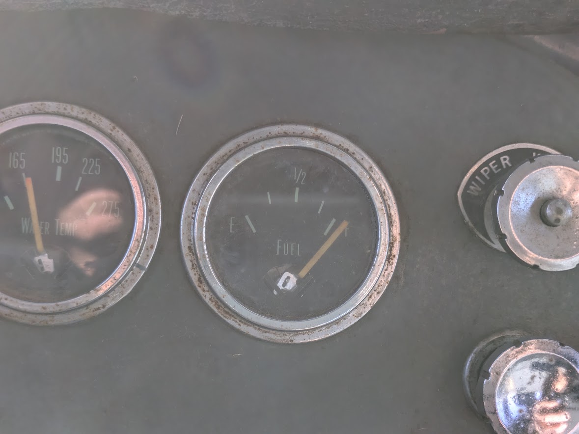

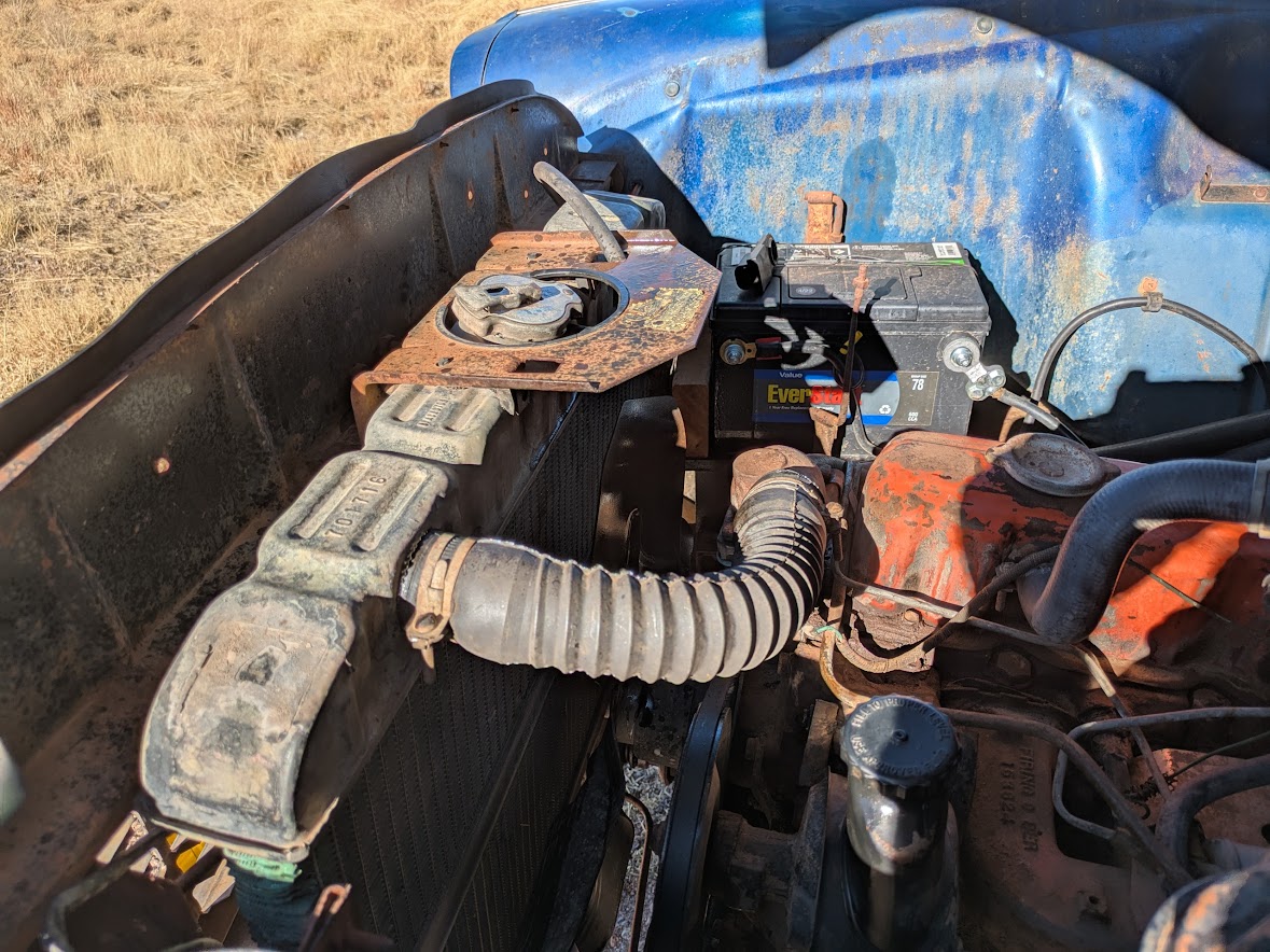

    I got the new cruise control in the mail, and installed it. Went for a test drive, it works! but since it's a warm day today, I found another problem...on the way towards Bisbee, up the long mild grade past the river, it was doing fine, then I noticed the temp gage was going up. It had been at 170, I noticed it when it was 195, and it kept going towards 225. I stopped, and it was spewing and steaming, but it only has a 7 psi cap. It does have antifreeze now.
    After a little while I headed back down the hill towards home, but it got hot again. I let it sit for a while, let the steam out, then drained out some coolant into a jug, and pulled off the upper hose. The thermostat was wide open, so that's not the problem. There's a bunch of stuff partly plugging up the tops of the radiator tubes that I can see, so my guess is that it's just plugged up. The flushing I did probably made it worse, I didn't do the "stocking" trick on this one to filter it out. But the radiator is original and needs to be replaced anyways, so when I finally made it home after another stop and taking the slower roads, I did some measuring and figured out that a 59-68 Belair radiator will be a close enough fit. The top hose fitting is on the wrong side, but I can flip the thermostat housing 180 and it'll fit. Then it'll also be in the right place for the new engine. Just a little over $100 for a new Chinese aluminum radiator. It might get here in a week, ships from California.
    But the cruise control works, which is a good thing. I also filled it up with gas all the way, so I know that the gauge goes past F when it's full, and I can drive 35 miles and it's still a bit over F.

    squirrel
    It had antifreeze in it while it had been sitting for the past 20 years. PO said he replaced the freeze plug at the back of the block, so I suspect others might be soft as well. There was a lot of **** that came out when I flushed the block a couple times.
    There are three freeze plugs on the driver side of the block, kind of hidden by the manifolds and alternator, etc. Might be a good idea to keep a few sheet metal screws with me to try to plug little rust holes as they develop :)
