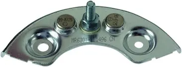

  14. e1956v
    Joined: Sep 29, 2009
    Posts: 2,646
    e1956v
    Alliance Vendor
    This is an isolation diode plate
    You can’t use a diode trio regulator on an alternator with the isolation diode plate and vise versa.

  15. Sharpone
    Joined: Jul 25, 2022
    Posts: 4,766
    Sharpone
    Yep now I remember the Motorola alternator, not sure why I was thinking AC Delco, I guess because of the Chevy engine. Good luck . The 10si alternator is only a little more than twice the cost of the regulator.
    Dan
    Okie Pete and porkshop like this.
  16. Sharpone
    Posts: 4,766
    Sharpone
    Dumb ? What is an isolation diode plate and what is its function? Is it to a sure polarity to the idiot light?
    Dan
    porkshop likes this.

  19. e1956v
    Posts: 2,646
    e1956v
    Alliance Vendor
    To deep for me to get into or explain, isolation diode plate Motorola alternators were usually industrial. I honestly don’t know why they were used. Maybe @Crazy Steve can weigh in cuz it’s over my head. I rebuilt them but can’t answer why Motorola used both systems.

  25. snoc653
    Joined: Dec 25, 2023
    Posts: 1,039
    snoc653
    from Iowa
    It is possible that the new style solid state regulator has the diode plate already in it. In effect you would be doubling the plate drop and affecting the voltage output. A straight hot wire from the battery night fix it. Or byp*** the diode plate on your pink wire. But a newer less complicated charging system would be a better long term fix.
  26. squirrel
    Joined: Sep 23, 2004
    Posts: 60,978
    squirrel
    The diode plate is on the output wire from the alternator, it is not really related to the regulator. The regulator just needs to have the correct internal setting to compensate for having or not having that extra diode in the output. The funky yellow sense wire confusion...they had some setups with an external resistor that would go in series with the yellow wire, I think.
