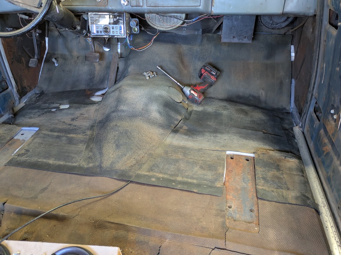

    Anyways...got the front seat out, and the front floor mat, and swept away several pounds of rusty flakes and dirt.
    I'll pick up some 20 gauge steel sheets tomorrow, and see what I can do to fix this. Yes, the shop is a mess.

    moving slowly...rear seat bottom cushion is done, front seat back is done, p*** side floor is done.
  6. WOW @squirrel you're digging deep on this one. Looks like you've got new love affair goin' with it.
