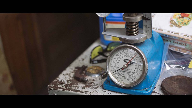

    CHEN

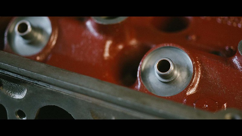

    Went after the heads today. Discovered that the comp cams springs we got didn't fit in the spring seat on the heads, so I had to cut the seat a little wider to accommodate. But also; my cam has a .480 lift and we had about .560 travel in the valve, but with the umbrella seals, which came in around .100, we didn't really have enough travel, so we had to cut the guides down also.
    Decided to cut them so that we can put positive valve seals on the intake and use the umbrella seals we had for the exhaust.

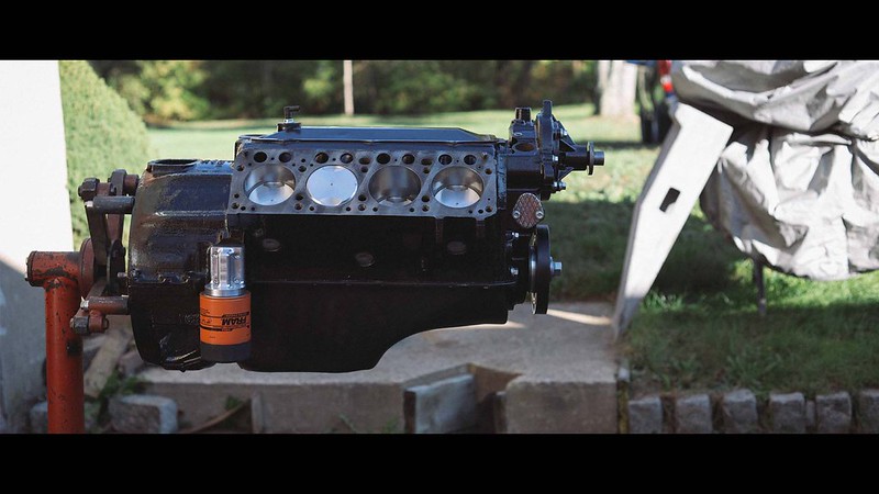

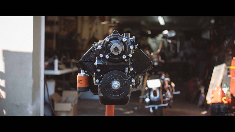

    Got the whole lower end of the motor ****oned up and got the oil pan on. Starting to look like a motor.
    Timing cover and water pump also on, along with the harmonic balancer.
    After cutting the seats down last week, I checked all the spring heights, and shimmed where needed to balance it all out. We're within 5lb. on all the springs, so I'm pretty happy with that.
    All exhaust valves are in. Going after the intake tomorrow; then hopefully heads go on!

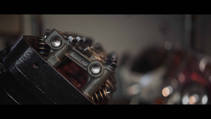

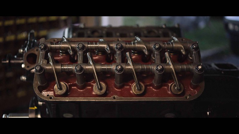

    Heads are finally done. Using ARP studs instead of the original head bolts, except the studs were too long and wasn't allowing the valve cover to go on, so I had to cut the studs down to fit and opted to not use the washers under the nuts. The nuts are flanged, so I think we'll be OK.
    Valve cover fits on the heads nicely now and all is good. Rockers all cleaned and end plugs replaced. One of the rocker shafts was a little loose in the end carrier, so I knurled the end of the shaft to get another 0.0015" on it and press fit it in, all snug and good now.
    Running solid lifters, so got all the pushrods dialed in today. Took much longer than expected; those intake pushrods are a son of a ***** to get to. Here was my cheat sheet to help me along.

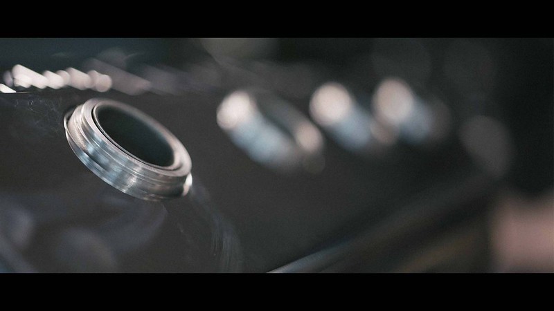

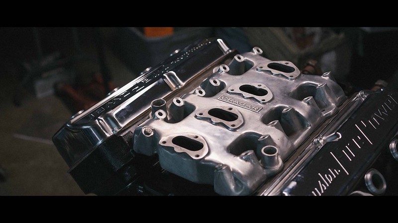

    Got these valve tube seals. I liked the idea of having the o-ring between the tube and the valve cover, but had to do a little machining to get the spark plug boots to sit in there and not pop out. I just back-cut the tube seal housing a little to get that working well.
    I'm gonna be running a 4x2 Cragar intake and 4 Stromberg 97's. Tried getting the manifold on today, but the holes were just a touch off. I ordered another set of intake manifold gaskets and I think the little bit of extra thickness will get us where we need to be to bolt the manifold on. If its still off, I may just oversize the holes.

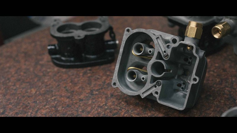

    Bought the rebuild kits to give these old carbs a few more years of life. The the float seat threads in one of the carbs was pretty hurt, but we fixed that by drilling the hole out, tapping it oversize and sleeving it with a br*** sleeve provided by Uncle Max; it worked out great.
    The carbs were put in the ultrasonic cleaner and came out clean as a whistle
