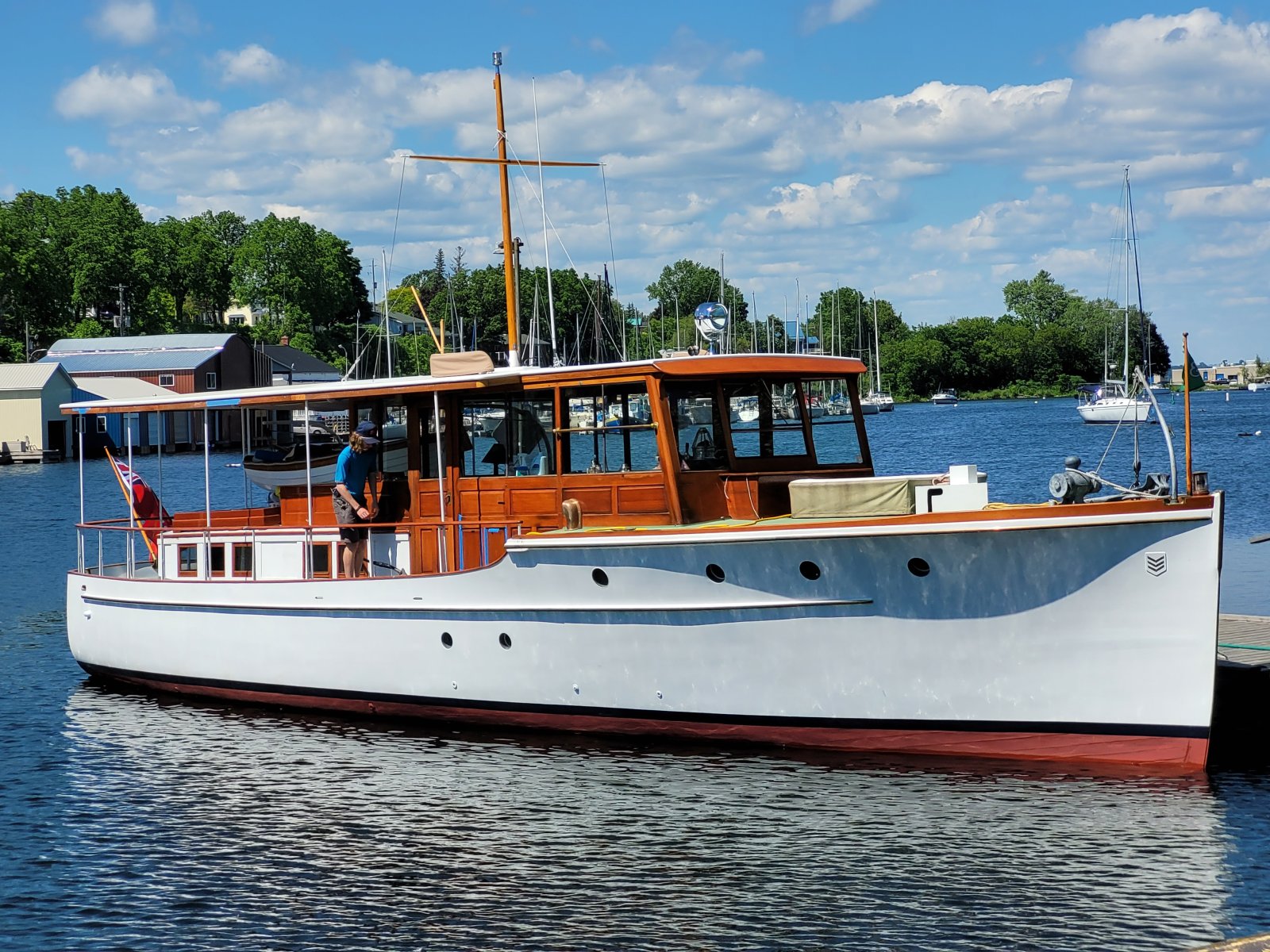

  9. It isn't a car, but here is what those 292's are in. Thanks for the replies, very helpful.

    Gee, while I wish the guy some good luck with his problem, having just discussed the fact that my Street Rod Nationals posts/pictures were just deleted because 2 of them were deemed inappropriate content for the site I have to wonder how a boat is appropriate.

    It's a traditional boat...

    Boat is traditional and passes the age test and doesn't have oversize ugly ass billet wheels. It'ds also an engine question for an engine that fits within HAMB guidelines the first couple of years being fully Hamb legit.

    Guess you are seeing something in the Hamb rules that I'm not seeing.
    Customs says,"The Traditional Custom forum is reserved for threads and posts pertaining to period correct customs only."
    Traditional says,"The Traditional Hot Rod forum is reserved for threads and posts pertaining to period correct hot rods only."
    There are even pictures of what is considered acceptable, and I did not see one traditional boat pictured.....
    Also, when Ryan did agree to "give it a try" allowing tools to become part of the discussion, it was with the caveat that the tools must be something that are applicable to working on old cars.
    As you said, there is nothing wrong with someone asking engine questions, and I hope you guys can help him find an answer............but I disagree that the Hamb is for pictures of boats no matter how old they are.
    The "traditional boat" argument opens the Hamb to all kinds of boats. By that definition I could post pictures of a local historic steamboat known as the Belle of Louisville. Traditional cars have been powered by steam engines and its a traditional boat. Maybe the big paddle wheel out back might not be acceptable though. :p
    So, just havin a little fun here by pointing out that while discussion of an engine might be acceptable, I think you are wrong about posting pictures of boats.
    @Moriarity said "the key to the whole thing is we need to keep the off topic stuff off the site, once the floodgates are opened this place would turn into a street rod site and nobody wants that..."

    Moved to the antiquated forum. boats are off topic on the main board
