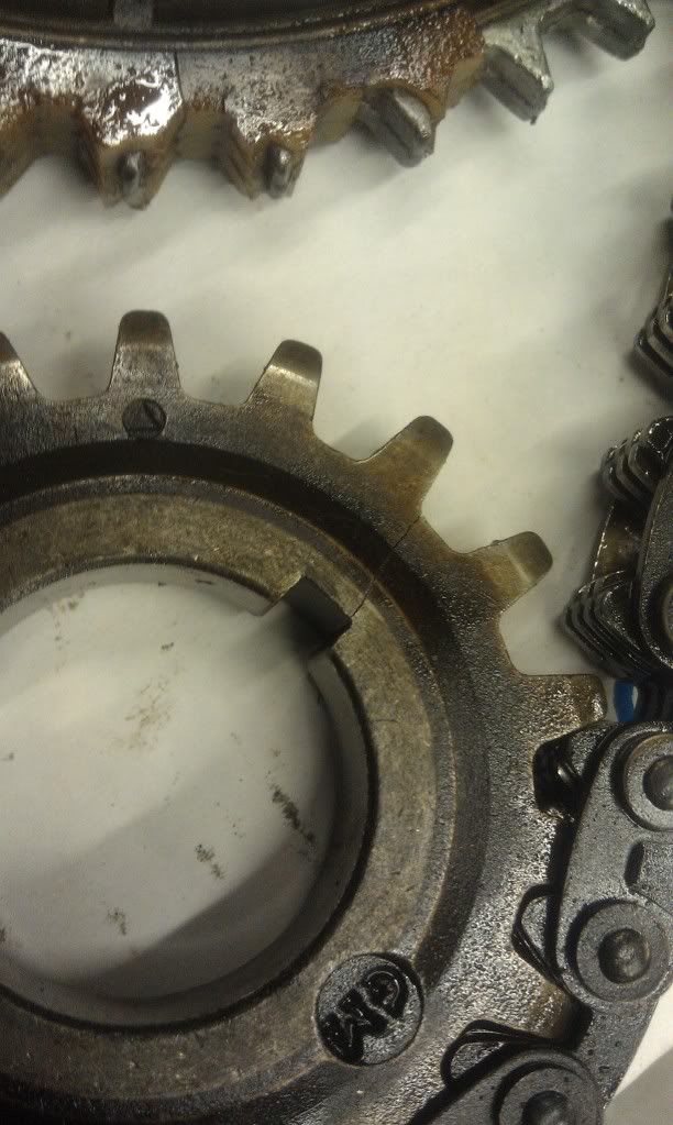

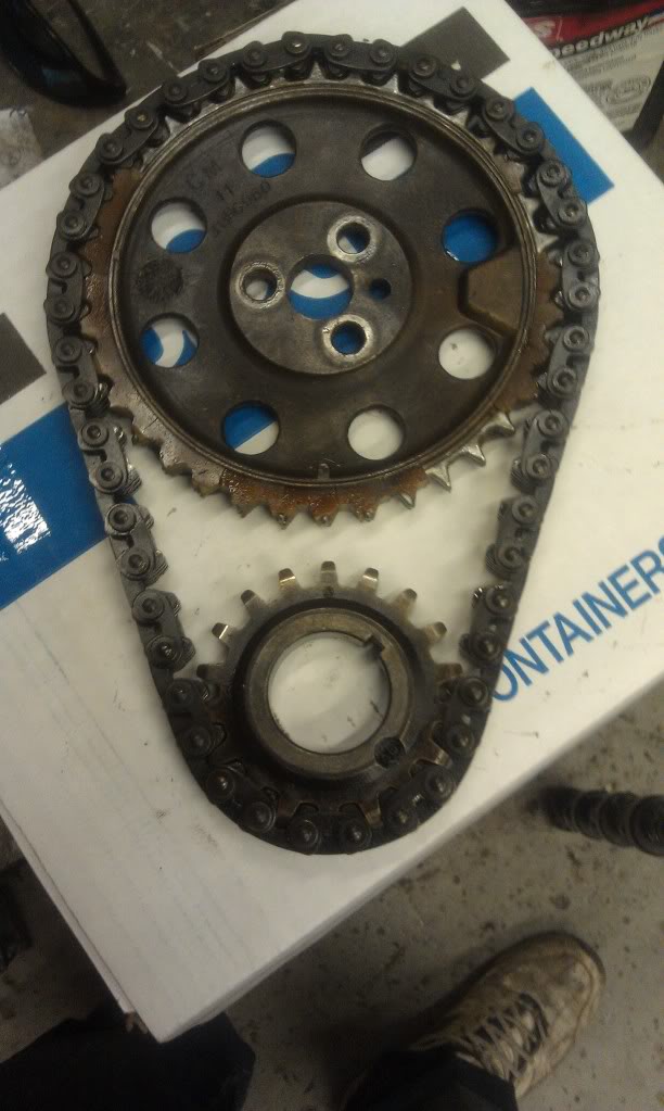

  11. This 307 timing set was running just fine, no real indication of an issue.
    Most of the nylon is gone, and the crank sprocket was cracked.
    Hell all that nylon chunks could be plugging up his oil pick up screen :eek:
