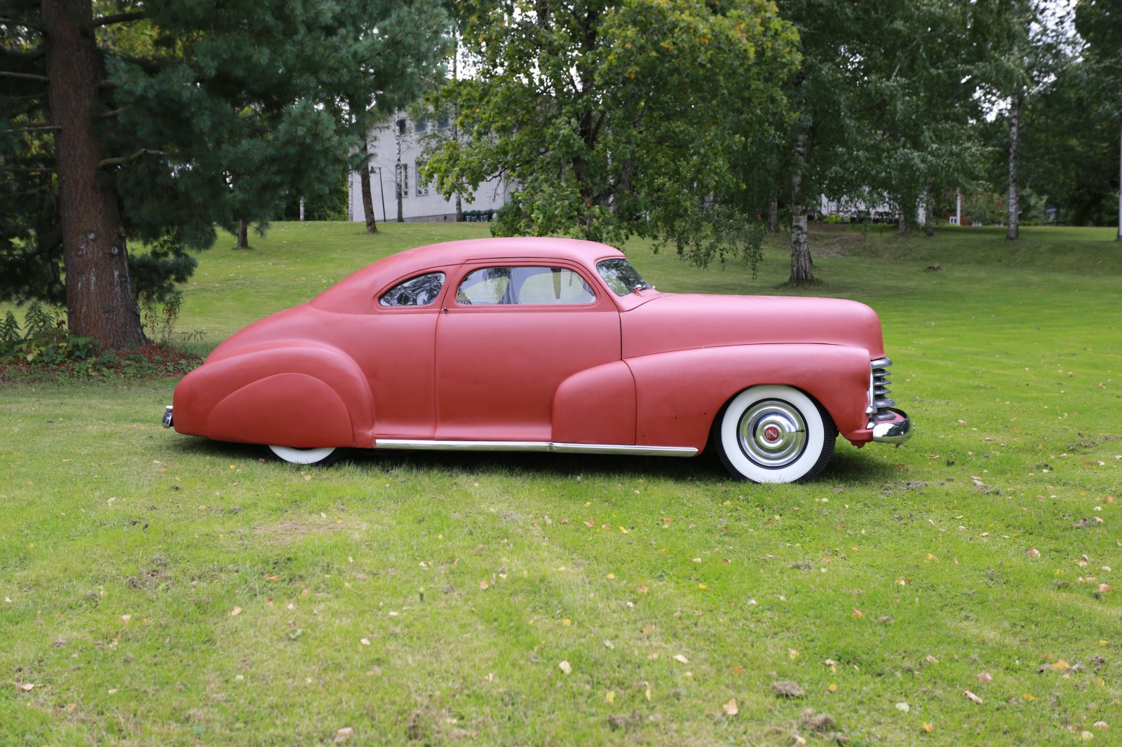

    I'm quite new owner of 1948 Chevrolet. I have tried to look better solutions to replace original steering gear... Is there any reasonable price or easily to modified parts available?
    It has original front suspension and steereing gear.
    Mustang II is NOT an option!
    Attached is the "patient"
