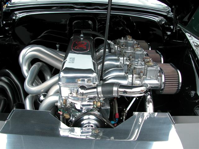

    Possibly you could build it like this...
    come out level from the intake ports with 3 steel tubes.
    these 3 steel tubes merge into a steel plenum box who's size is about 8 '' X 8'' by 6 '' deep,,, the plenum box is divided internally with a 8 X8 plate ( so the box has a up stairs and a down stairs ( two spaces 8x8x 3 ). the 3 intake ports merge into right side of the the Downstairs stairs plenum.
    the 3800 super charger mounts up side down to the bottom of the plenum box, and blowes thru the bottom of down stairs plenum, the downstalrs plenum flows into the 3 intake port tubes.
    Out of the the Back of the 3800 blower ( the Inlet side ) comes a 3 '' tube bent in a tight 180 bend . this 180 tube runs UP to the up stairs plenum and hooks into the back wall of the up stairs plenum.
    The flat roof of the up stairs plenum is machined to accept you chioce of carbs...( maybe 4 one barrel carbs) ...
    so the air flow is like this
    carb to upstairs plenum
    back of upstairs plenum to 180 degree 3 '' tube
    down the 180 degree tube into the back of the 3800 SC ( inlet side)
    from outlet of the 3800 Sc to bottom of down stairs pleunum.
    from the right side of down stairs plenum into to the 3 horizontal intake ports

    Already done that on 250-292s been driving one for five years. The late Eaton from 3800s is harder to mount than the earlier T-Bird but can be done . The finished product is kind of ugly though. There is no need to run different pulleys. Eaton has a by p*** for non boosted driving. It takes less than one h.p. to turn blower when not in boost. I turn the blower on my truck pretty fast(3 to1) but can still cruise about 75mph without going into boost.On 235 cubes an Eaton M-90 will make over 10 lbs. boost. If the engine only made 150 h.p.(not too hard to do with cam. headers and good exhaust.) The added boost would make the total h.p.about 250. 3800s only rise about 50 h.p. because they turn the blowers very slowly. As I said I have been driving my truck for 5 years @10-12 lbs. boost and I run the hell out of it. The torque produced is phenomenel. One customer we boosted could not even turn his tires unboosted . With 6 lbs.boost the same car could fry the tires down to shreds.Picture shows blower mounted on right side so that all stock brackets could be used for power steering etc.
    235 installation would be very similar.
