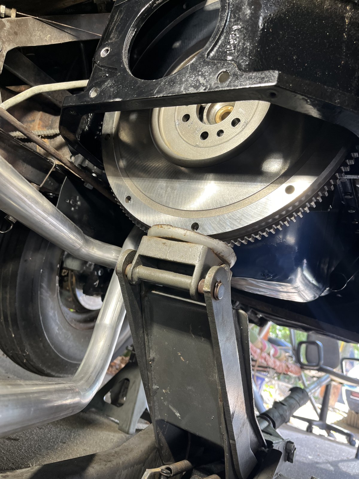

    What’s up folks. I was wondering if anyone had a Napa part number for an 11” Heavy duty clutch Kit that would fit a 53’ 235. At this time I can only find 9”. I installed the bigger HD flywheel not realizing how much more tedious it is tracking down a clutch kit. Might have to swap it out with a standard flywheel and buy the more readily available 9” kit . Thanks again for the feedback

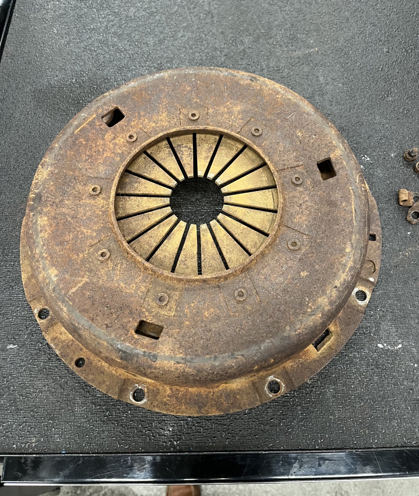

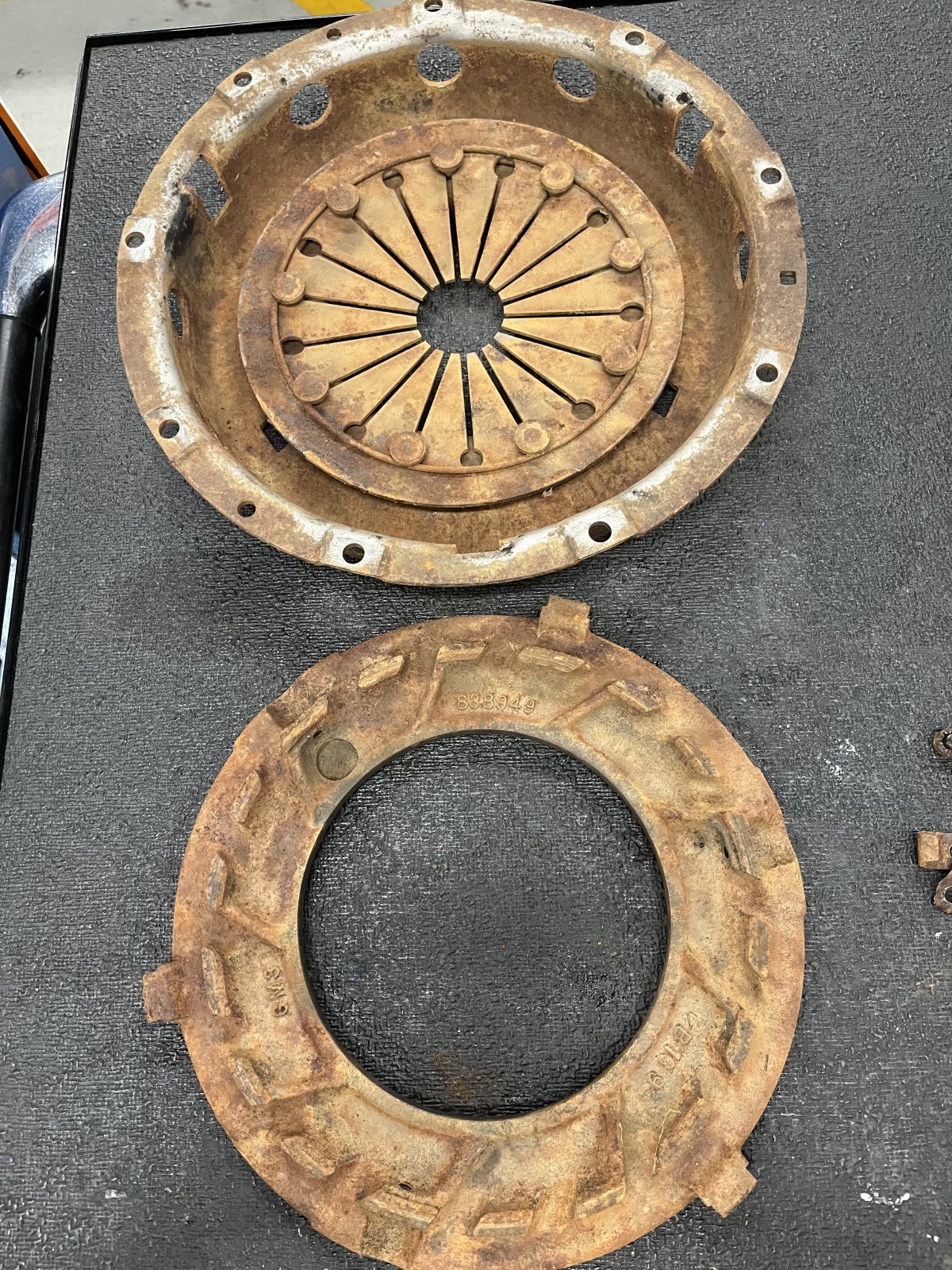

    The flywheel I’ve installed has 139 teeth and 9 mounting holes for the pressure plate. Can’t seem to locate a new pressure plate. The original I’m using for reference has bent diaphragm- not useable. The clutch disc (not pictured) measures 11” .

    That's actually a 10 3/4 inch setup. The only vehicles that used that pressure plate were Chevrolet trucks and Studebaker trucks.

    Good luck. As Heathen said probably a 10 3/4" not a 11" and those seem to be next to impossible to get. I spent a lot of time and ordered 3 different clutches that were "guaranteed fits" and not a single pressure plate worked. Had to have mine rebuilt eventually. Even spoke to the clutch manufacturer directly and was told what would fit and it didn't. If yours can't be rebuilt take the advise and switch the parts out so you can run a different clutch you can actually get parts for.

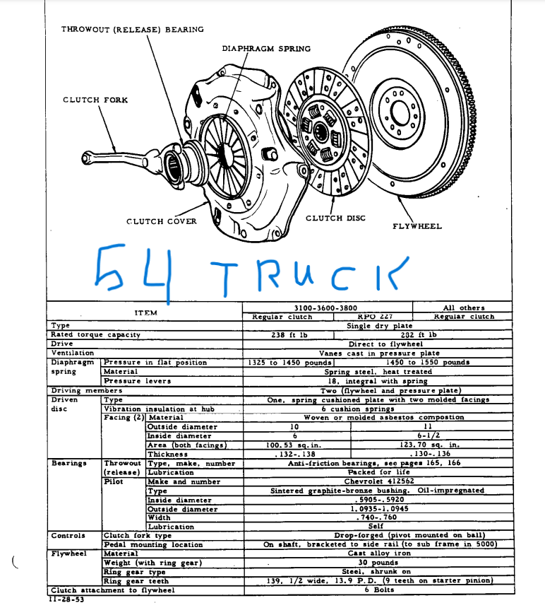

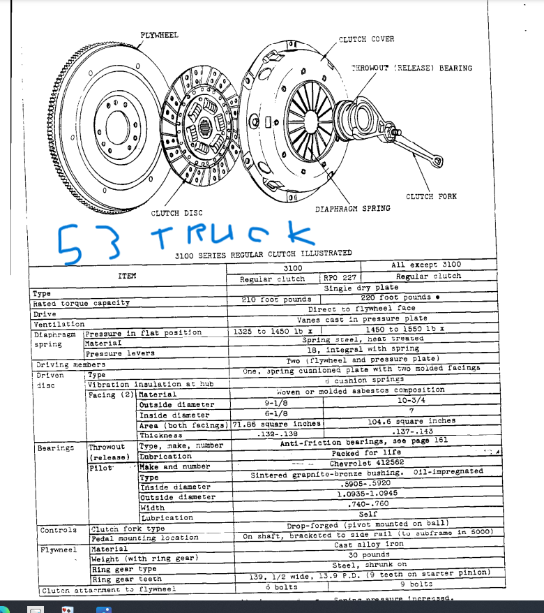

    About the only way to get an 11 inch truck for the 53 would be to use the clutch and flywheel for a 54 truck that still used a 139 tooth ring gear but I am not sure at all that the 11 inch pressure plate will fit inside the 53 Car bellhousing . The Chevy truck bellhousing won't work because the mounting setup is entirely different and 48 and later trucks use the Muncie bolt pattern for the trans rather than the smaller earlier bolt pattern. 53 trucks used a 1o-3/4 clutch for 3600 and larger. Those have a 9 bolt pressure plate. Screenshot (972).png Screenshot (973).png

    The engine came out of 1953 Chevrolet 3800 cab & chassis truck. That probably explains how I ended up with a 10” 3/4 inch pressure plate/ clutch combo like the one in the pictures you posted. I swapped out flywheels this morning with one that has more easily accessible clutch kits
