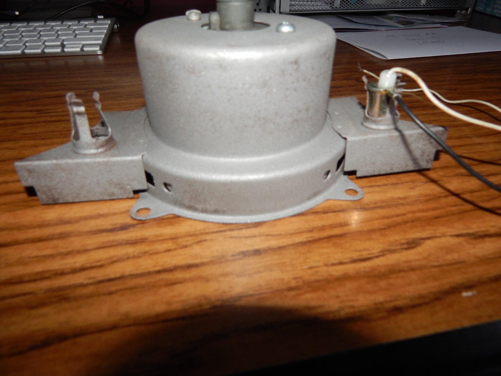

    My '37 Chevrolet has terrible dash lights, and as I get older they get harder to see. This how they work, two bulbs on each side, with a slot for light to pass through, the side gauge pods have the same slots. I have them painted white, new T1893 bulbs, voltage is good, no dimmer switch, grounds good. This one shown is a spare, they bolt flush to the back of the dash panel. DSCN0981.jpg

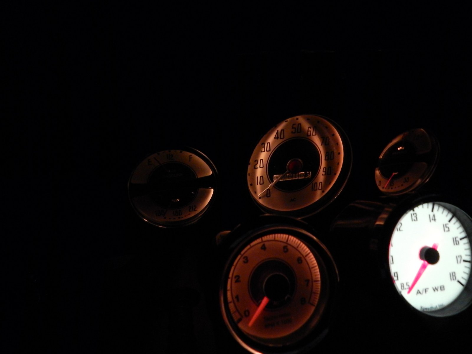

    Here is how they look in the dark. I don't worry about the tach, it's a cheap-o with crappy lights. DSCN0975.jpg
    I'm thinking maybe an LED strip around the inside of each pod, or individual LEDs. The LED replacement bulbs would have the same problem with the slots. The wideband really stands out when lights are on!

    get rid of the WB display, for starters. You don't need it once you've adjusted the carb properly with it. Getting rid of a bright thing near the dim things will help visibility.
    Do you have any idea what the plastic material over the slots was like? Perhaps it was there to diffuse the light, and keep it from having the bands that make it hard to see things. If so, it probably had a translucent matte texture?

  10. Assuming you have the correct bulbs (volts and watts) it could be the original plastic lenses had a skirt that hung down to the light slit. This would be so the lens would "bend" the illumination up around the corner and across the gauge face in sort of a fiberoptic effect. If you by chance have replacement clock/gauge lenses that don't arch all the way down to pick up light from the slit, that might be the problem.

  14. Did you spray the inside of the housing with white or silver paint? That would help spread the light supplied, around the whole backside of the gauge face. It should then help light up the front.
