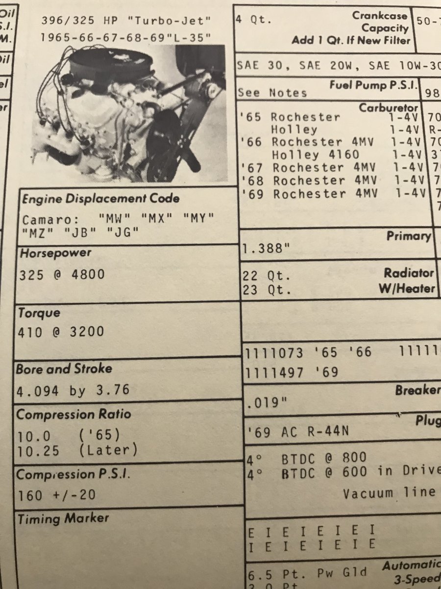

    Thank you. This is a cast iron distributor. There is another number on the band, but it is illegible. I apologize. Upon more careful reading, the band number is 1111073. Anyone happen to know the year of that distributor? I saw a code book once that lists all distributors (cast iron and aluminum) by the serial number, but I cannot find it on the internet. Thank you.
  4. Fordors
    Joined: Sep 22, 2016
    Posts: 6,577
    Fordors
    60187F6D-B26E-445C-B8C8-B68DFACB8C14.jpeg 6A39156A-C8F7-4C2F-A4ED-73CF5A0E5A79.jpeg
    1965-‘69 396/325 horse.

  5. mwhistle
    Joined: Feb 19, 2007
    Posts: 314
    mwhistle
    from sacramento
    Fordors, thank you very much. Perfect.

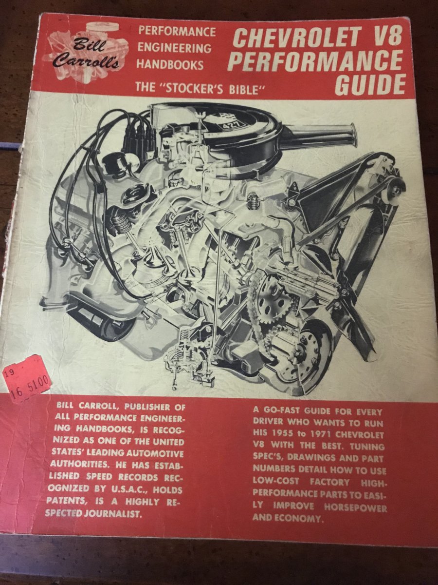

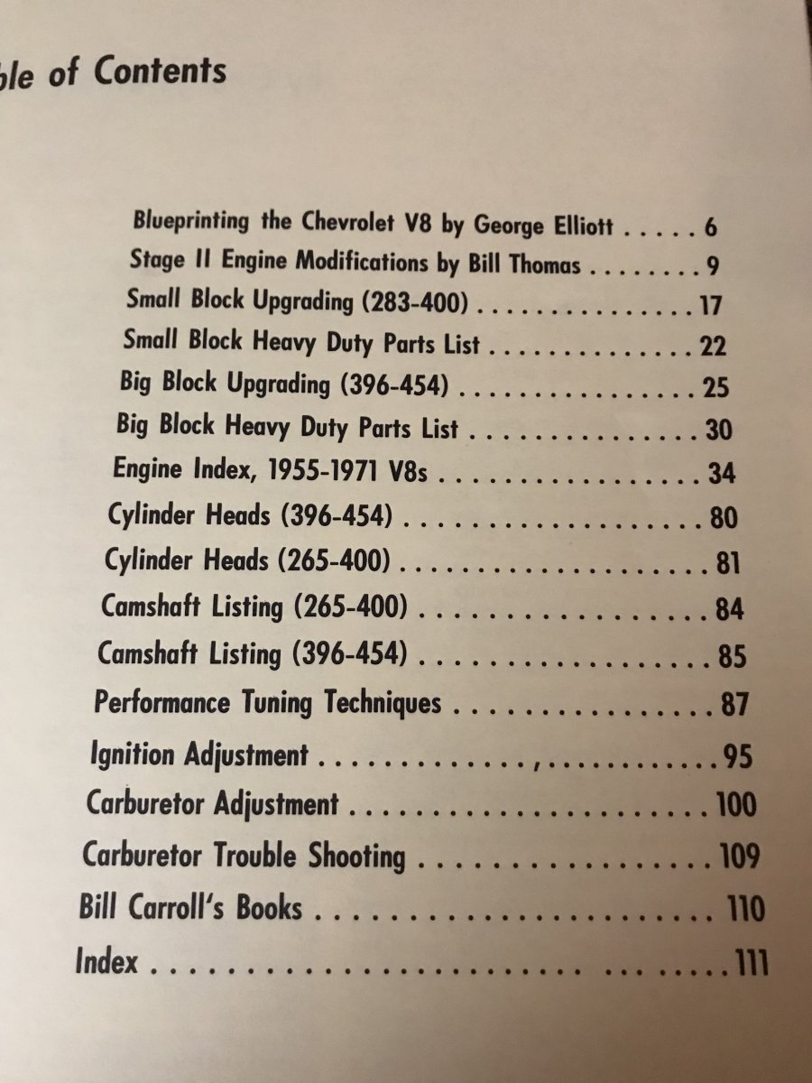

  8. Fordors
    Posts: 6,577
    Fordors
    0CA599FC-646B-42FF-B774-064761D4C783.jpeg E6242C4C-9B87-47AA-A15C-7A9BC9A58ED8.jpeg
    Soft cover, 8 1/2 x 11. My edition was printed in 1971 and includes those engines, the first edition was printed in 1965.

  9. tomcat11
    Joined: Mar 31, 2010
    Posts: 1,156
    tomcat11
    Priceless! Thank you. If I ever see one I'm going to grab it and add it to my collection of reference material.
