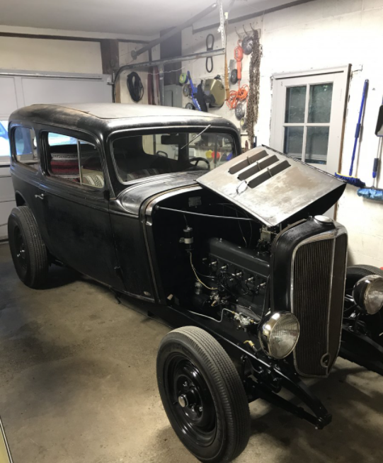

    Just finished and driving a 33 Eagle Coupe,original front axle and springs converted to disc brakes and cross steering. Nailhead Buick engine and SP turbo 400 with ot C2 rear axle. I have cardboard patterns I could send to box frame rails if that helps. Unless you are doing a concourse restoration I would not be worried about finding parts and pieces if body and doors are usable. I understand your location can be difficult to find stuff,but there is a lot of aftermarket parts for Chevys or anything can be fabricated. Sure lots of Fords but to be different with a Chevy! I hope it can work out for you.

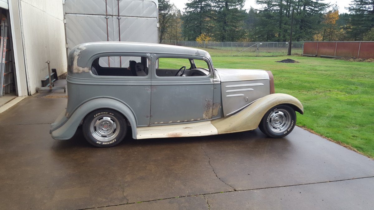

  15. These early 30 Chevy's are nothing but a Wooden Apple Box inner structure with Tin cladding nailed over it. No kidding at all! This is a 34 and yes it's a Hot Rod I guess. There is NO way in HELL I would ever do this again. No matter the step in price RUN my friend Run! You won't know what little pieces are missing till you go looking for it. Then you'll learn it's one of those that just fall off while driving due to the nails falling out and you can't find another one. 20171116_083704.jpg
    Behind what you see above here is where I started. The Gray primed Body Panels are all that are metal in this car. All the new raw steel was Wood including the main lower Body Beam that runs front to back and mounts the Body (such as they are) to the Frame. If you look close you can see the nail holes that attached the body panels to the inner structure. Now, I'm calling them Nails but in fact they are nothing more than Carpet Tacks and a million of them. The Door skins are exactly that and nothing more a Skin. Do I sound Opinionated? Yes I am only because I have actually done the work myself.
    I could have built several other cars in the time spent on this one with far less grief. Lot's of better choices out there.

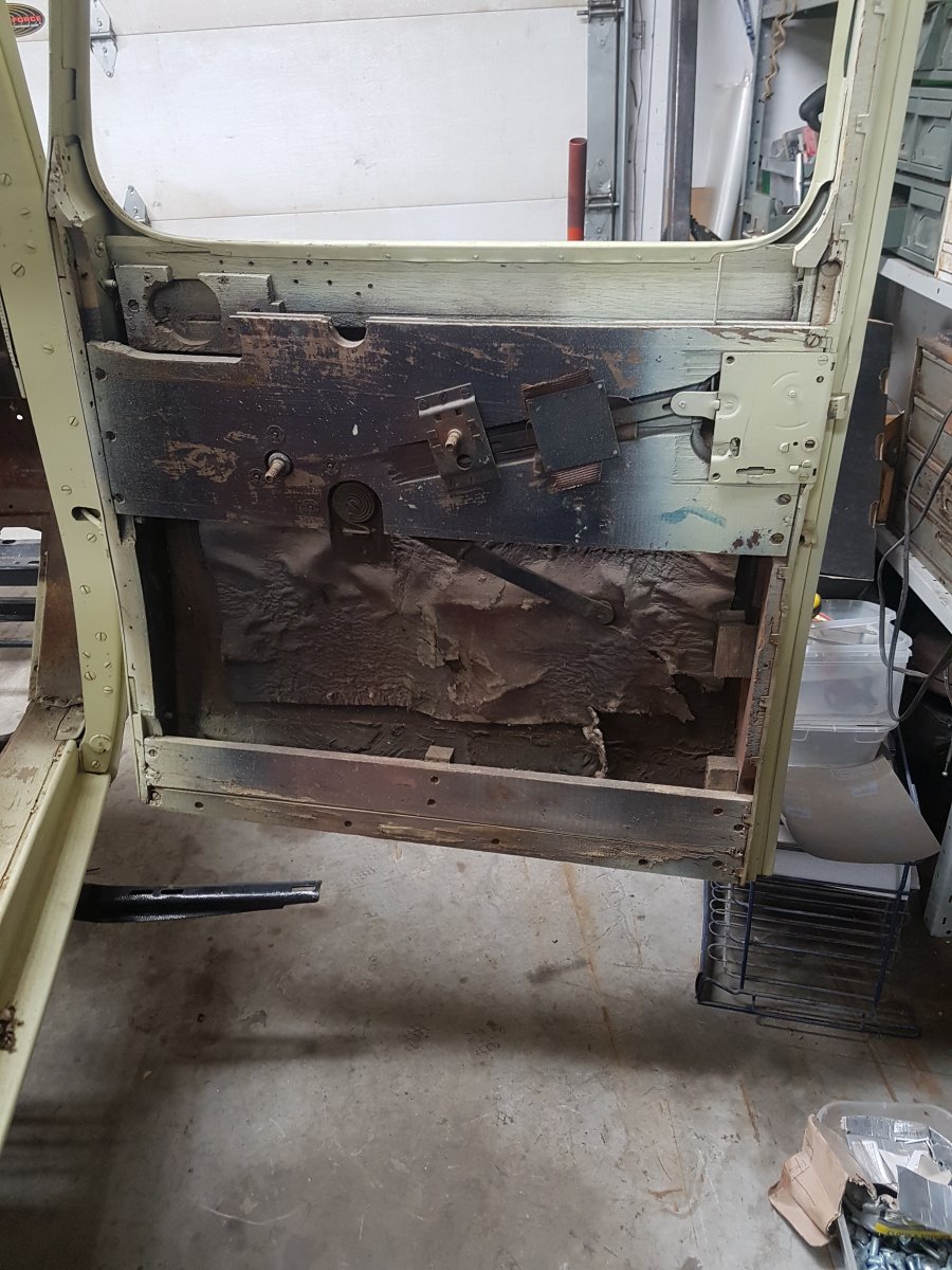

  27. If all the sheet metal is good , have doors and sills , sills are important !!! The wood or metal can be fixed . I wouldn't back away . 20180217_001045.jpg 20180216_205632.jpg 20180216_205618.jpg 20180216_205609.jpg 20180217_001034.jpg 20180217_001050.jpg 20150811_215444.jpg
    chryslerfan55 and kidcampbell71 like this.
