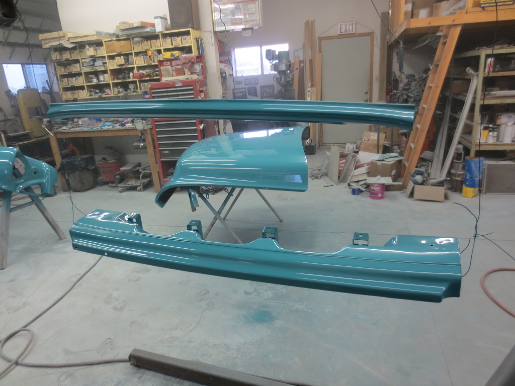

  9. squirrel
    Joined: Sep 23, 2004
    Posts: 58,756
    squirrel
    pics of the differences. The 57 grille sits in front of the grille opening. The 55-56 grille sits inside the opening. So the 57 opening has bolt holes around it, while the other does not. The 55-56 lower panel also has little stands that the grille bolts to, the 57 panel is missing the stands, and has holes further forward.

    Thanks again, Squirrel for the good Info! I had no idea about the differences in the mountings of the grills and I am very grateful for your helping me. I believe that I have a passenger side fender that appears to be a 55 or 56 fender. The top portion next to the hood where the grill would bolt up to is a 57 and so is the driver's side fender. However, I do not have the bottom piece (I guess it is called the valance)that the 57 grill bolts onto. So with these mixed/matched parts that I have so far on my truck, what year grill would you be looking for that would look factory and not be a royal pain to install as I am not what you would call "Experieneced" with modifications whatsoever? A 55-56 grill or a 57 grill?
  12. squirrel
    Posts: 58,756
    squirrel
    57 will be easiest to install, it will cover up any work you have to do to the mountings. Also it will fit on the 55-56 lower panel that has the towers, it just won't use the towers.
