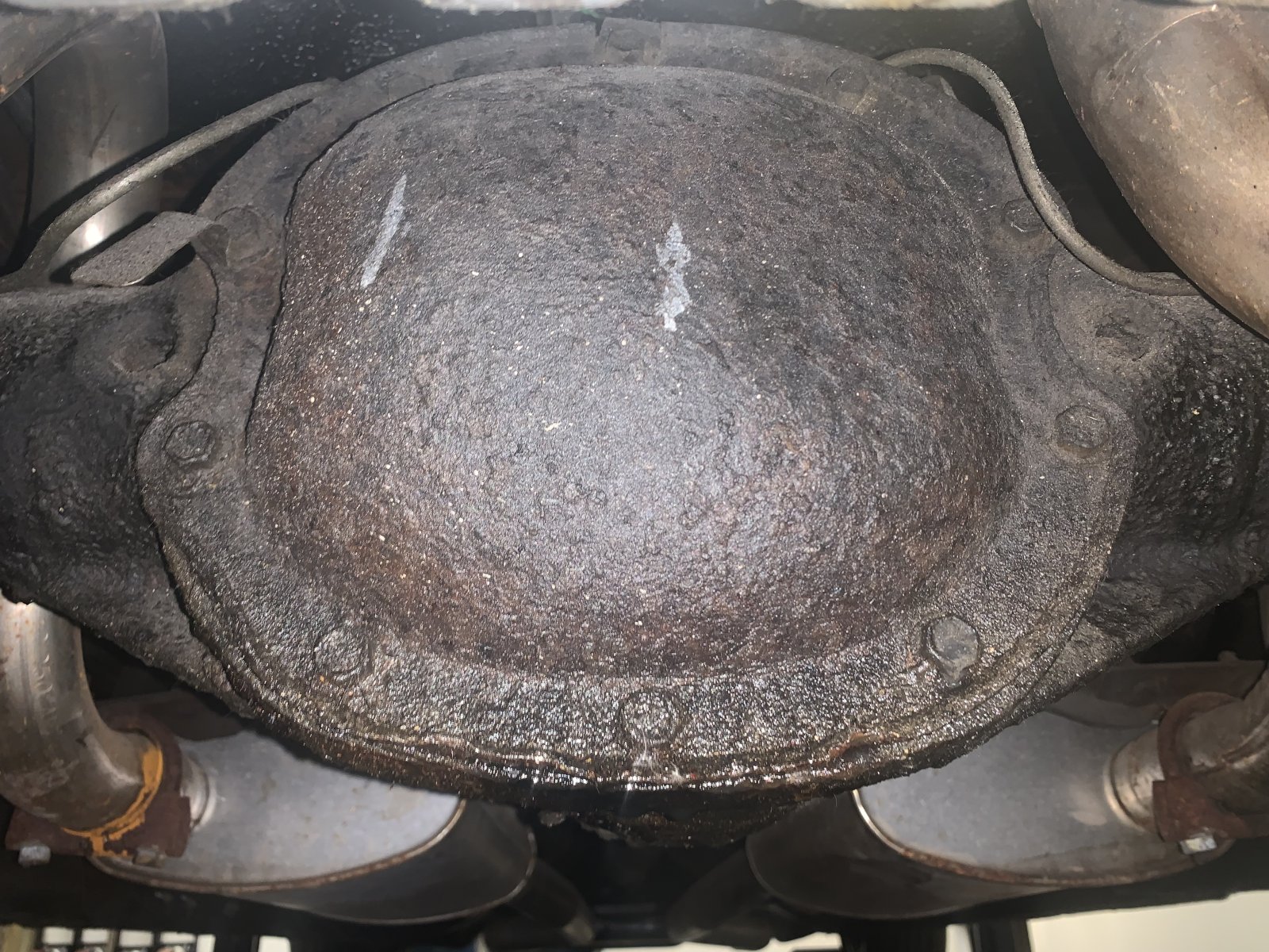

  1. This might be a stupid question, but here I go. I’ve got a Buick 10 bolt posi differential. I need to replace the cover gasket as it’s leaking badly. Is the Buick 10 bolt cover the same as a Chevrolet 10 bolt cover? I’m having trouble finding a cover gasket when I search for Buick 10”.

    You may want to sand blast the outside of the cover and see if there are any pin holes in it. If no holes, give it a good coat of paint. Looks mighty rusty.
    lumpy 63 likes this.

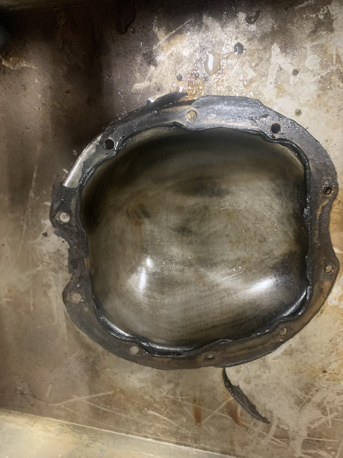

  14. Well, I think I know why it was leaking……
    Unfortunately I couldn’t find Right Stuff up here. I bought some Parmatex Ultra Black which I also read good things about. How do you lay down the RTV on the cover? I was thinking down the center of the flange and then inside of the bolt hole? How big of a bead do I put down.
    This is the first time I’ve “serviced” a rear diff. Is there any need to clean the diff/housing before I ****on it back up and put new oil in it?

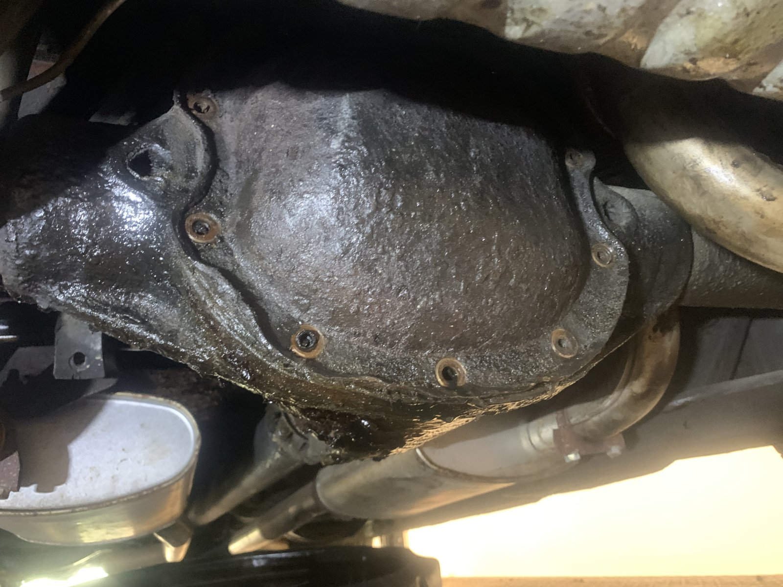

  15. I’m definitely going to give it a good cleaning. From the inside the cover looks good. The car threw a rod before I bought it so the entire underside of the car is coated in oil. Between that and the leaking cover, it looks like most of it is oil buildup. I’m soaking it now.
    Allan

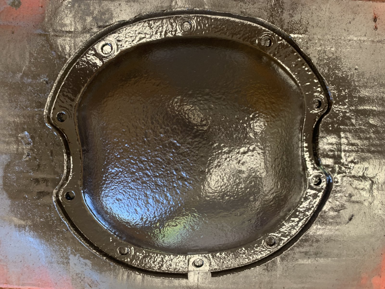

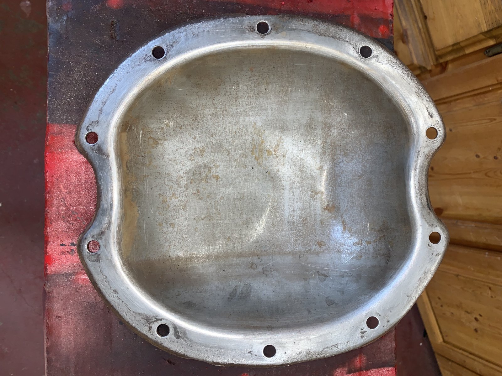

  19. I’m heading to St. Louis in a couple weeks and need to get this back together so I can get it off the lift and get everything organized for the winter. There are no covers available in Canada and there was no guarantee I’d get one ordered from the US in time, so I ended up cleaning up and painting the existing cover. A replacement would have been the best solution, but I think this will work. The cover is still really solid, just not pretty.

  23. bill gruendeman
    Joined: Jun 18, 2019
    Posts: 944
    bill gruendeman
    Check to make sure it’s flat, it looks like it has bends on the lip. I have all ways had a problem with the covers weeping with rtv. so last time I used a blue fel pro gasket and per instructions both surfaces clean and dry, no leaks in years.
