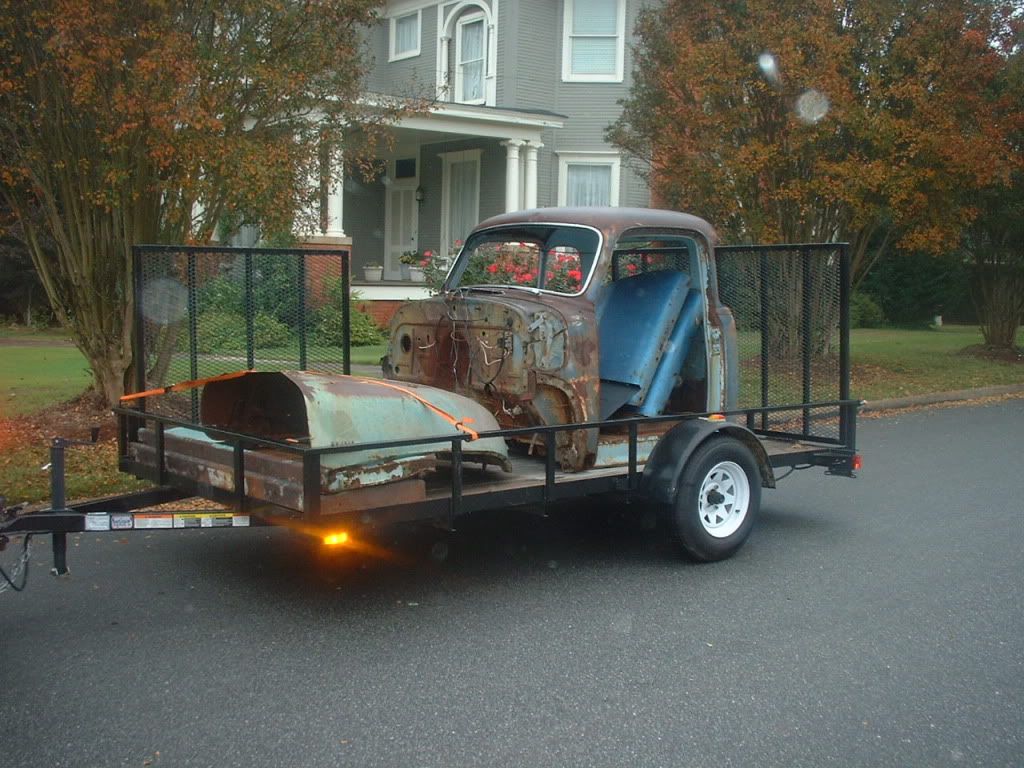

    I had a deal for cab and doors and glass for $200.00... He ended up giving me complete bed and hood. Also for another $100.00 all for fenders I am picking those up later...

  13. Looks really nice... I been doing some researching and I think what I like best is chop and section together. No just a chop. I am going to start doing other parts of the project first before I start cutting just to make sure I am doing what I really want...
