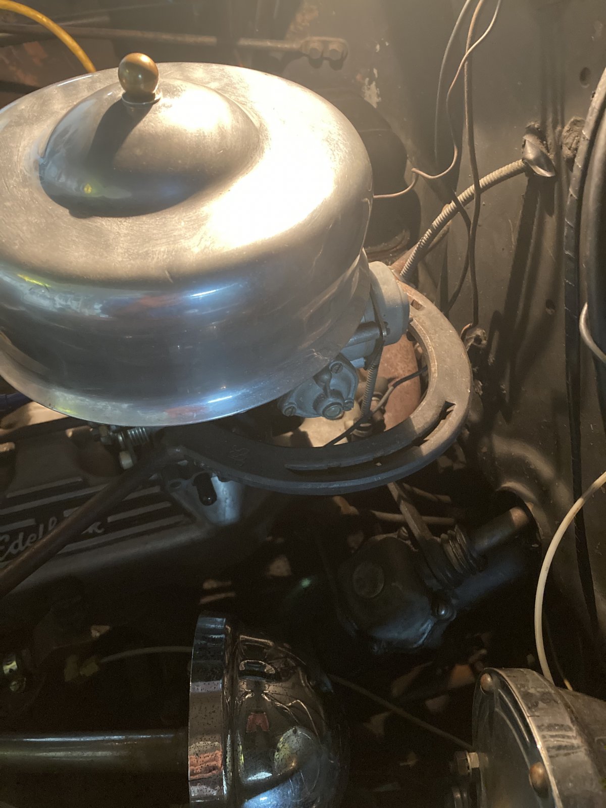

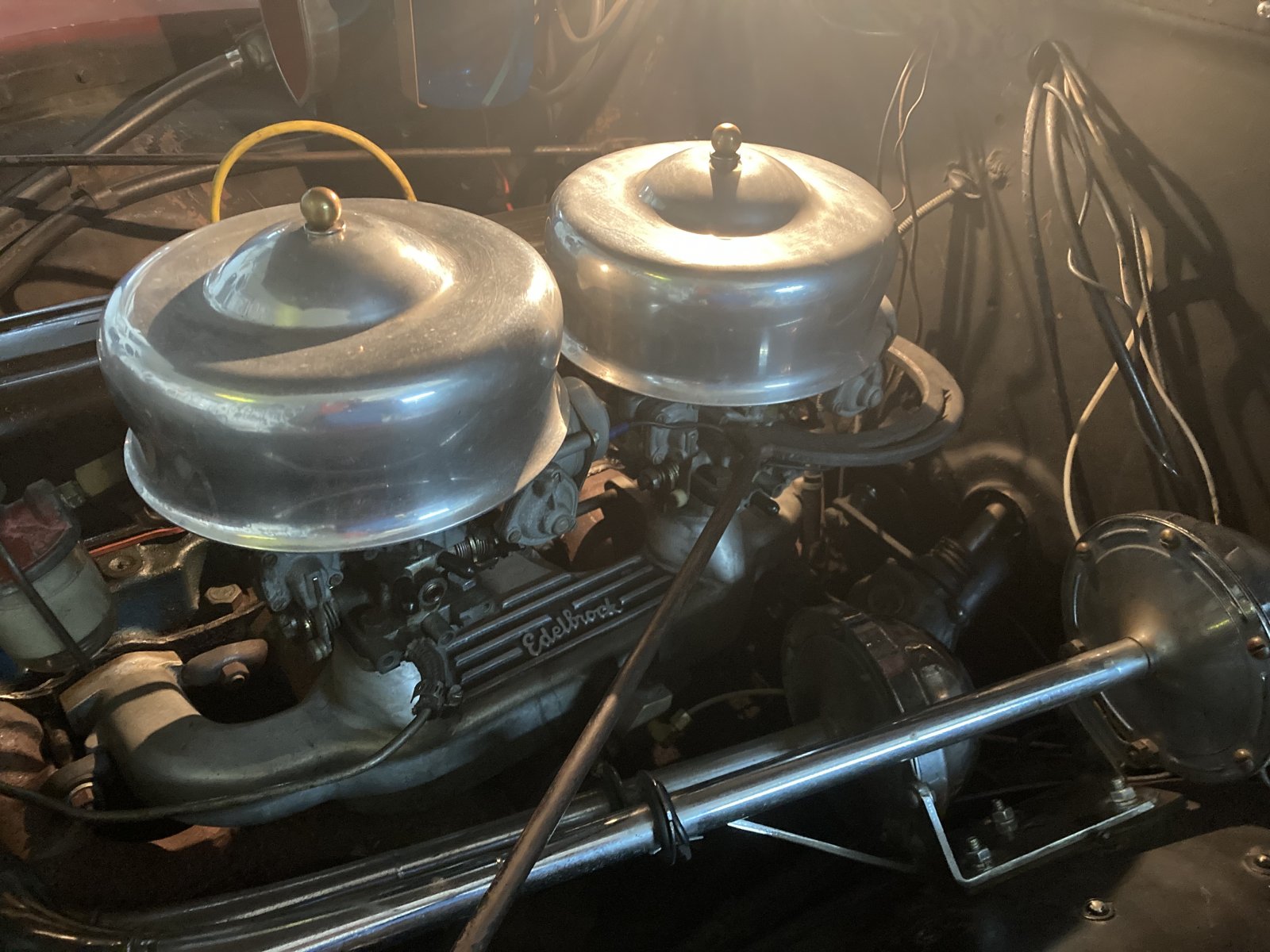

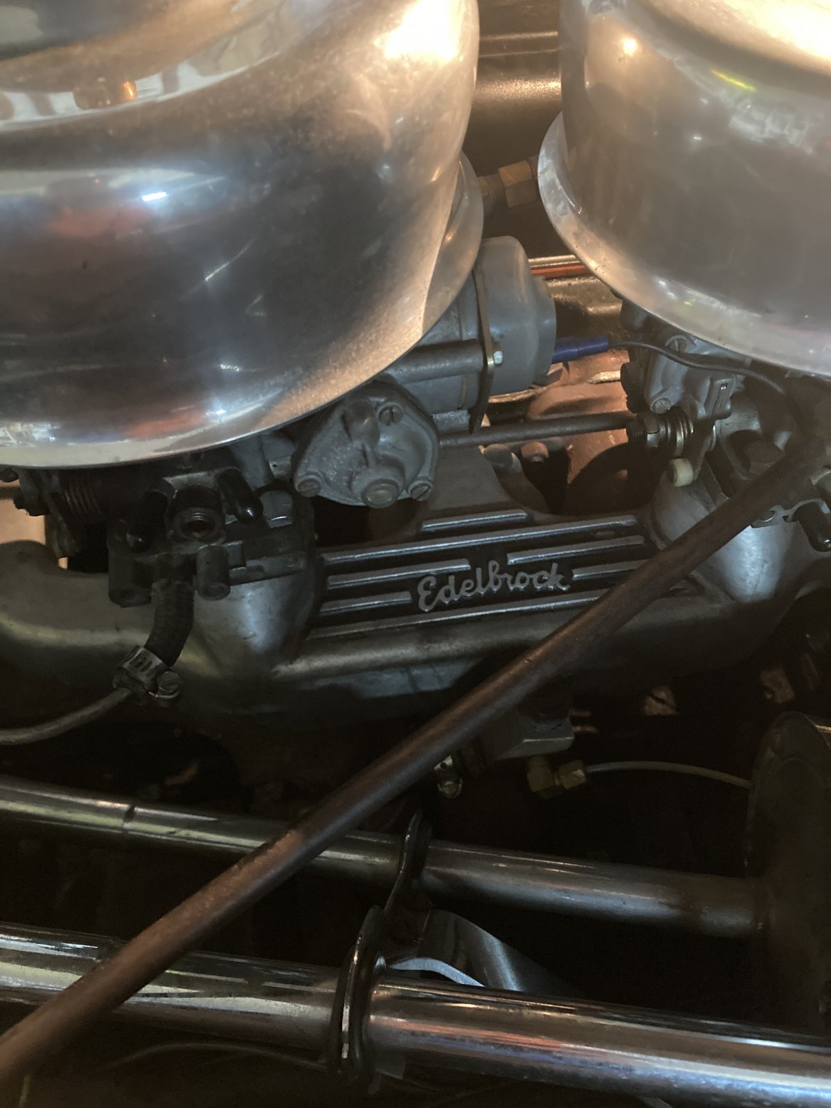

    Two of Langdon’s Carter-Weber’s on a 50’s Edelbrock. Buffalo Engineering fabbed on the 4 bolt plates. I think about 75k miles with this configuration, note the horse shoe I used to go around the carb.
