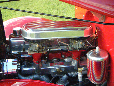

    I run a 261 with 2 5200 holleys, cam from patricks, fenton split exhaust and 2.8 electronic distributer. The distributer was worth 2 miles per gallon increase. I used Langdon's spacer for thermostat for water line and ran to intake and to return on heater. This kept my carbs from icing and better driveabilty.

    Nice! Do you have a photo of this setup? It sounds intriguing.

    in the photo you can see the lines below the logo the left runs to a plate behind the thermostat and the right goes to a homemade t in heater line
