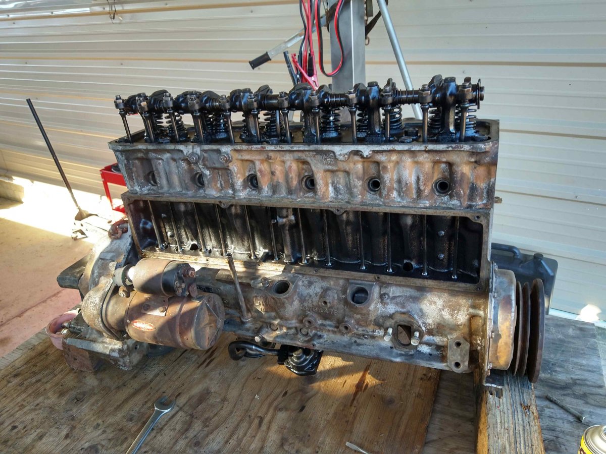

  1. I bought a 1950 Willys pickup. I know, the Willys site is elsewhere, but hang on. Turns out the motor is a 1959 Chevy 235. The seller claimed the engine was dead, but, I got it home and was able to get it running. I thought it ran great considering it had been sitting for years and I didn't even touch the carb. Now the truck is disassembled and the engine is out on the table (see pictures). I thought I better check the compression to confirm everything is as good as I think it is. Nope. #2 cylinder is 80psi wet. All the others are 125-130. I tested it a couple times with the same result.
    Question is: Do I have to rebuild this? I trying not to overspend, but, I will do what I need to for reliability. Any comments are appreciated. 235 compression.jpg 235-1.jpg Avatar.jpg

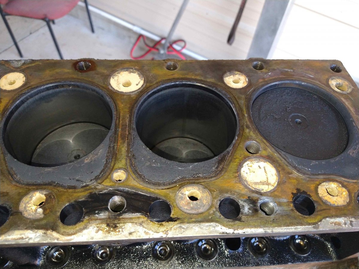

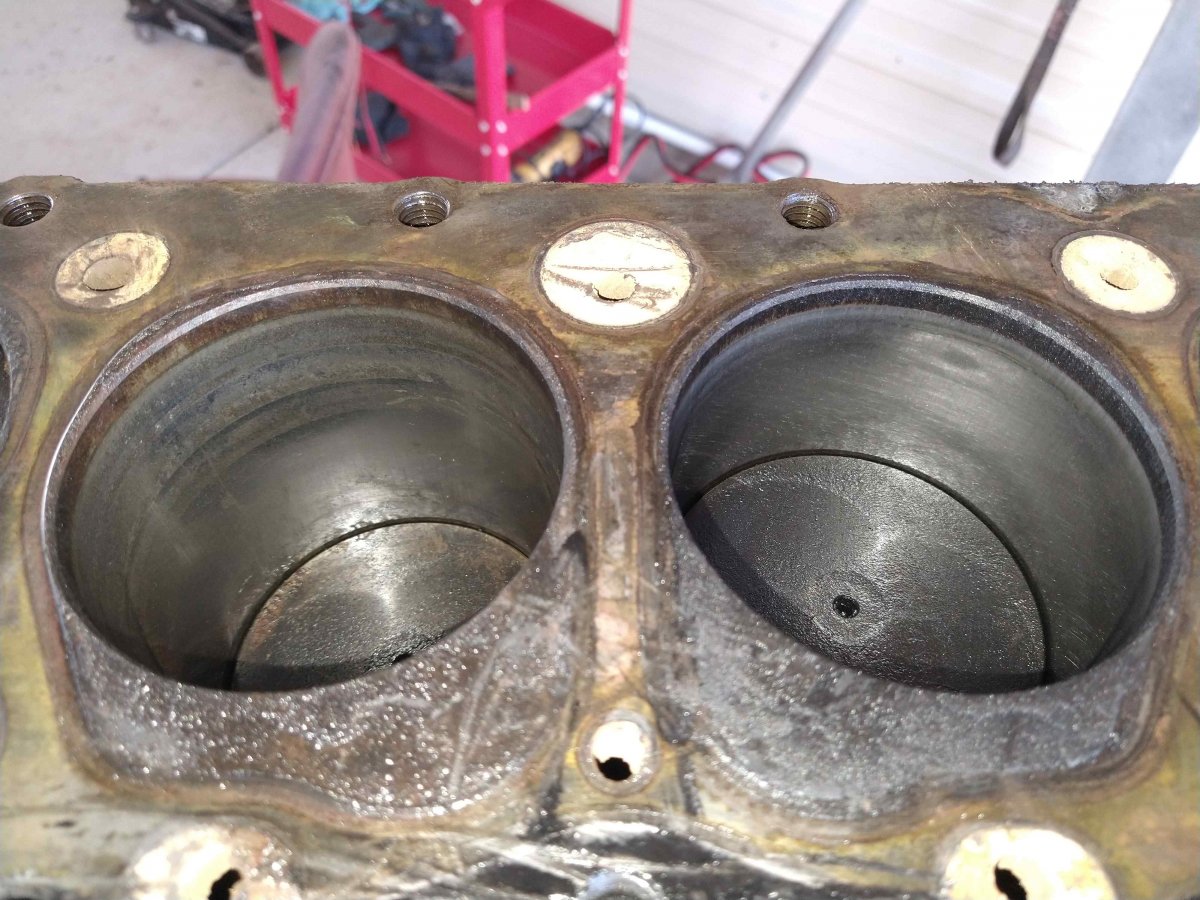

    Also, I turned the table around when I set the engine on the table. It's NUMBER 5 that had the low compression not 2.
    I noticed cylinder 5 was dull finish on the upper 2 ". The other cylinder were quite shiny. Almost mirrors.
    What do you think?

  22. OK
    The head is off and in the truck.
    $450 estimate to rebuild at one shop.

  25. squirrel
    Joined: Sep 23, 2004
    Posts: 59,227
    squirrel
    Don't jump the gun!
    My wild guess is the rings on #5 piston are stuck, or something. I'd pull it out and look at it before getting any head work done.

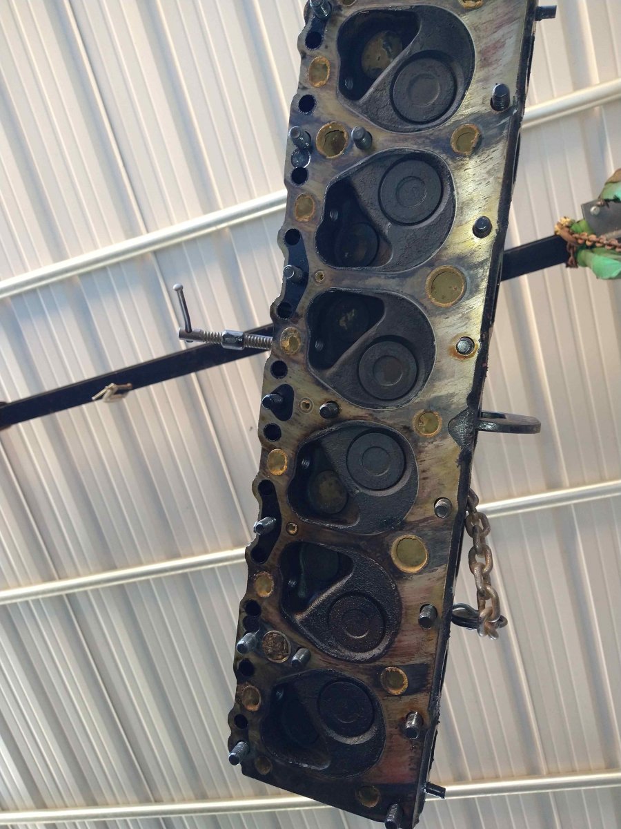

  27. getow
    Joined: May 9, 2016
    Posts: 305
    getow
    Squirrel. Look closer at the head. Its cracked.
  28. squirrel
    Posts: 59,227
    squirrel
    I can't see it. Maybe you could provide a bit more detail about where the head is cracked?
    perhaps copy the image, put a circle around the crack, post the modified image?
  29. getow
    Joined: May 9, 2016
    Posts: 305
    getow
    I dont know how todo all that. Look at head hanging, count 5 cylinders up. Between valves.
