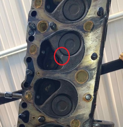

    this?
    It looks to me like some carbon got knocked off. It could be a crack....but I wouldn't jump to that conclusion, without a bunch more evidence..

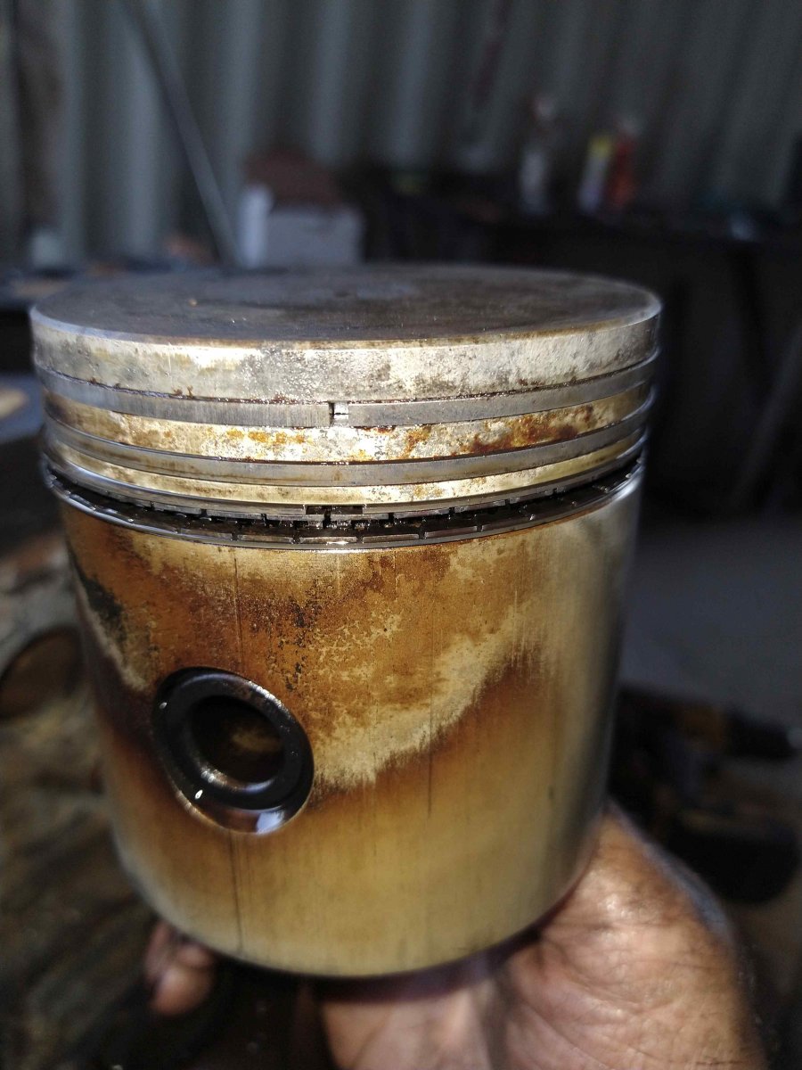

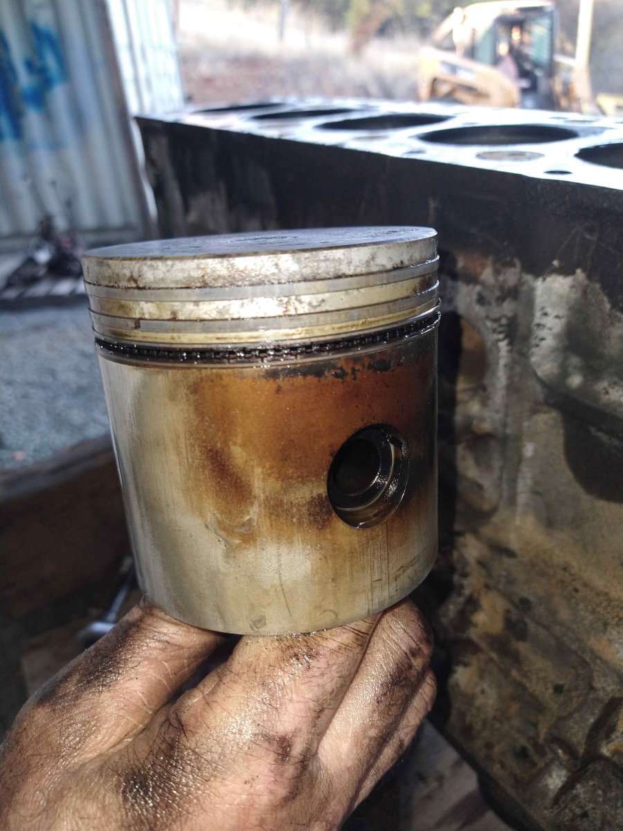

  3. OK
    #5 is out. I don't know what it should look like. And I didn't really want to pull #4 also to see a good one. Here's what it looks like. 1.jpg

    Yep that what i was taking about. Regardless, i wouldnt put $450 into that head cracked, or not. I think its a crack but pics are misleading at times.

    Get a pic tool and a magnifying glass. Check the head in the suspect area rigorously. Clean the area with carb or brake cleaner. The crack wont disappear if its real. Youll either find a crack or not. Update us with the findings.

  11. I'll check it in the morning.
    If it's cracked is it toast?

    Anything can be fixed. If thats cracked, it wont be worth it. So...yep. toast. But check, dont guess.

    The rings are stuck. You can free them up, and it will probably get some compression back, but if you take out all the pistons, hone the block, and put in new rings, it will get all of it's compression back. And last several tens of thousands of miles....the number depending mainly on how much taper is in the bores.
    If you want it perfect, of course you'll have to get it bored, new pistons, then you'll want t get the crank ground, new bearings, a reground cam and lifters, valve job including guides and seats and replacing the springs, and most of the valves because they have a tad over .001" wear on the stems...it never ends, till you get up to about $3-4k.
    belair, tractorguy, Budget36 and 2 others like this.
  15. You are right.
    The rings are frozen. That would explain the scoring in the cylinder wall.

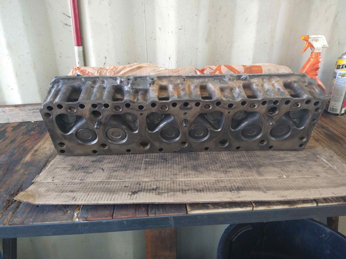

    I took another picture of the underside of the head. All of the valves look black except #5 which is brown.
    I'm still mulling over what to do with the head.
  16. This is the #5 piston top.
    .040 over I guess.

  18. 3.5625+.04=3.6025
    Mic says 3.600"
    Calipers account for the +- .002. No bore Mic in my budget garage.
    Johnny Gee likes this.

    I get rings from ebay for old engines like this....sometimes you can find the size you need, NORS, for $20...
    Yup, it's .040 over

  24. Thanks Tractorguy. I'm looking forward to driving it. I've attached a couple of pictures of the underside of the head after I've cleaned it. I could not find any cracks, but, the obvious pitting on the valve from sitting is water is concerning. I hope that the pitting was possibly the result of a previously blown head gasket that was left sitting for years. Although the head gasket I removed looked to be in good shape. But the .040 over rings on #5 were frozen.? Strange.

    I'd pull that one valve and look it and the seat over while it's apart.
