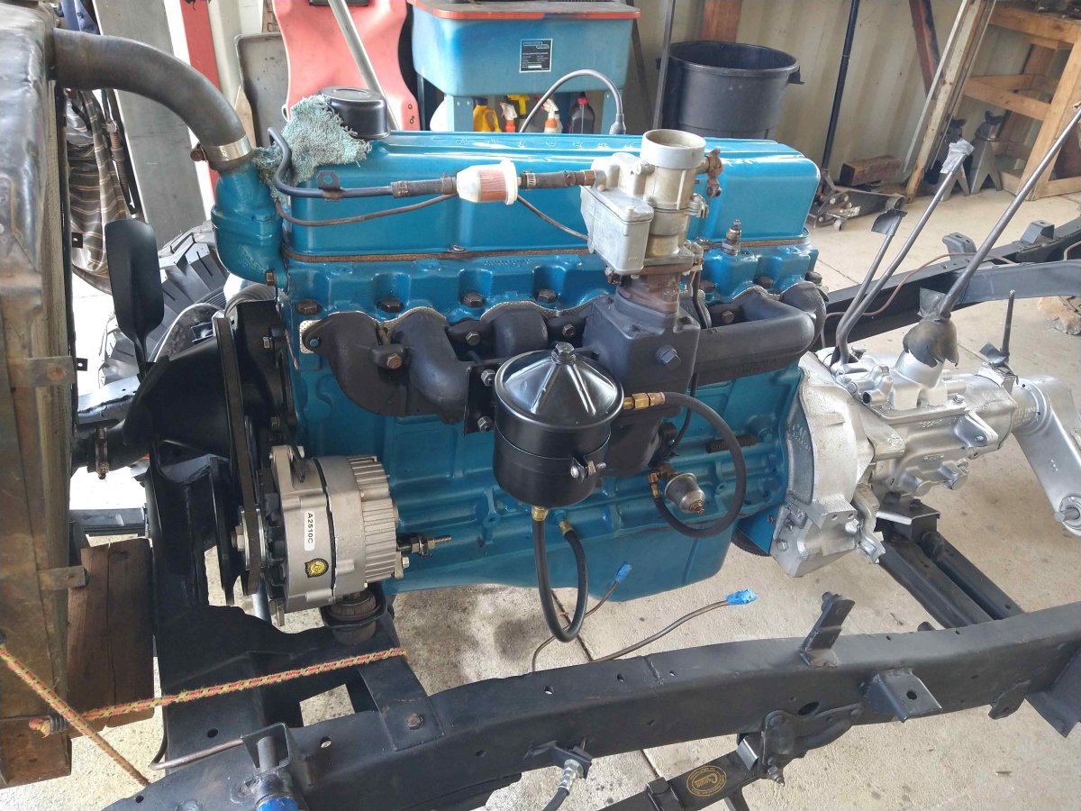

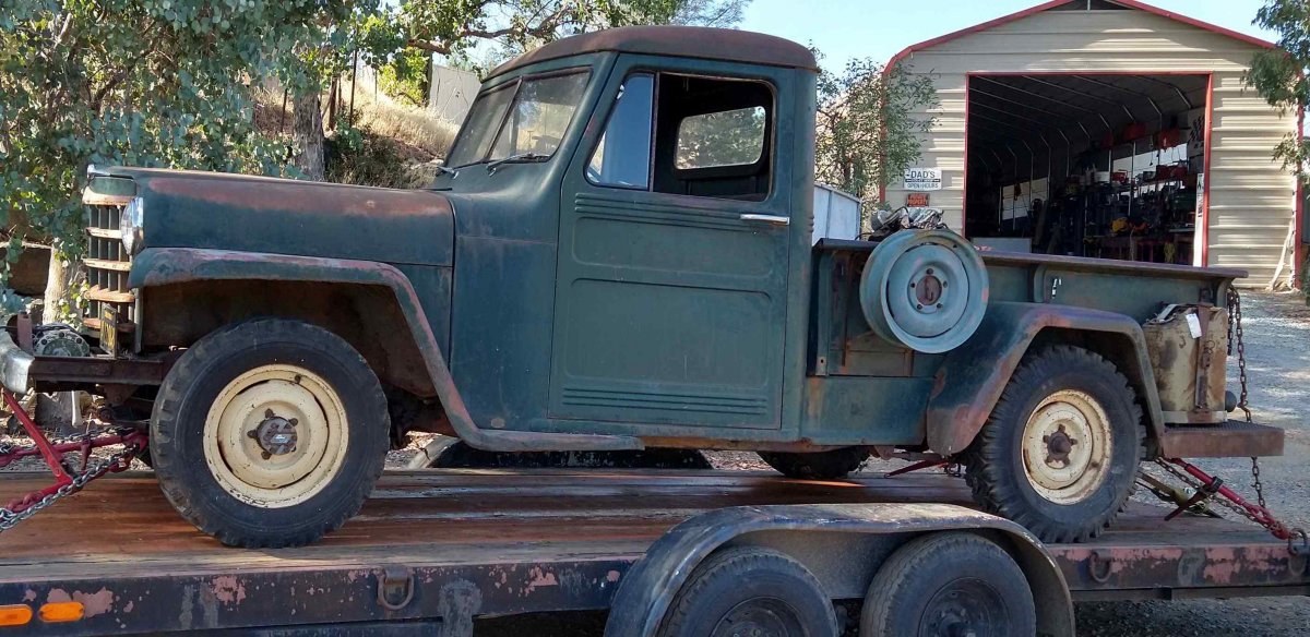

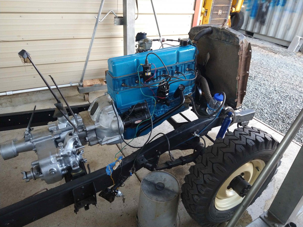

  3. I ended up just cleaning up all the carbon buildup and putting in the new rings, valve adjustment, rebuilding the carburetor, new water pump, cap, rotor, points, alternator. Now it's back together and runs good with strong compression on all 6.
    So, now I'm looking for a radiator. This is a 1959 235 but that radiator is kinda big for this Willys truck. I've seen Belair Radiators for the 235 that are a little smaller but would require me to make a couple brackets for mounting.
    Any comments or suggestions on a replacement? 2 core, 3 core? I've seem the aluminum ones on Ebay and Amazon for less than $150.
    BTW I'm looking for a radiator because the original has lots of leaks.

    Looks real clean! I like!
  5. Very clean looking conversion
    Ya did good.
    Radiator is just preference.
    That’s a light weight application. 2 core would probably work. But if a 3 core will fit the truck and budget, it won’t hurt.
    Having a radiator re-cored isn’t cheap these days.
    I have heard both good and bad on the e-bay aluminum ones.

    Glad to hear it is running well. So many guys scrap these little 235 workhorses because they only have 6 holes, but I think it is perfect for that Willys truck. I did a frame off rebuild (not really a restoration) on a 1948 CJ2A years ago and had a lot of fun dinking around with that old thing. Looking at the transmission and transfer case in your photos brought back old memories of all those stickshifts sticking up through the floorboards. Interested in seeing how your truck turns out!

    I see you did the allthread alternator swap on the stock generator bracket! Mine lasted 85 k miles before it broke. BTW, I have 115 k miles on my '56 235, with the 848 head, pulled 70 mph over the mountain pass on Monday and had her to 82, 83 mph as I made a mistake and had to hurry up and pass before my exit.
