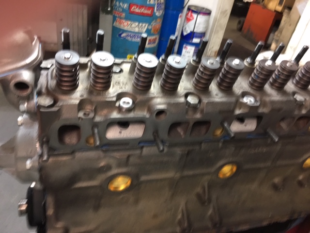

  2. I have never heard the term Lump Porting, but this is the post work done by @BnG Engine on my 261 BlueFlame 6.
    [​IMG][​IMG][​IMG][​IMG] [​IMG][​IMG]

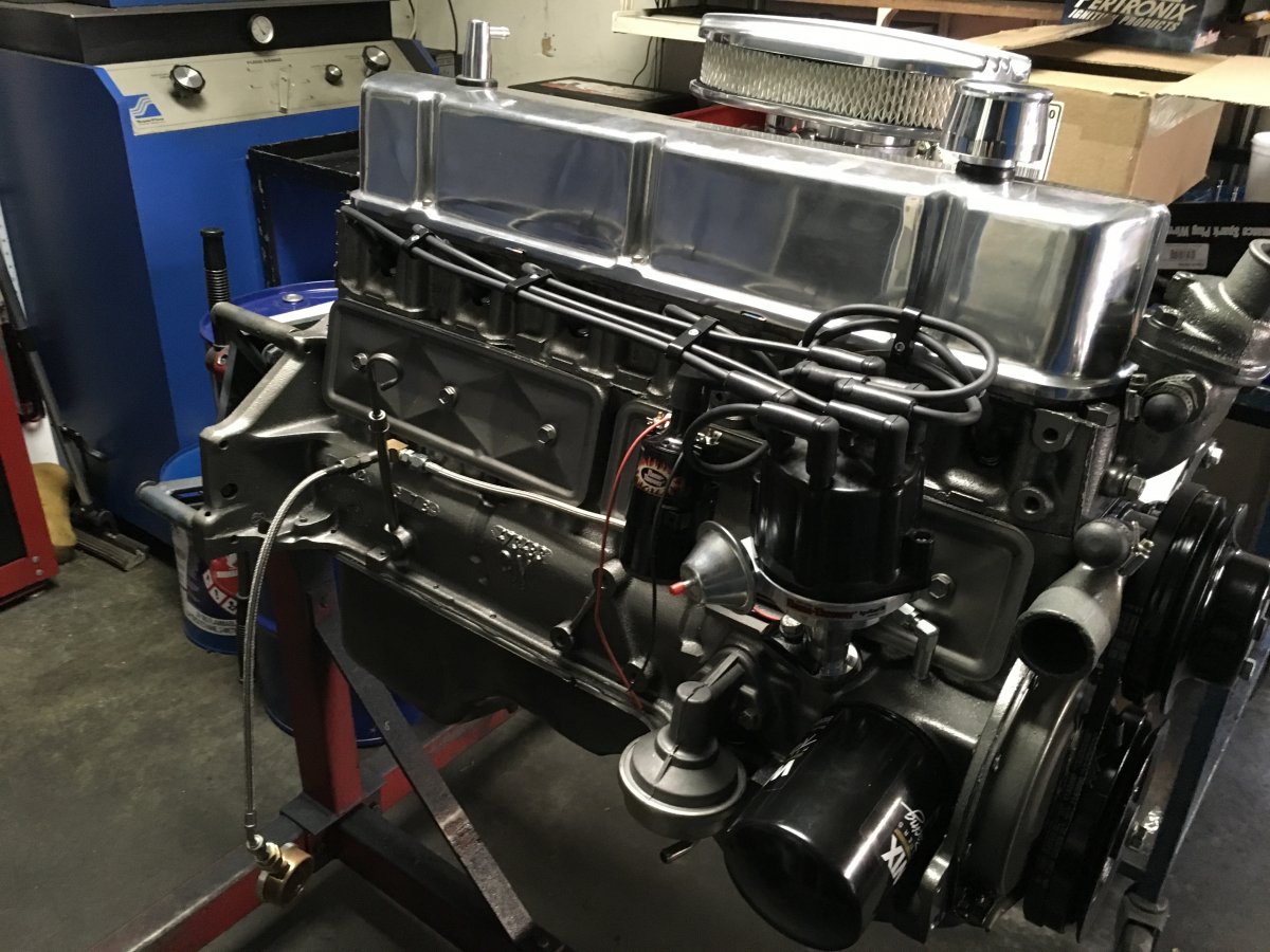

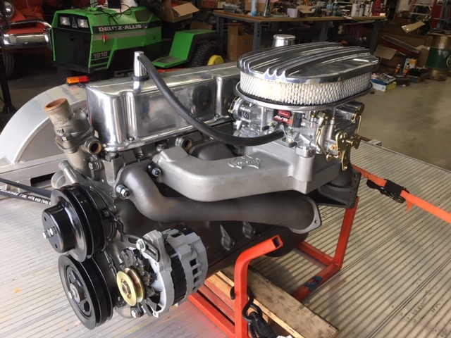

    Well Gentlemen, this is a timely thread. I wasn't going to post about my project, but this has caused me to reconsider. First, I completely agree with the unsuitability of the 216/235/261 engines being candidates for the 'lump port' mod.
    What I have chosen to do is build/have built a 250 Chevy six for my '37 Chevy Coupe. I had one on hand, along with a few 292's and a 230. For several reasons, I chose the 250. It is bored .060", flat top pistons (est. 9 to 1 comp), mild Sig Erson cam, an Aussiespeed 4 bbl manifold with 500 cfm Edelbrock AVS 2 carb, Pertronix distributor, 12bolt cast manifold/ headers (nee Langdon).....the head has been modified in accordance with Leo Santucci's "bible" on 194/230/250/292 Chevy sixes..... Lump Port mod, a bit larger valves, valve pocket enlargement, screw in rocker studs, full roller rockers and other minor mods.
    It was just fired up last Monday for run in and then some dyno pulls. I know what I hoped for, but did not know what to expect. Dyno data begins at 3000 rpm.....147 hp...rising quickly to 228 hp from 3000 to 5200 rpm. Torque was 256 at 3000, rising to 258 soon after and holding a flat line until about 4700 then dropping to low 250's at 5200. I was very pleased.
    Ray
    chevydriver, Mark Yac, XXL__ and 8 others like this.

    ‘Re my fresh 250 six cylinder Chevy.....here are some pics.......
    2CB8A30F-3AAA-4CA5-986B-A66E26A8BB61.jpeg 5D592823-6478-4473-ABD1-FC75452A463F.jpeg E6C8127A-28E4-483D-BBE3-6E0631149ABF.jpeg F9D4AE44-EB9D-4388-AA85-AD011B8ED316.jpeg A7E5A656-A36C-49AE-B8C8-8F12D2BC75AD.jpeg 4C6E17CB-1016-4A31-A933-7CD041E1BBCC.jpeg
    I am really inclined to put an aluminum case Powerglide behind this as they are small case and light weight and low parasite drag internally. My ‘37 Chevy Coupe theme is ‘simple and light’......if PG, thinking I will use 3.27 diff.....maybe 3.55.....With the combination of engine torque and torque converter multiplication, I think the PG would work well for street use, which is all I have in mind.
    I do have TH350 and TH2004R on hand in case I am mistaken about that.....:D
    Ray

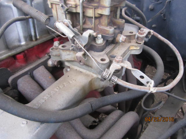

  16. The 250 I had in the 66 GMC short bed I sold last December was backed by a aluminum powerglide. I had 342 rear gears. it worked out fine. I used a HEI and had a holley 390 carb. the holley needed a kit. and I adapred a Rochester 2 bbl to the intake. When I decided to sell the truck I removed the intake and hedders and installed a stock I bbl intake. chevy stuff 032.JPG chevy stuff 033.JPG
    6inarow and Belair235 like this.
