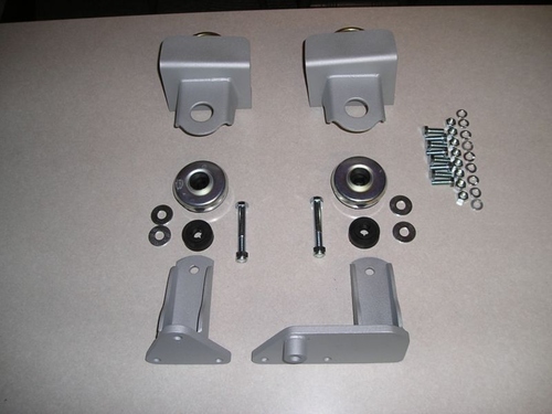

    Does any one know if this style mount will work for the mid style motor mount? it's a kit from langdons stovebolt?
  18. usmile4
    Joined: Jul 28, 2005
    Posts: 690
    usmile4
    Just give Tom Langdon a call. He is good to pick his brain and he can tell you what you need to do.
