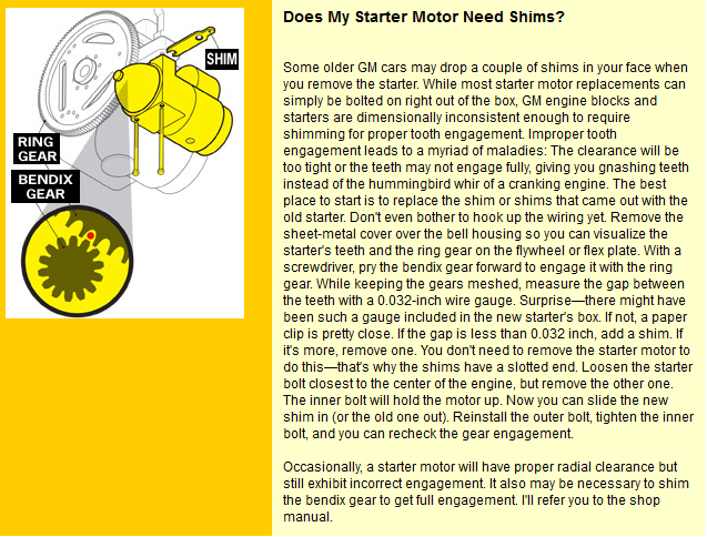

    One of my local friends suggested that I may need to shim the starter for proper engagement. Does anyone have any advice on that or process?

    This type starter wasn't designed to take shims. Just in case you do have the 1955 flywheel and you go ahead with the 12v conversion the starter number for the 12v 1955 starter is 1107634 or rebuilt number 3599.

    startshimsx.png I have seen where the after market casting on the stater needed machine work because it was too far away, paper clip is about the right thickness as far as using for a gauge , went through starters and 2 fly wheels finally bought new starter and fly wheel no more problems ,I know it a pain in the**** to check but a necessary effort in the long run

    On your truck, the starter should bolt up to the bellhousing.
