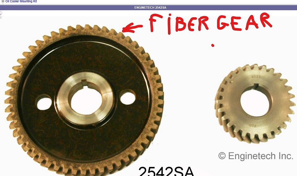

    I don't know much about these engines but do they use the fibre cam gear that likes to shear off and stop the cam from turning?
    No_Conversati0n and jimmy six like this.

    Come to think of it, you want to make sure that the rotor is turning when you crank the engine as the fiber timing gear Crank the engine over and make sure that the rotor is turning smoothly. Those fiber gears get old and loose teeth.

    If you need to replace a fiber cam gear you can go to the truck side of the parts book and get an aluminum one.
    No_Conversati0n likes this.

    Ha Ha.....Had the same problem once.............Sheared cam gear........ BUT, the distributor still turned....... A real PIA!
