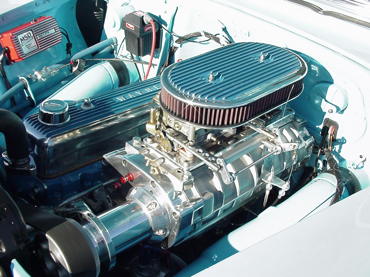

    Not at all pissed here. Running a stock-internals 292 (Edelbrock 4bbl, Offy intake, Langdon's cast manifolds, HEI) in my Biscayne and have been thinking about other potential changes. I have a lump port head with 1.94I/1.6E valves...but I know damn well in order to really take advantage of the head, I need a cam, better compression, different pistons, etc. Of course, the moment I get all that done, then the 3 speed is probably gonna need to get chucked, too.... ;)
  5. About the only way to get air into one that is breathing impaired is to boost it. Well to get a reasonable amount of air at a reasonable cost.
    So tell us about the blown motors. How much boost? Stock internals?
    You are running the blowers full time? Reason I ask is in the '80s there was a company making blower kits they called the road warrior for inline engines. The had a clutch on the blower drive and would run with or without the blower spinning.
